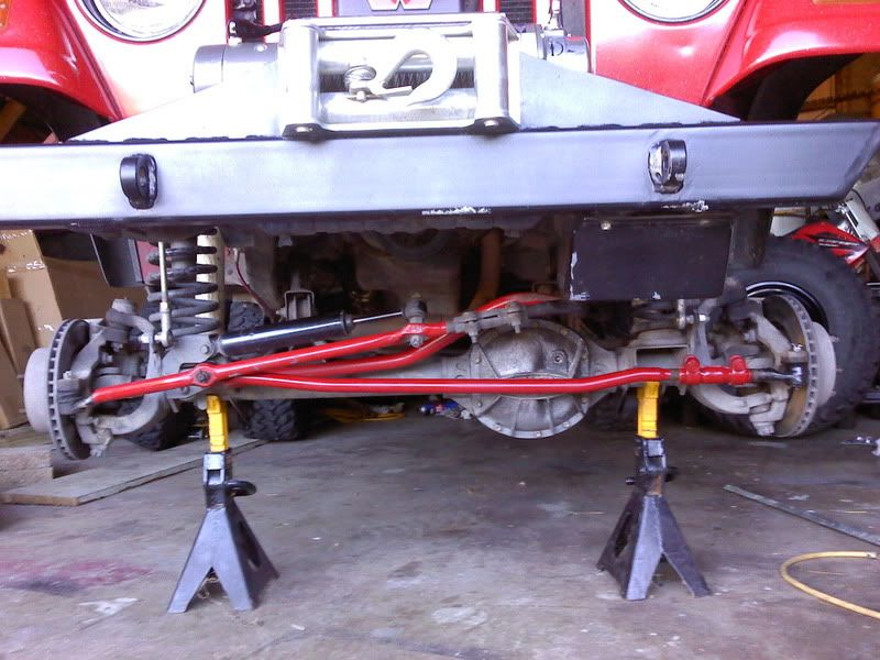

Well, came back home from school this weekend and had enough time this evening to install the ZJ tie rod and set the toe again. I painted it a couple weeks ago to match the rest of my steering.
A level clamped to each rotor is how I set my toe. Anything that has a true straight edge will work. Mark them for the size of tire (33" in my case) so you have a consistent spot to measure from. Set to have an 1/8" of toe in
And a finished pic. Sorry it's a bit dark and was also taken with my cell. With the bends in the ZJ bar you lose a marginal amount of clearance over the straight stock tie rod. However, the solid steel bar is a heck of a lot stronger then the thin, hollow stock tube lol
