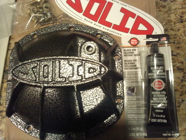

Got my cover for the D30. Thinking about painting the letters in the middle red
Solid diff covers are a heck of deal IMO. Cover, new hardware, RTV gasket maker, and stickers all shipped to my door for $80. Pretty good deal as long as they hold up. I'll get it put on in the next couple days.

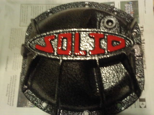

Painted the letters on my diff cover and also got it installed. It got too dark to get a good pic of the cover on the jeep so I'll try and get one tomorrow. I think it looks good though
Helped my friend install the same cover on the HPD30 in his XJ as well

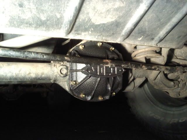

Here is an installed pic of mine in the daylight. Best part about this cover is the fill plug is higher and allows you to slightly overfill the diff (i still only filled to about an inch below the fill hole because i din't want too much). Doing so has made my once noisy Aussie locker almost silent now. I can barely here it ratchet at all. I think it has to do with having the locker more submerged in fluid where before the fill hole only allowed you to fill it up to just the bottom of the carrier. I also tried a little heavier weight gear oil since i heard that helps quite the aussie down as well. Overall a big thumbs up for my Solid diff cover

Did you use 85-140 gear oil? That's what I used up front and my aussie is still pretty noisy. Maybe that's an excuse to get an aftermarket diff cover and overfill it a bit

Yes I did 85w-140 and I put about 2 quarts in. I did a few u-turns and couldn't get the bad shaking and ratcheting I'v felt sometimes before. However it didn't always do it before now either so i won't know for sure if it solved that problem until i get some more miles on the street. My aussie was pretty noisy before but driving around the block to test drive it today i couldn't really hear it.
