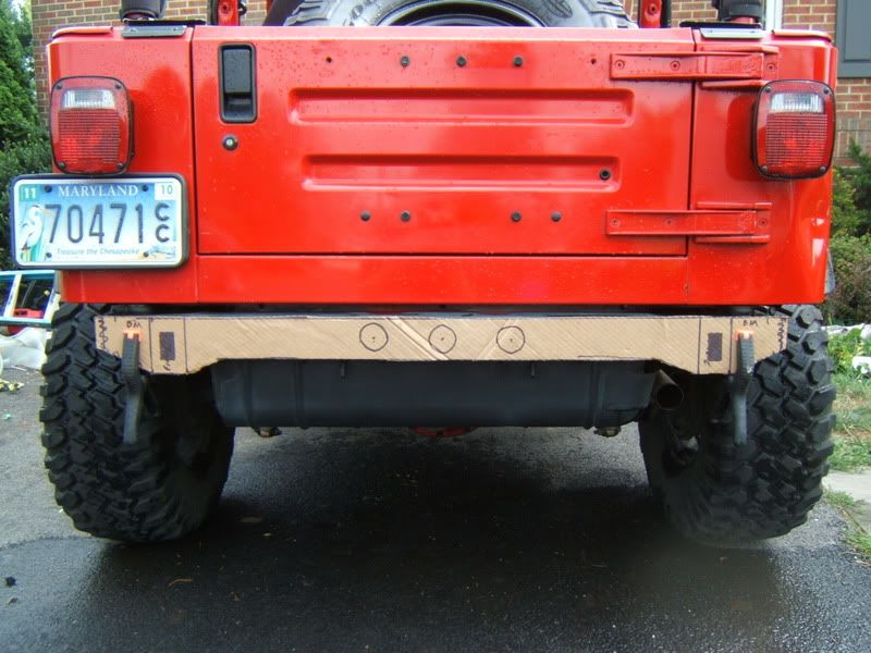

Started working on the rear crossmember today. So far I just have a bunch of measurements and the first few cuts on the main piece of tube.
I started with a big piece of cardboard and started mocking up a little pattern to get an idea of the width and angles I wanted to use. Came up with this, the circles in the middle are going to be 2" 3 diode LED marker lights
Then I cut down the 6' tube I have to 51" which is about 2" wider than the stock crossmember. about 1" wider on either side
Got all the measurements and lines drawn out on all sides of the tube for the recovery points and were i have to cut out half the center of the tube for the gas tank skid mount. Then I cut the ends and that's were I'll leave it for today. I still need to burn all the gas in my jeep so the tank is empty. I don't wanna wrestle a full tank of gas when I go to drop the tank

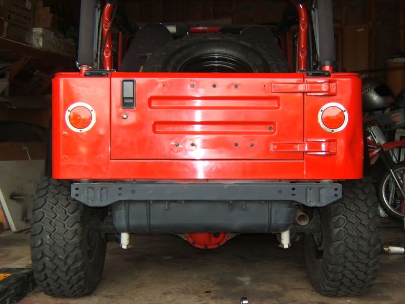

Did some more work on my crossmember today. It's starting to take shape now. I still need to burn some gas in the jeep so i can drop the tank and work on the dimensions for the gas tank skid mount. And I gotta cut off the existing crossmember and start mocking this one up in place.
Cut out the holes for the recovery tabs and cut the bottom 1/4 of the rectangular tubing where the gas tank skid mounts. It was long and tiring work with the angle grinder but i got it done. Sure wish i had a plasma setup for cutting steel.
Wallah! All cut and shaped. Pretty happy with how straight i was able to cut that long line down the tube. Wasn't at all easy
Burned the shackle mounts in on the backside. Still havn't run a bead on the front yet but will
And here it is clamped up in place over top of the existing crossmember. Looks good to me. Should look sweet with the LED lights i'm putting in it also
