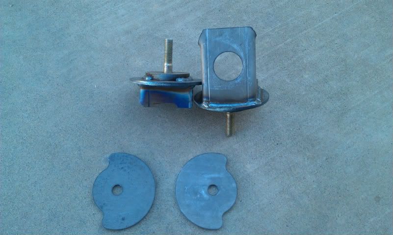

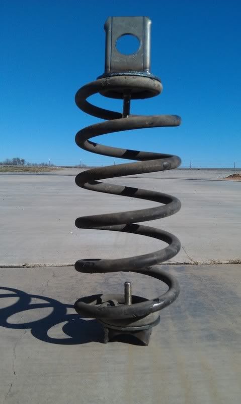

Looking at it I wasn't sure how well they would work together. The BTF mounts incorporate a coil spring retainer and the currie bump stops also incorporate a spring retainer. Will you just bolt the currie bumps to the bolt on the perches instead of using the supplied retainer plates in the BTF kit?
I burrowed these pics from your build. Hope you don't mind. I guess I'll have to see how you do it.

I don't see why you couldn't just slap the retainer on and then the bumpstops and snug everything up together. Makes sense in my head anyway, but it is past my bedtime.
The one issue I've noticed so far is that the bolt that is welded to the BTF perches is larger in diameter than the holes in the Currie bumps, so they'll have to be opened up a little to slide over the bolt.
