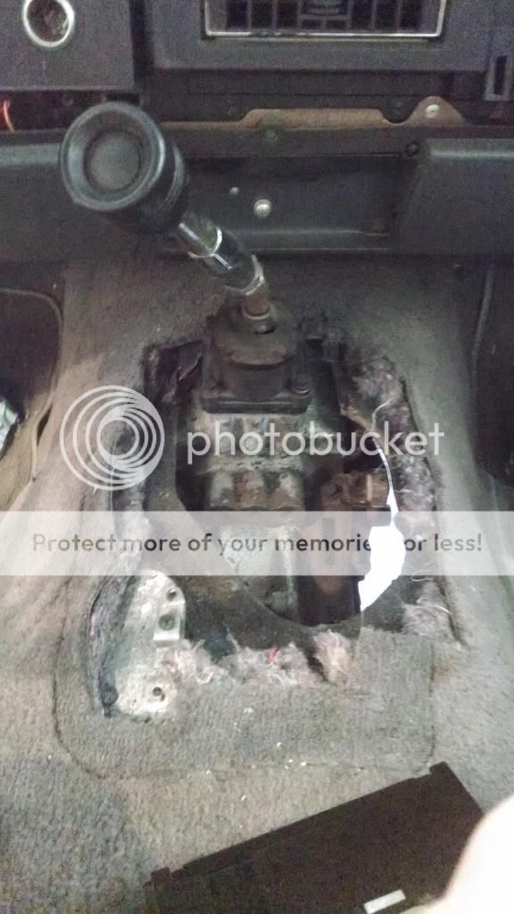

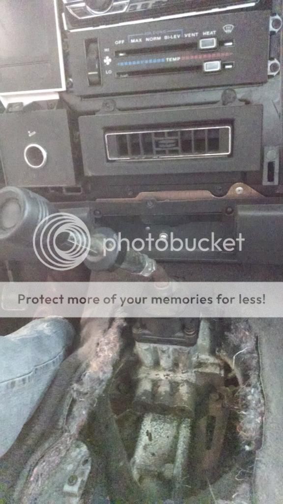

Update time. Engine trans and tcase are set in. Iv got the floor cut just enough to fit the shifter. The trans mount goes up in the factory location. First and fifth hit the dash just a bit but I'll be bending and extending the shifter soon. I started cutting the hood open to clear the intake. I haven't decided what to do to cover it. If I even will.

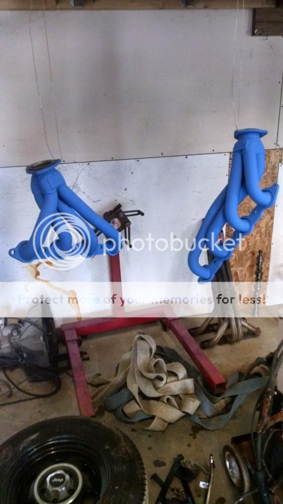

update time. Headers came in after I called and chewed someone out. They missed my order or something. I'm not overly happy with the quality either. Anyway, I got them painted. I got my front frame plates installed and welded up. This took far longer than I thought it would. This week I'm hoping to get the floor patched up and plate more of the frame and start on the 4 link. I also have started to think about running coilovers up front. Any help on that would be awesome. And here's some eye candy.
