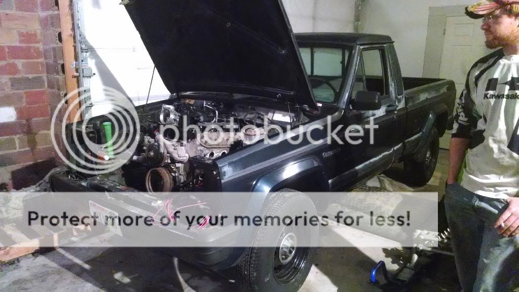

post #25 of 65 Old 02-22-2014, 10:54 PM Thread Starter
mckoolkid
Posts: 328
Well I test fit the engine tonight. Tried first with the trans on it but had to set just the engine in itself. The motor mounts seem to be perfect. And I'm going to need a large cowl hood. Haha also the trans shift tower seems to be way to close to the dash. Might have to re-think the transmission decisions.

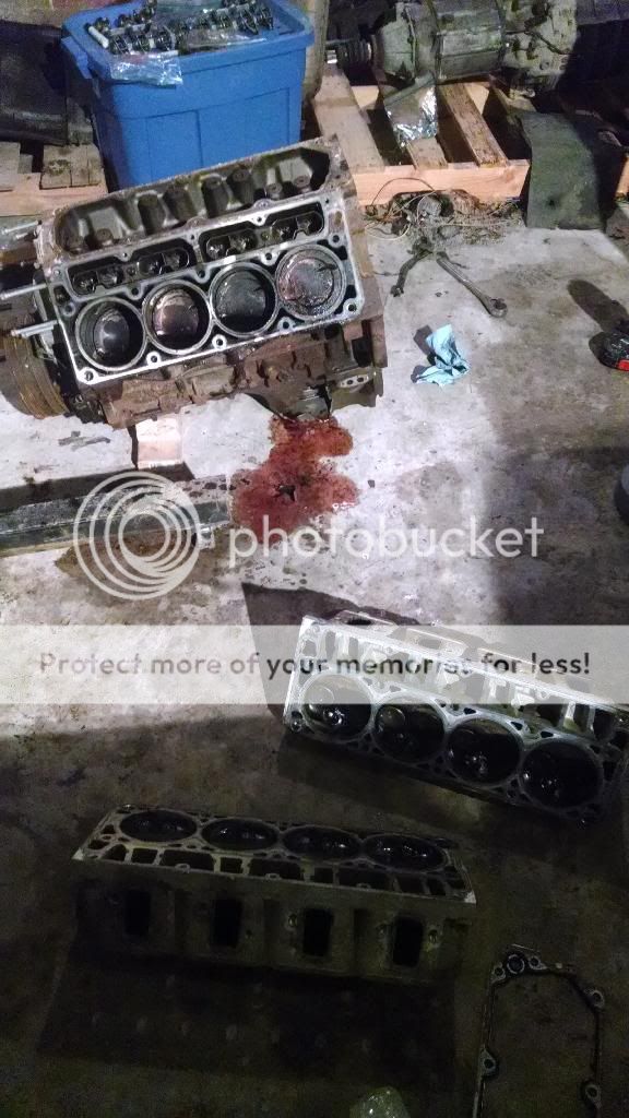

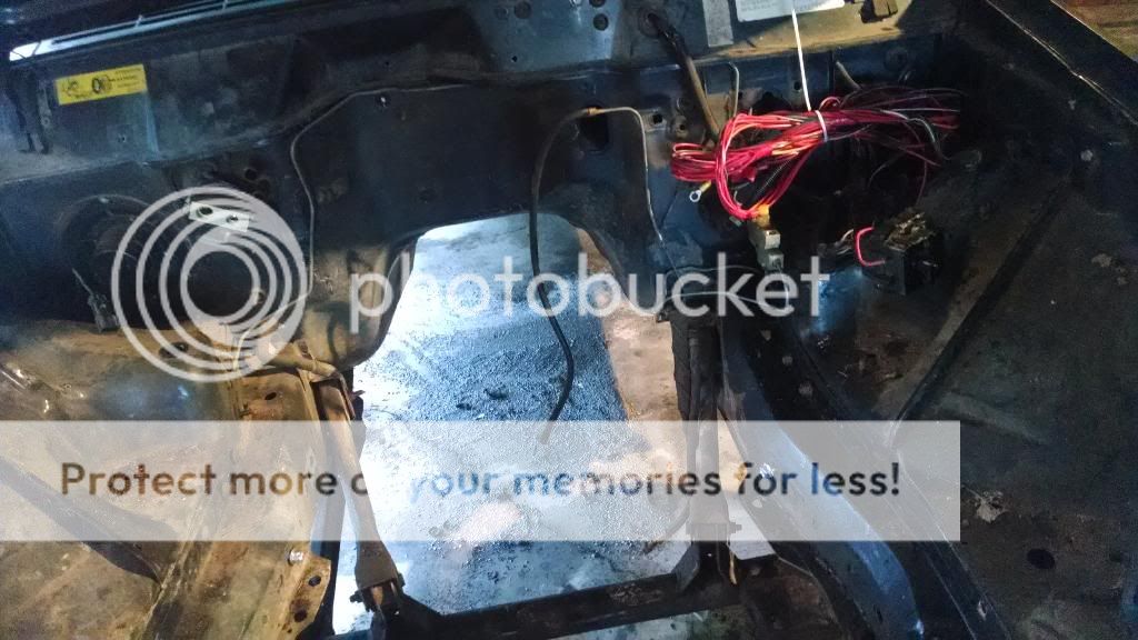

post #29 of 65 Old 03-30-2014, 10:45 PM Thread Starter
mckoolkid
Posts: 328
I'll probably just make a hood scoop for the truck intake to save money. Took the heads off to send them in. Cam will be ordered this week. Iv got a complete harness/ecm. Ordered frame plates and 1.75 coil spacers. Finished cleaning out the engine bay. Found a t5 s10 trans to run for now. So i just need gaskets for the engine and it's almost a running drive train. The engine bay should be cleaned and painted next weekend
