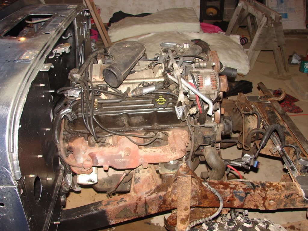

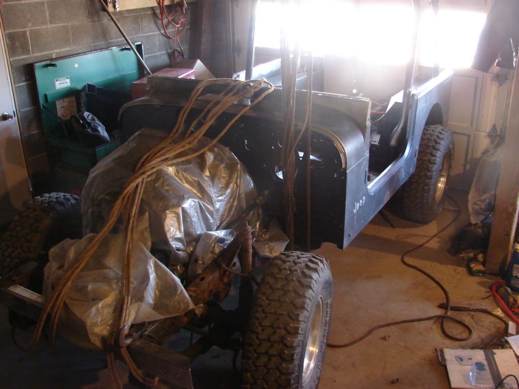

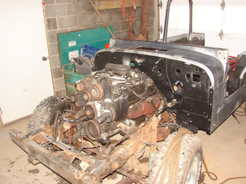

here's a couple i took after getting her back home.
and the unveiling...
after taking this pic i realized i forgot to cut the old motor mount off this side! looks like a job for the angle grinder.
i think it fits in there great. i had to move it a couple inches towards the passengers side to allow clearance for the steering shaft around the header. i will need to go to block huggers no doubt but that's another day.

That thing was a 93 zj right? If it was early 93 you can sell those manifolds to the zj guys as a performance upgrade. The dodge and jeep manifolds are different. I threw away a couple sets of each last spring.

i need a set of manifolds that are either center dump or a new drivers side manifold that doesn't point straight down. i have gobs of room for the stock manifold, the drivers side is just pointing directly at the new starter position.

The dodge drivers side exits the back side of the log. Points almost straight at your fire wall.
I have some dodge long tube headers that might actually work for you.
