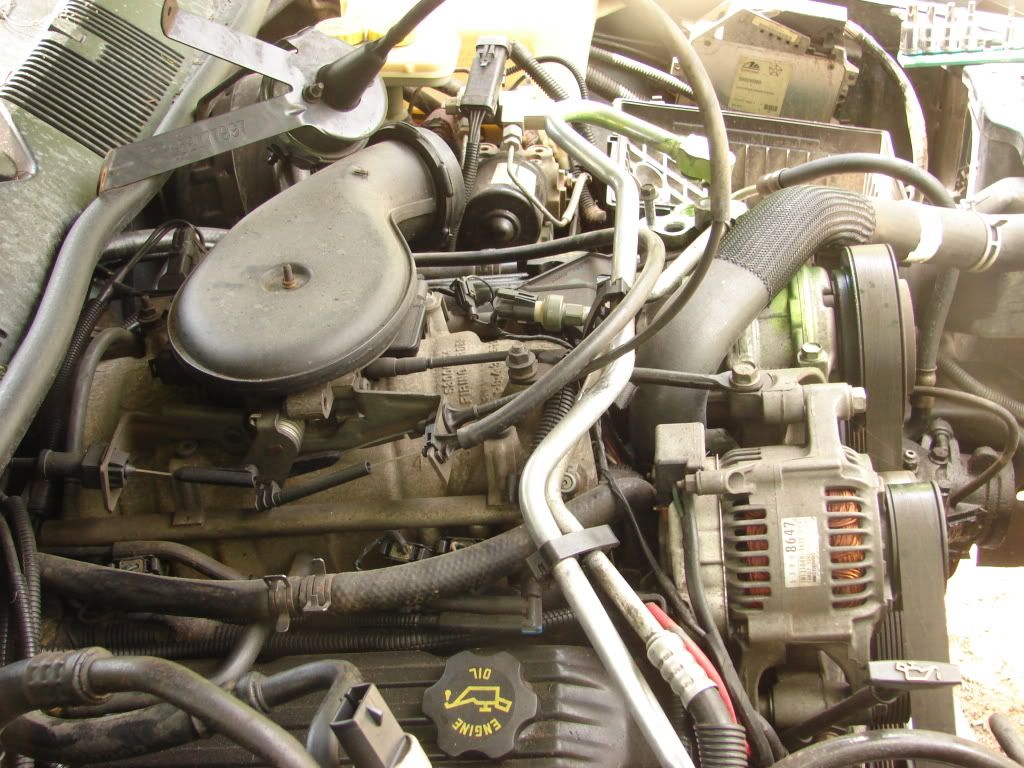

here's a couple pics of the motor i got from the zj
all the plating cut out. the smaller pieces will be the new lifted body mounting outriggers. i will get approx 1" of body lift over stick without the need for actually having a body lift installed. the husky clevis mounts will go on the rear bumper.
pic of drivers side plated. pass side is the same plates. the underside plates aren't in the pic, they were made as i went from scrap i had laying around.

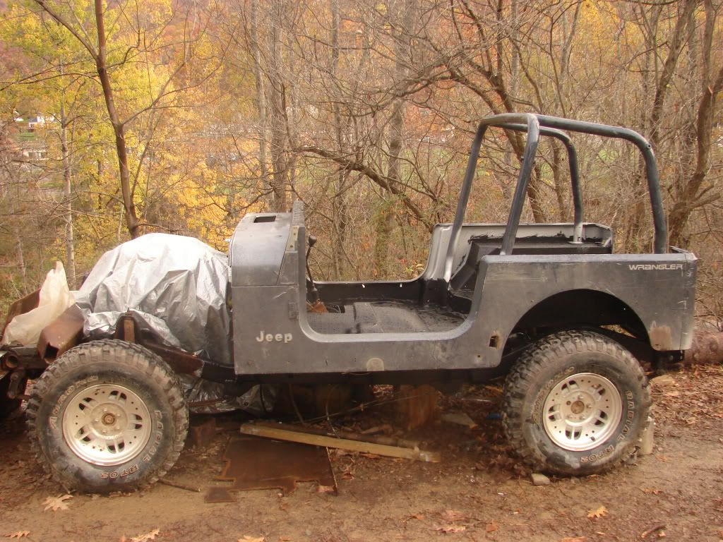

here's a few pics i got a chance to snap friday.
inside of tub primered silver aluminum and first coat of bed liner over that.
here is the body just resting on the frame. i know it looks crooked, there is no body mounting hardware installed, it is sitting on a few wood shims.
as it looks with 31x10.50x15's on from the side. i think i will easily be able throw 33's under there after the body mounting hardware is in there. after a small suspension lift and a subtle fender trim 35's will go in easy.
pic of the flat underbelly skid. i got it bolted on today, however, it was too dark to take any more pics by the time it was bolted in place.
progress will be slow (i know my progress is always slow) until i get my daystar 1" body mount kit. i know they are only 150 bux but, it's still 150 bux. i will be getting custom made stainless sleeves, washers, bolts, and nuts made for the body mounts.
