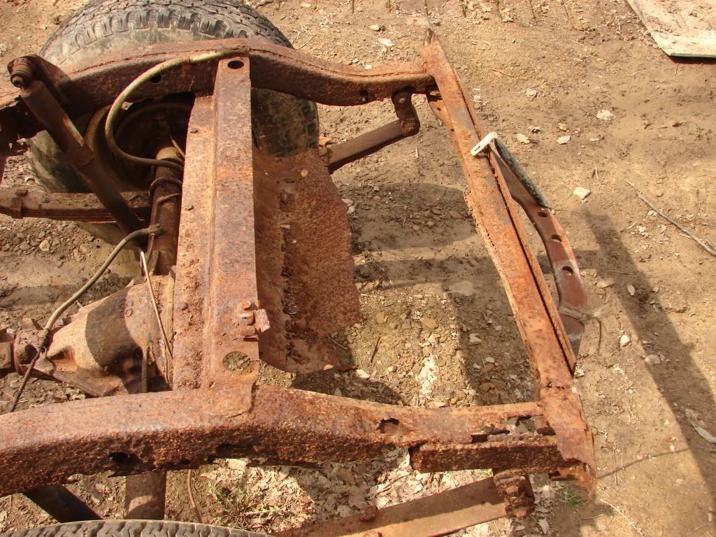

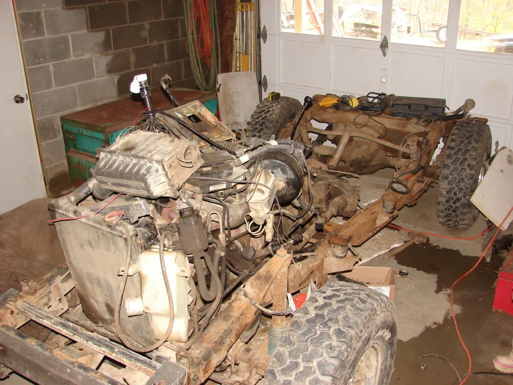

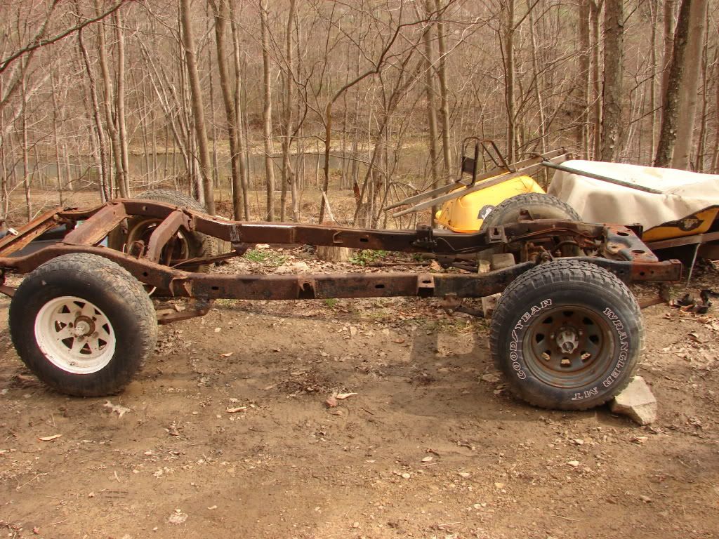

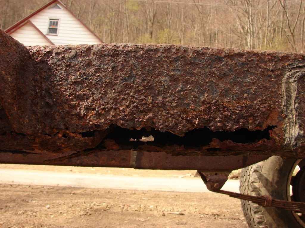

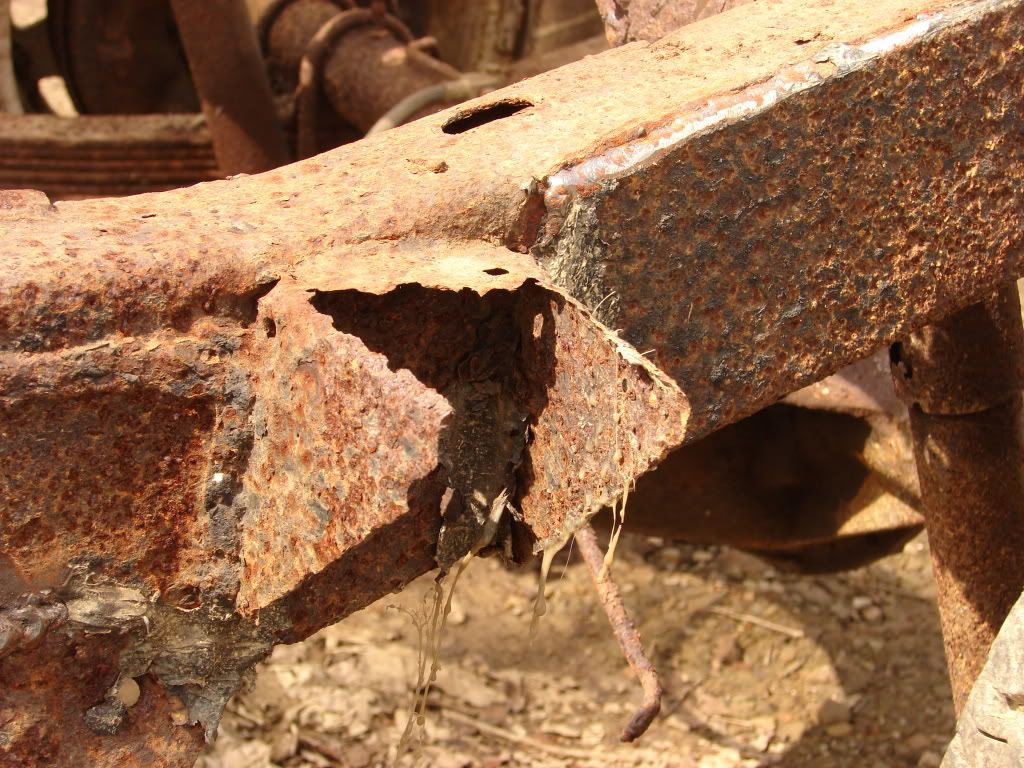

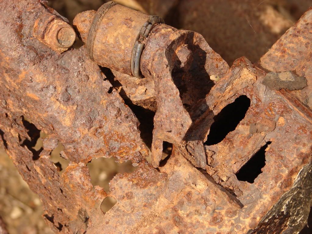

well here's the deconstruction of that cj i have pics of earlier in the thread. not bad at all for a place to start.
here's where most all the work needs done.
the back 2 body mounting outriggers look like this.
and these are the only spots of the entire rest of the frame that needs repair.
it looks rougher than it actually is. the metal is still very thick on the rest of the frame and may get boxed in i haven't decided yet on that one. it really doesn't need it but since i am putting in a 300+hp motor (i decided to use a 305 i built many years ago for a hot rod Monte Carlo with the intake, injection, wiring, and computer from the k-series 350 i mentioned in the op) i might need to add a cross-member up front or maybe a few ladders but nothing major since these same frames had 304's in them in some of the cj's. none however were sporting that kind of power.

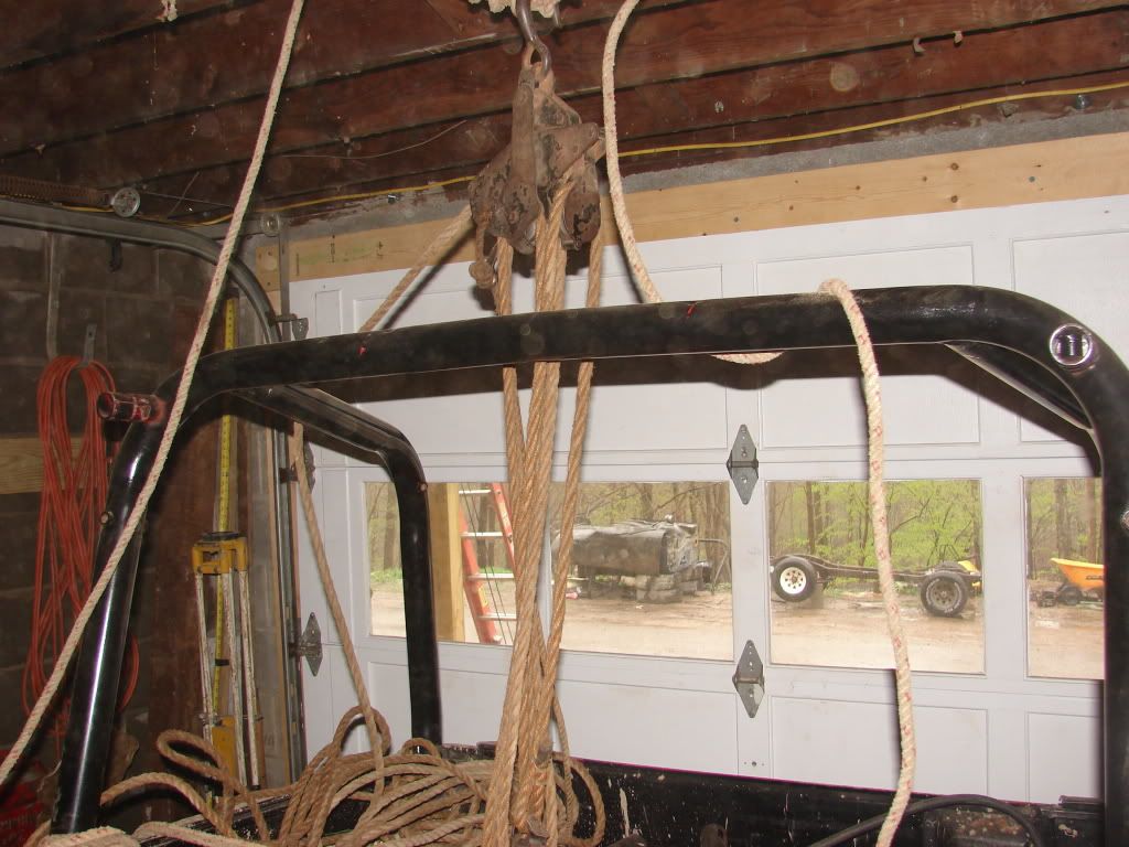

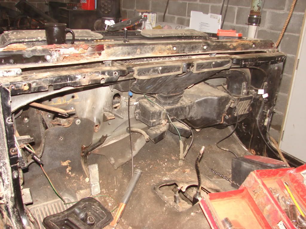

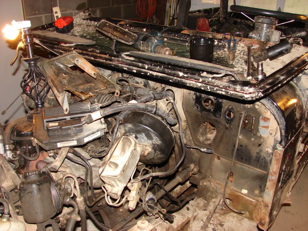

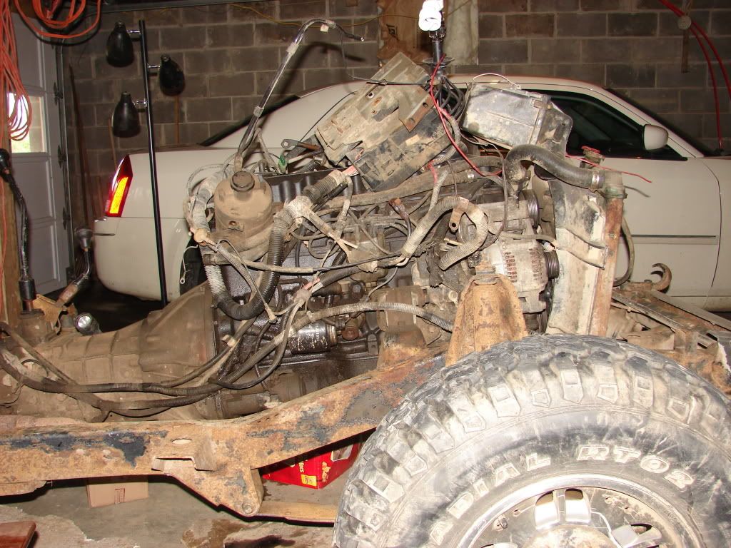

fenders, hood and grille off.
firewall all cleared of wiring and hoses. i just draped all the wiring and such over the motor. had to be careful of the brakelines from the master cylinder. used other wiring to keep it in place so as not to fall over and kink/break the hardlines.

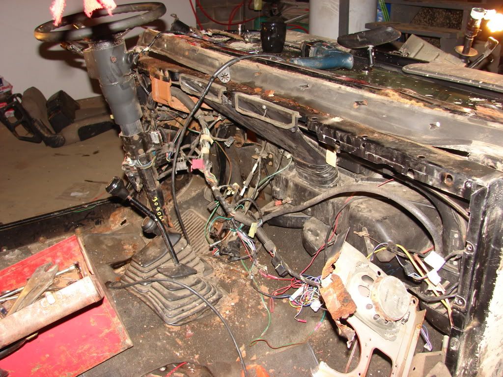

after the dash plate was removed.
here's one after wiring and such were taken out. i always try my best to remove any wiring without cutting anything. it is a pain in the tookis but it is worth it in the end. i also take pictures of each and every plug before i disconnect it. then label the pic on my comp of where it is. alot easier than writing on a piece of tape on each side of the plugs. the tape can get tore off, greased up, whatever.
here is one of the method by which the tub was pulled up off the frame. that block and tackle was govt surplus my grandpa bought after coming home from the pacific in 1946. it still serves it's usefulness to this day. they just don't make stuff like they used to. second one is blocking between frame and body. i still need to unhook the gas fill tube and e-brake cable. but since we will need to carry the body out of my basement manually i wanted some space under there for reassurance it is totally disconnected.

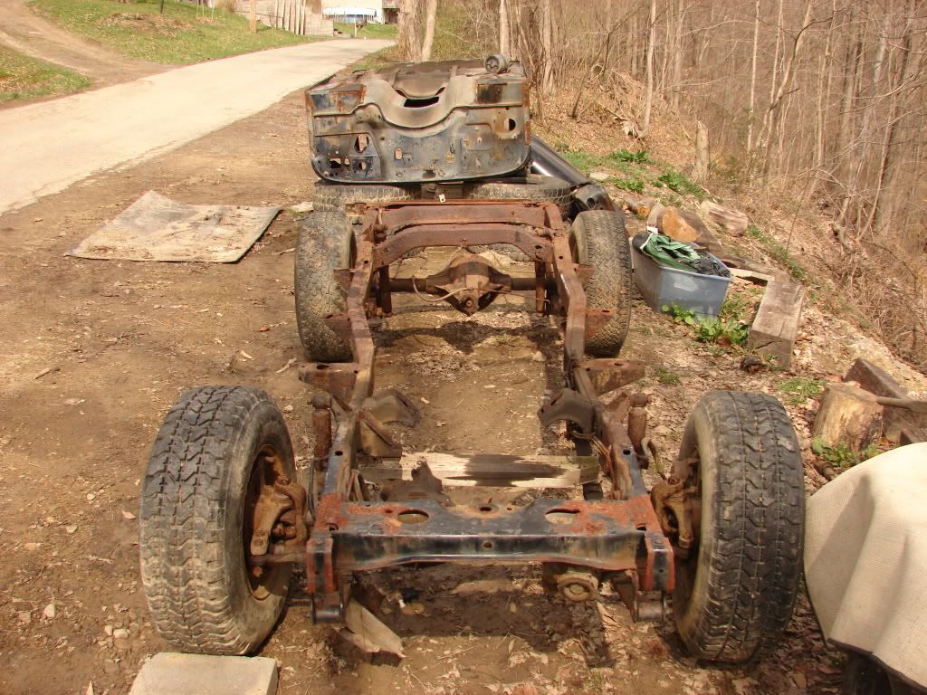

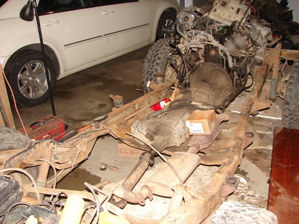

tub off! i hosed the frame off with hot water from the garden hose. just cleaned off the mud and some loose engine grime. will be degreasing and pressure washing then off to meet mr wire wheel before any plating is put on. (plating cut out will get pics of it aswell)
i have a complete rolling chassis with motor,trans, and x-case sitting in my basement. now the fun begins.
