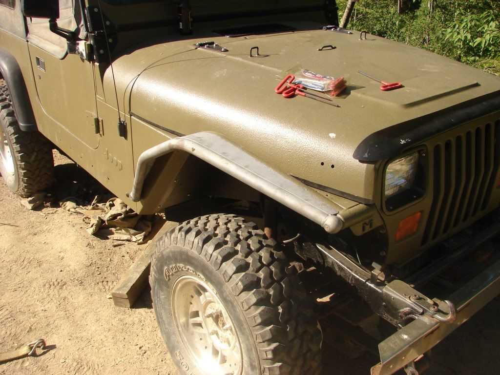

post #158 of 464 Old 07-05-2011, 07:57 PM Thread Starter
mike_breaker_5
Location: emporium,
Posts: 3,009
today the daughter learned about recovering a stuck vehicle. my son learned not to sit on the vehicle being recovered.
both enjoying the top down after a successful recovery of the foot powered mobile.

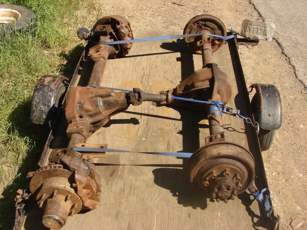

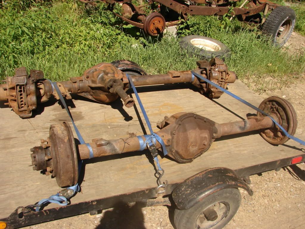

now back to business...
woke up at 4am to drive 6 hours round trip to get these
dana 60 rear, after a little detective work by ratmonkey we're pretty sure it is off an old dodge cuc-v. the wms-wms is only like 64" very narrow for a d-60.
the front is a full width high pinion d60 from a 1978 f-350 that needs a little TLC. laundry list includes but is not limited to...
high steer arms
ball joints
rotors
pads
hubs
perches re-located
and a good cleaning with a fresh coat of chassis saver.

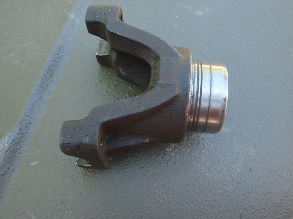

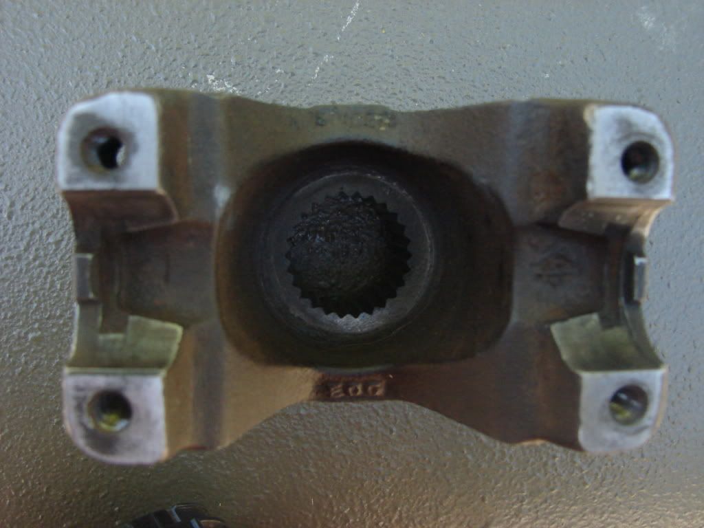

got the yoke back from the machinist (my brother) today. he was able to save the threads in the hole with the broken bolt stud in it.
he also gave it a good dip in the parts washer for me too.
and to top the day off guess what the brown santa brought me today?
i'll give you a hint... it's not green or black.
