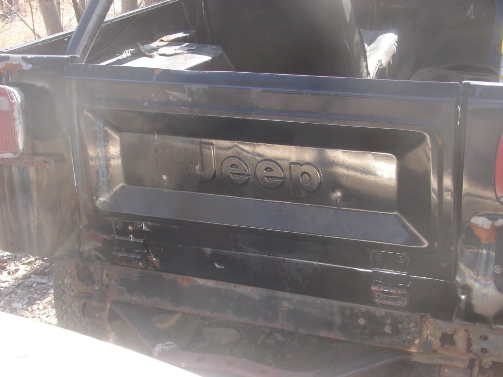

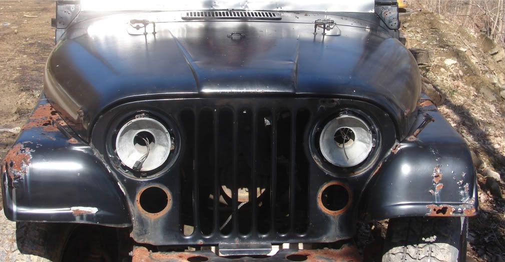

well it's been abit since last post but slowly getting geared up for major de-construction. as promised here's a few pics of the parts jeep i got FREE!!! both axles are usable, and the rear has been confirmed as an amc 20, hood, grill, 80% of the frame, dash w/wiring, tailgate, and rollbar all usable parts.
the back 18" of the frame will need rebuilt. if you can believe it the rest of the frame is solid as a rock.
sitting in a farmers field for god knows how long and look at that dash! it would be a shame not to use it.
i know it's not alot for now but still a little nippy up here some days. between the kids and new deck getting built, the boss has made it clear the jeep can wait till warmer weather.
