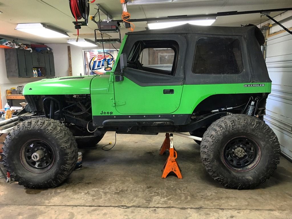

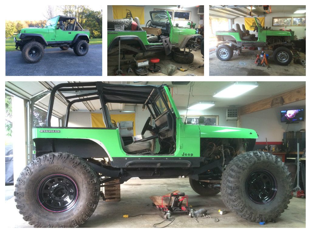

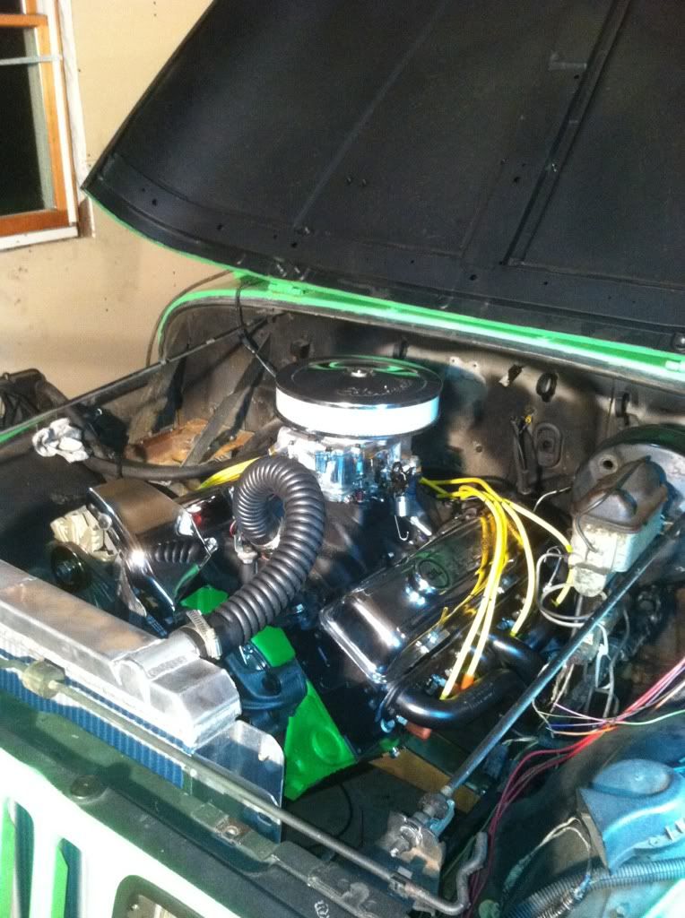

Well here's a 3 year update. Things changed...a lot. Went to 1 tons, and a rear 4 link setup. New thread is on Pirate 4x4. Pics explain it better than words.
http://www.pirate4x4.com/forum/jeep-...-yj-build.html

EDIT: Jeep is currently set up with the following:
355 SBC 400hp/400 ft. Lbs.
SM465 transmission
NP231 w/ MegaShort SYE
Ford 8.8 4.10 LSD
Dana 30 4.10 Stock (next upgrade)
BDS 3.5" Springs
Boomerang Shackles

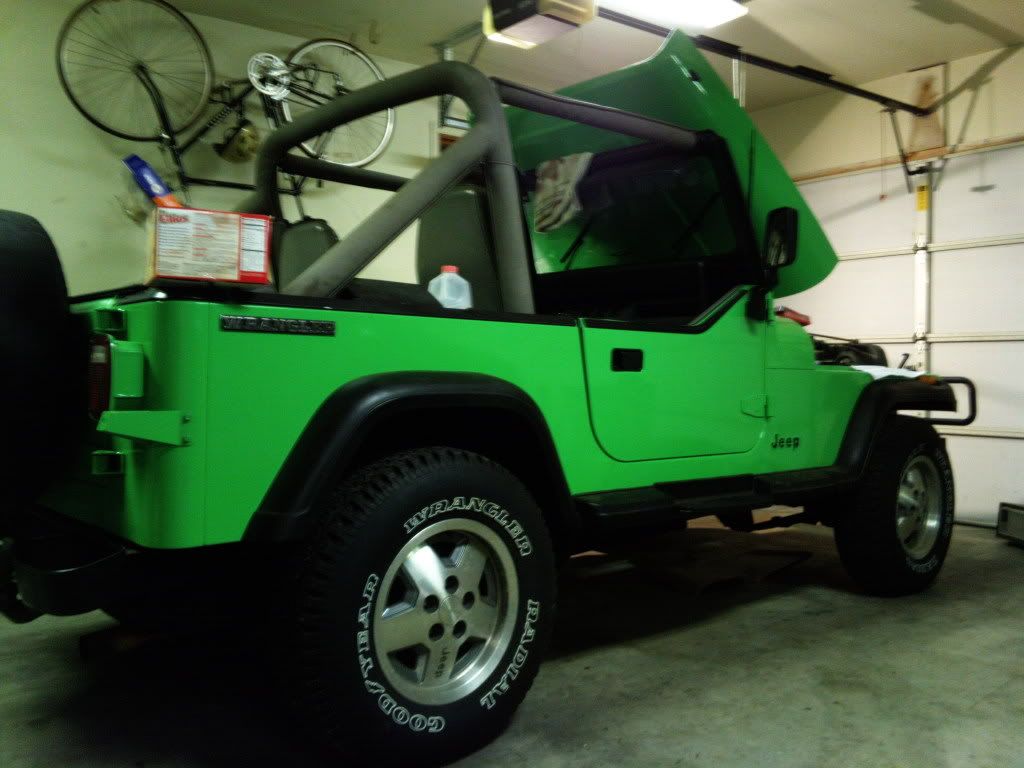

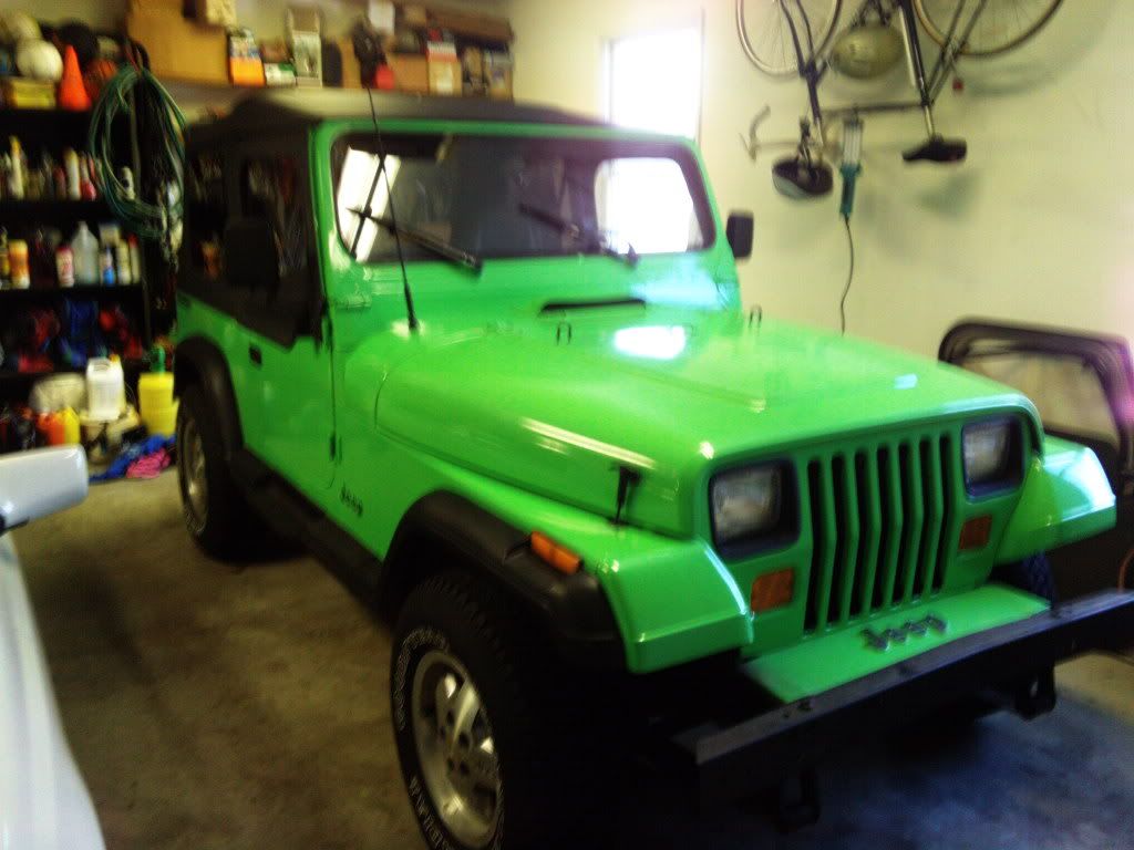

Background on the Jeep: I bought this 1988 YJ 4.2L 5 speed in Maryland in mid-January as a project. It was owned by an older gentlemen who only used to to drive in the summer with the top off. It came with a bikini top and a supertop frame with no skin. I found the ad on Craigslist and was not very fond of the color but when I saw it in person I decided to keep it painted the way it was. It is a very unique color from AMC that was called "big bad green" or something along those lines. The PO had also truckbed-lined the tub and put brand new tires on it prior to selling it. He also decided to sticker it up with "Jeep Jeep" stickers and decals of Pop-eye's assistant Eugene. So, only fittingly, I named him Eugene. The stickers are definitely being thrown out and the dodge floor mats that came in it were thrown out upon entrance into my garage.

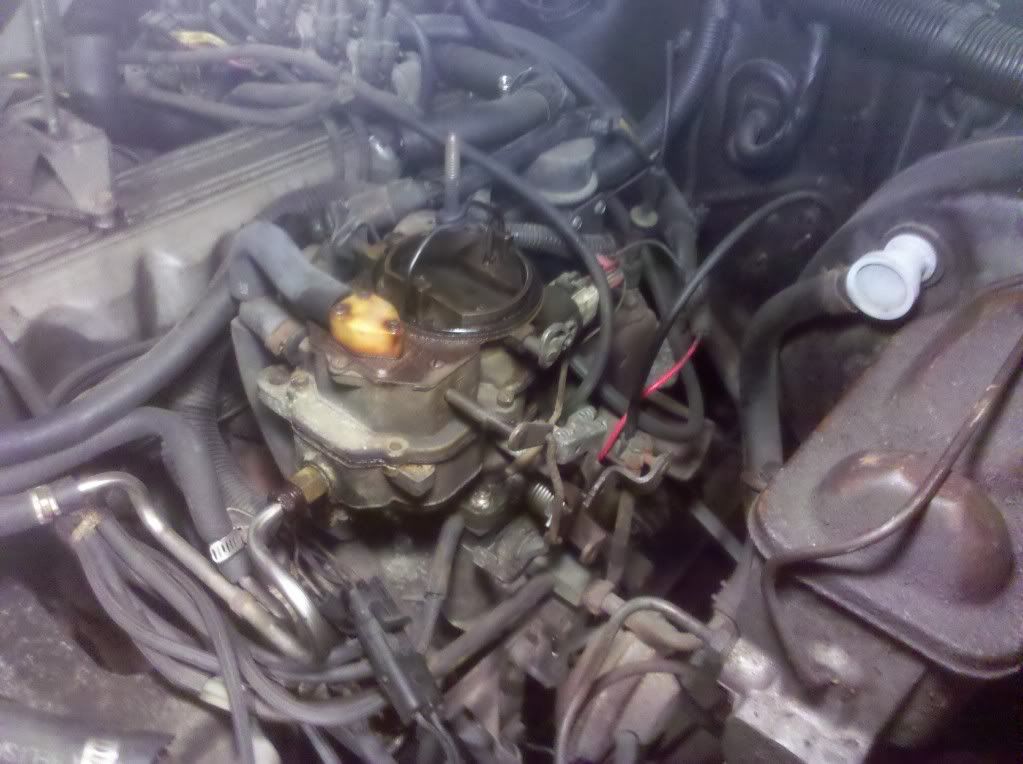

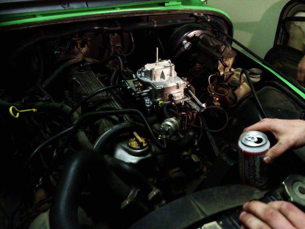

The jeep did not come problem free, however. It has somewhat saggy springs and it idled very high until it warmed up. Also, it would bog out in the the mid-RPM's. This was due to the Carter POS, whoops I mean BBD.

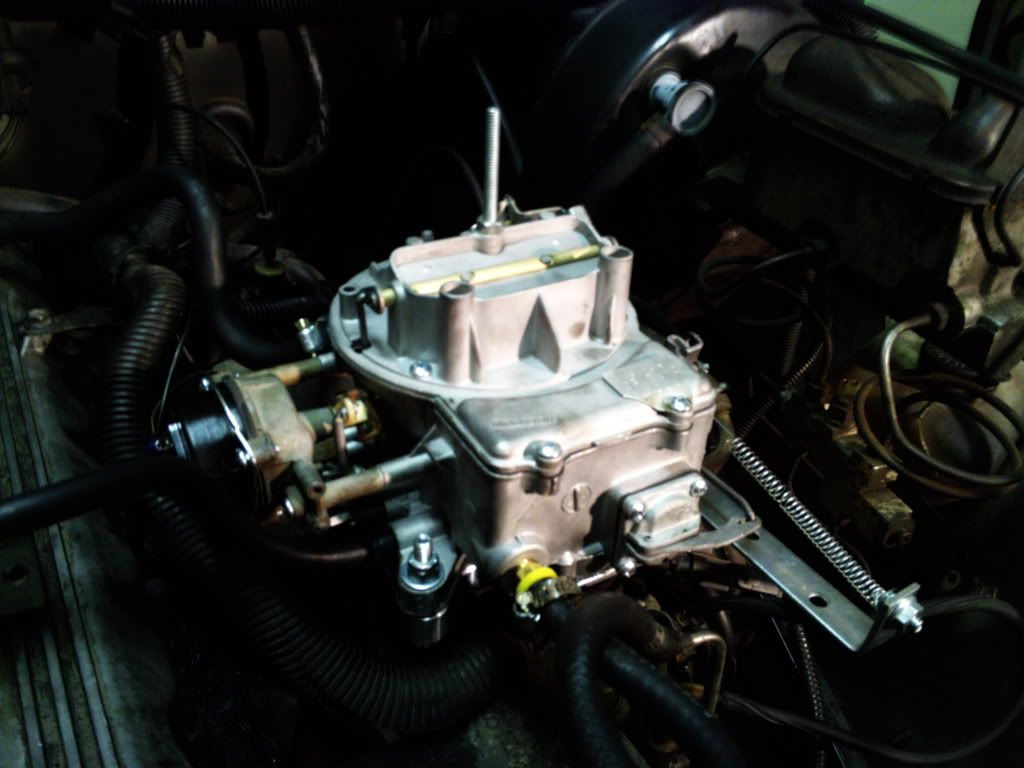

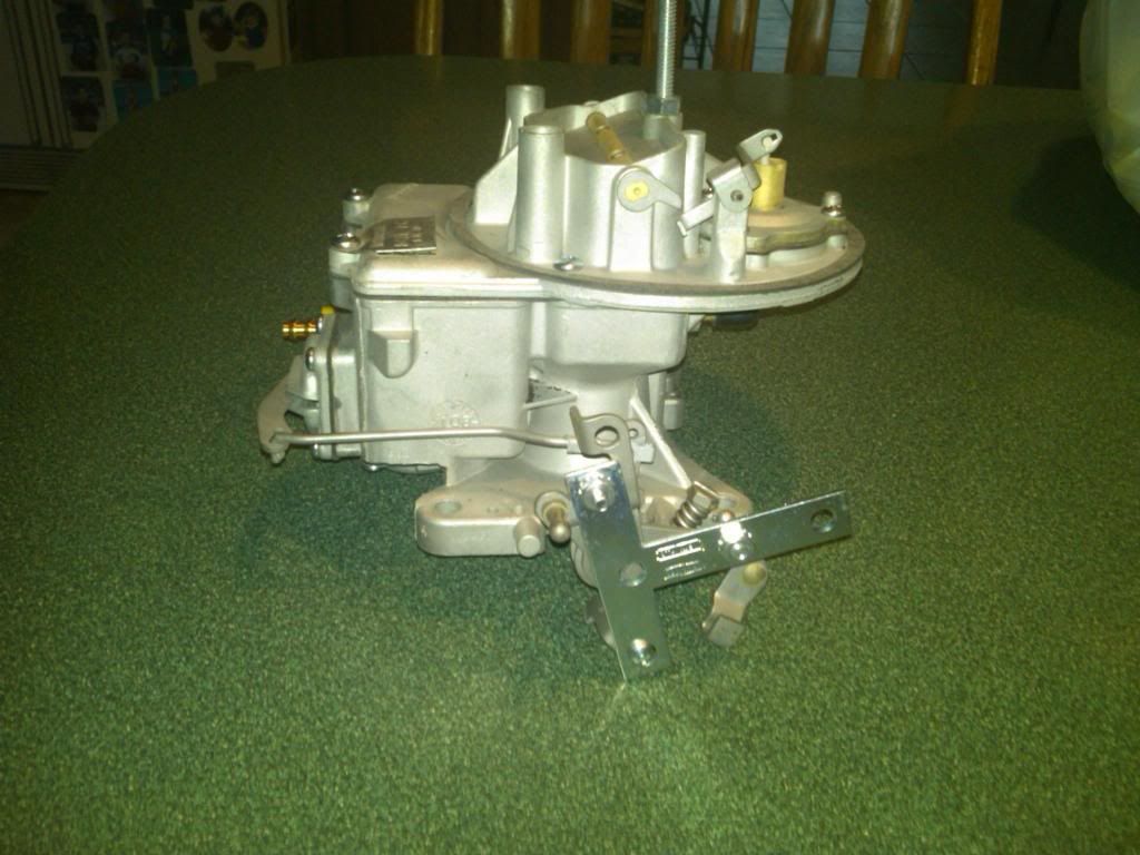

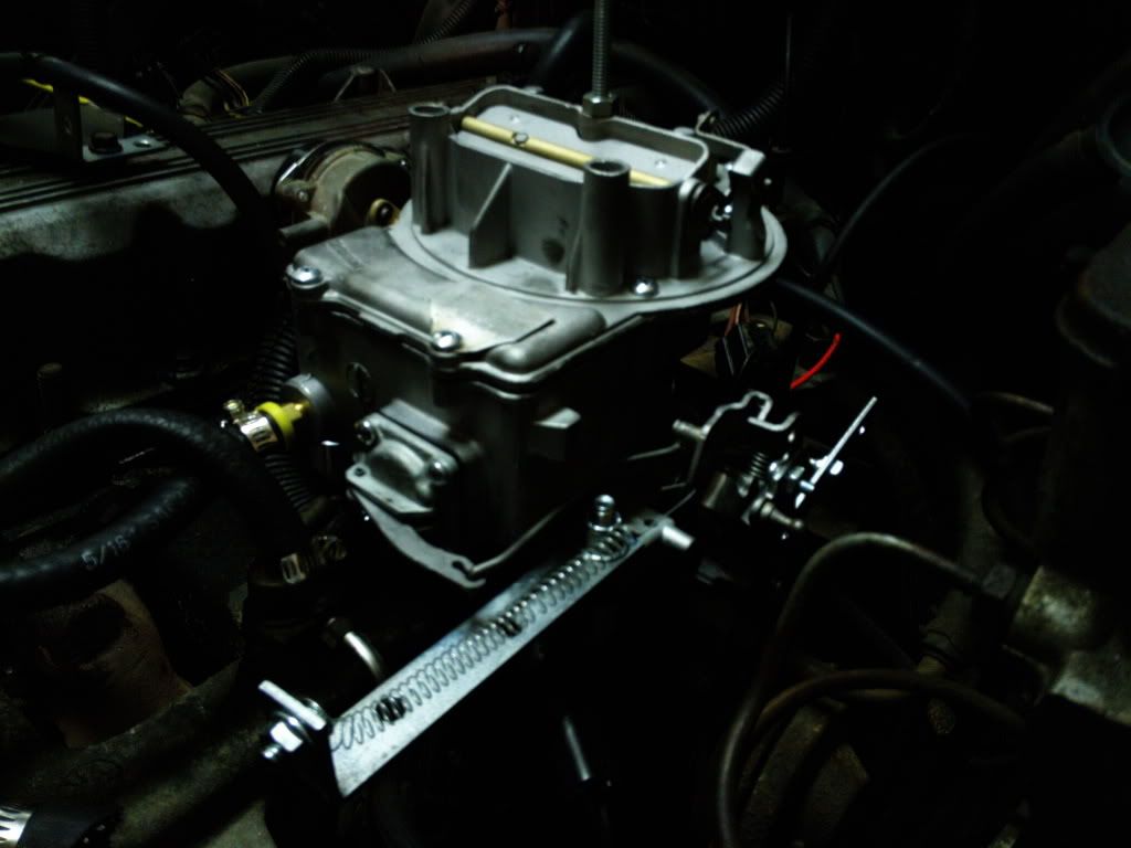

First project was to replace the Carter carb (I rebuilt it first only to find a stud snapped off in it and a faulty stepper motor) with another more reliable piece. I decided to go with a motorcraft carb and began my search on craigslist. I soon found one:

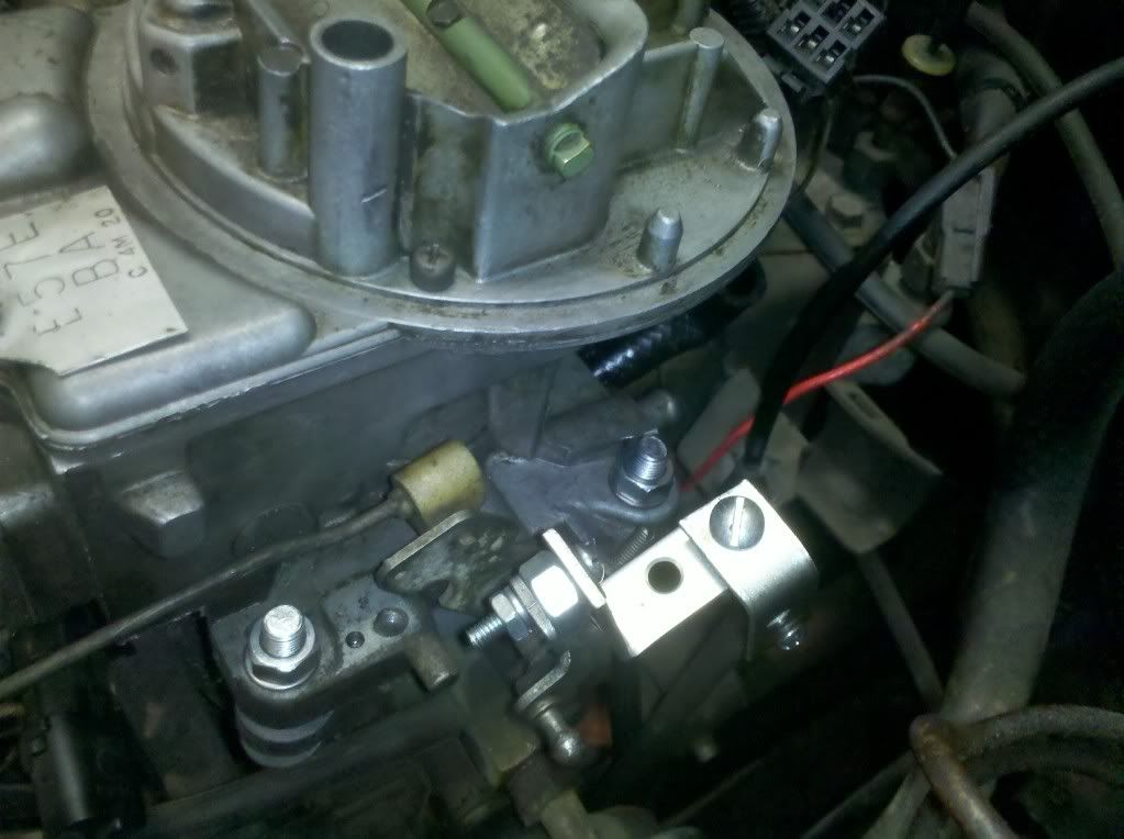

I bought the Trans-Dapt kit to mount it and went to work. The MC2150 that I bought turned out to be poorly rebuilt by the guy i bought it from and just was not going to work for me. Sadly, I only realized this after I had it mounted and all the lines and linkages hooked up. The jeep actually ran for a short period of time (much to my surprise) but I was not able to tune it in due to the faulty rebuild. Here is the carb on the jeep with pictures of my homemade linkage adapter and return spring bracket:
I have since ordered a kit from the infamous "erhmann" on ebay (http://myworld.ebay.com/ebaymotors/ehrmannmp/). So far he has been a great seller and kept communication with me as promised. He has also followed through by sending me the necessary information to properly install the carb. I will update more on the carb status this weekend when I get a chance to install it.

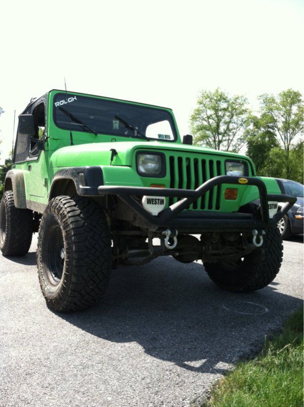

Future plans at this point are 4" suspension lift, 33's on 15x8 or 15x10 (haven't decided yet) and new front and rear bumpers. Hopefully those will all be done before or in the beginning of summer. Its hard to get home from school to work on it so the process is slow, not to mention the fact that the jeep has raided my pockets

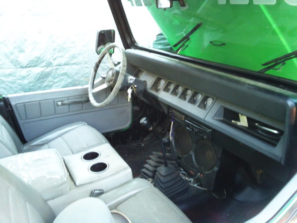

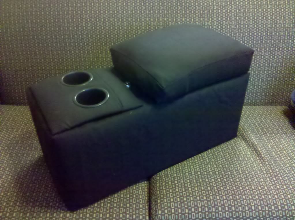

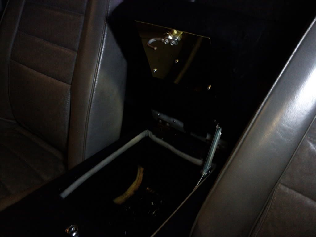

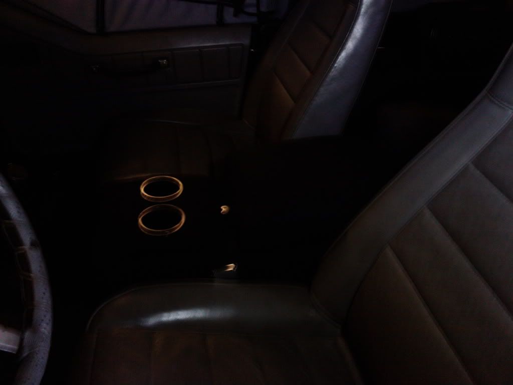

I just got a picture of my console now that it is finished. It went from:
To This:

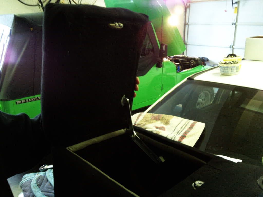

I went to s small shop called Wooden Bridge Dry Goods and bought 2 yards of black canvas for $6 a yard. The I got the amish lady that worked there to sew the piece for the armrest and cut out the other pieces. She charged $8 for labor. I then went to the hardware store and got some 5/16" staples and simply wrapped the console the way it was from the manufacturer and it turned out nice. I also bought a new lock cylinder for it because the PO didn't give me the key to the console (luckily it was unlocked). Then I got 2 cans of "Wet Pruf" by Kiwi and sprayed the entire console with 2 coats. It is completely waterproof now. The water just beads up and runs right off of it. All in all, I have about $35 into it and about an hours worth of labor. I definitely think it was worth the money.

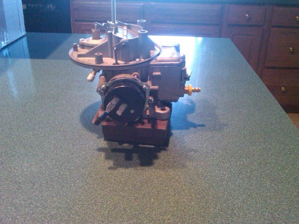

Just got the new carb kit in. Looks real good. Much thanks to Mike E. from eBay (see above link). It will be bolted up this weekend with the new supertop. More pics to come.

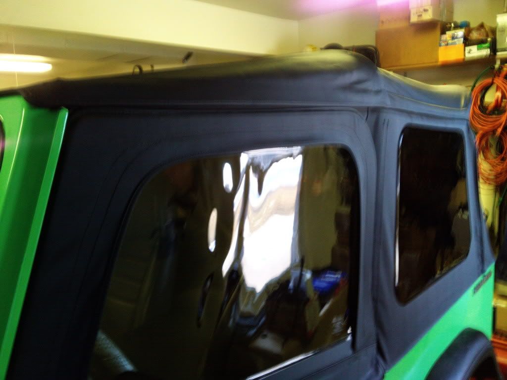

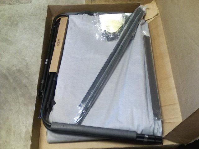

The supertop just came in today. Can't wait to get it on this weekend. Hopefully storing it in the house will warm it up enough to get it stretched over the frame. I might have to use a hair dryer or heat gun as well. Anyone have experience with a cold weather top install?

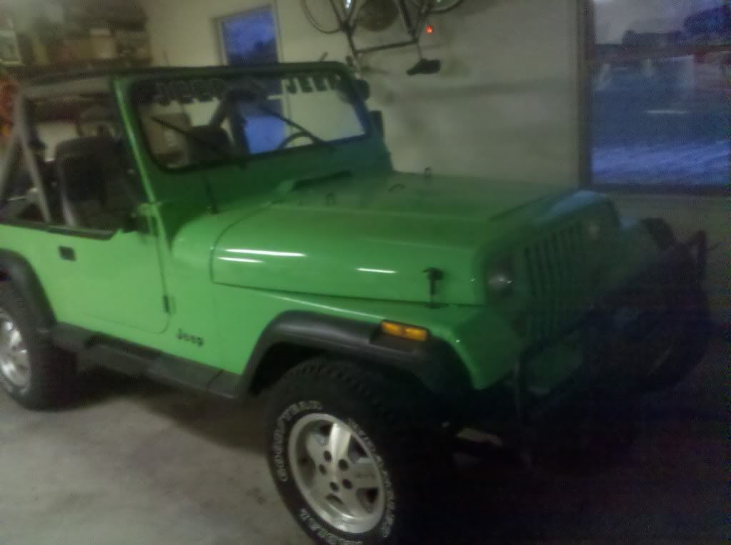

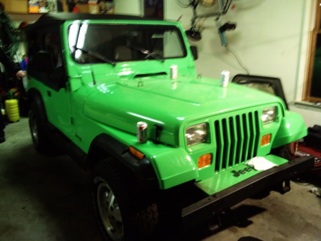

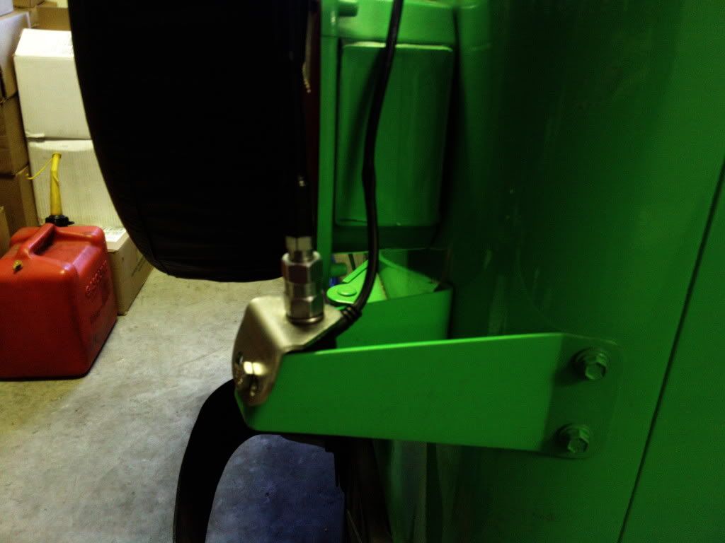

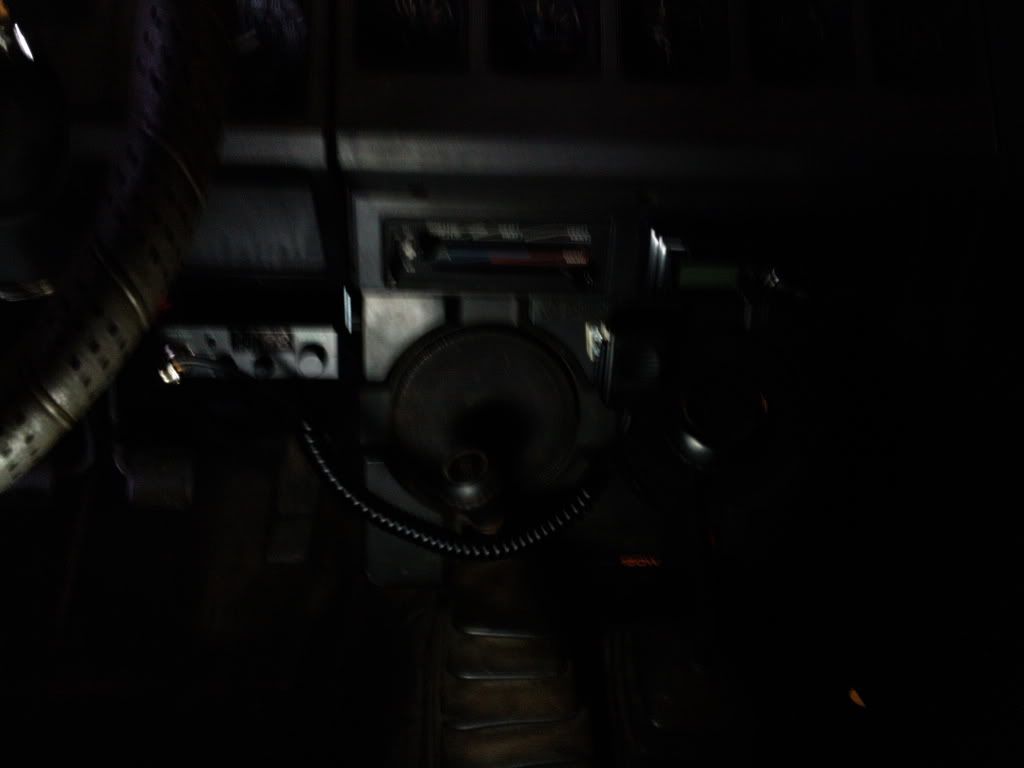

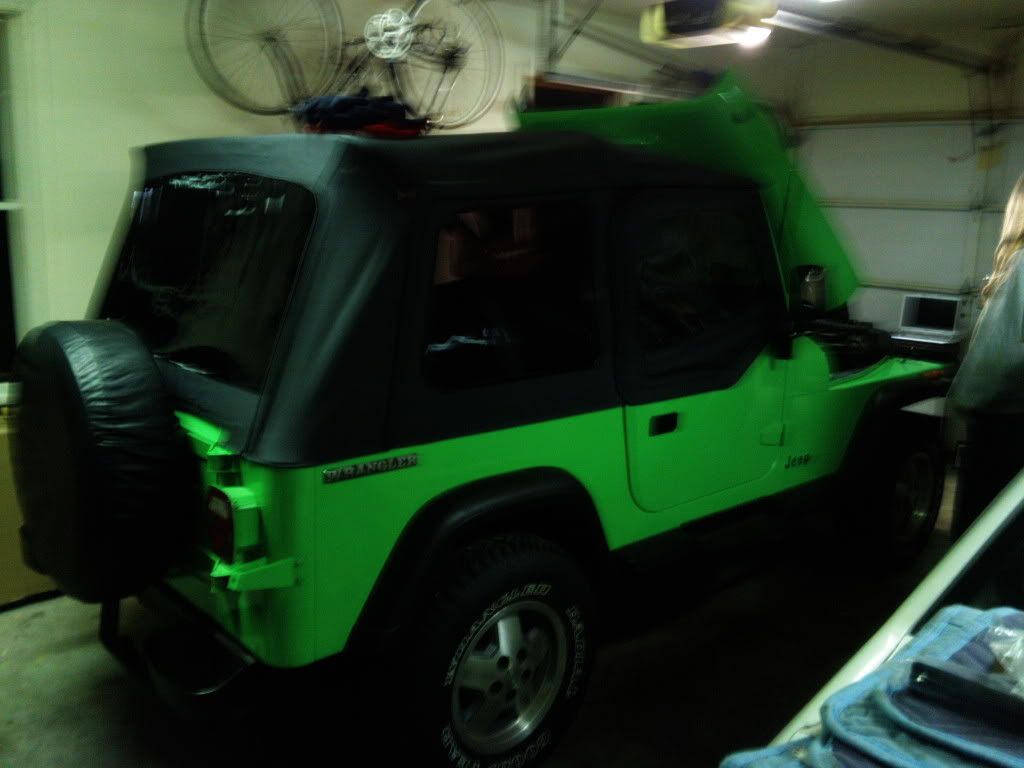

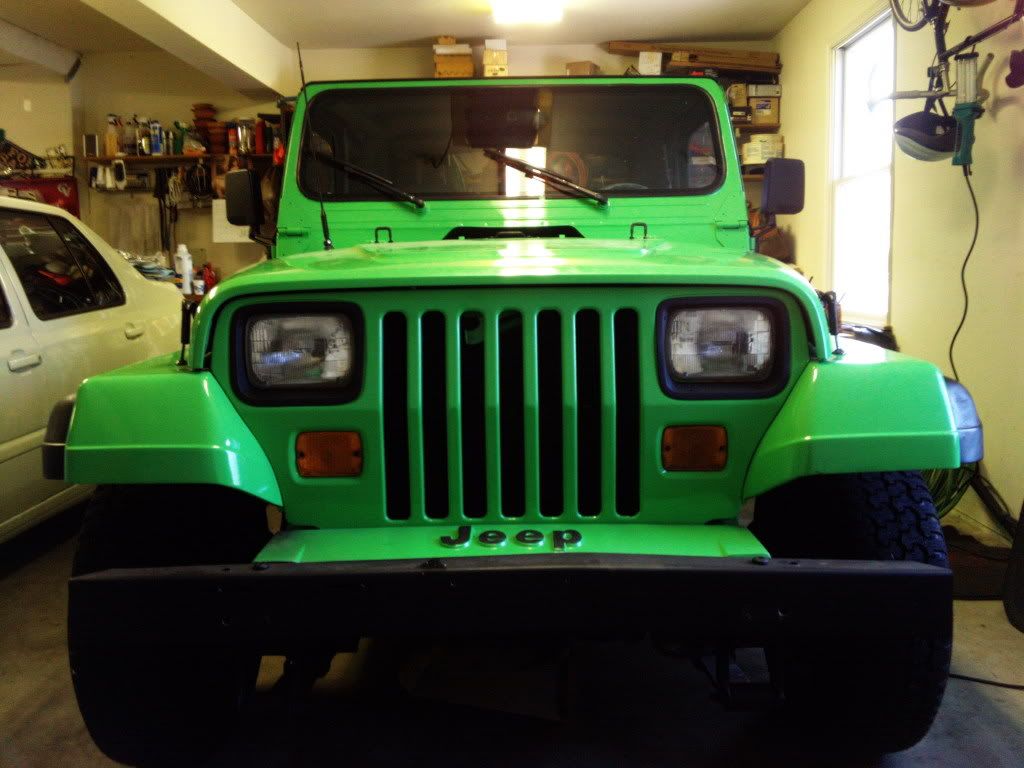

The Heep is now officially a Jeep! Got it running and got the top on it. Also installed the new CB kit I picked up off of Craigslist and the console.
First was the Carb:

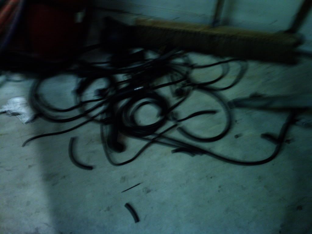

This was the unused pile of crap that was ripped out:

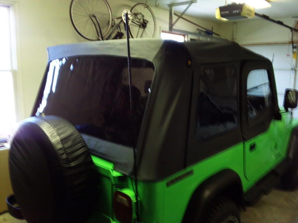

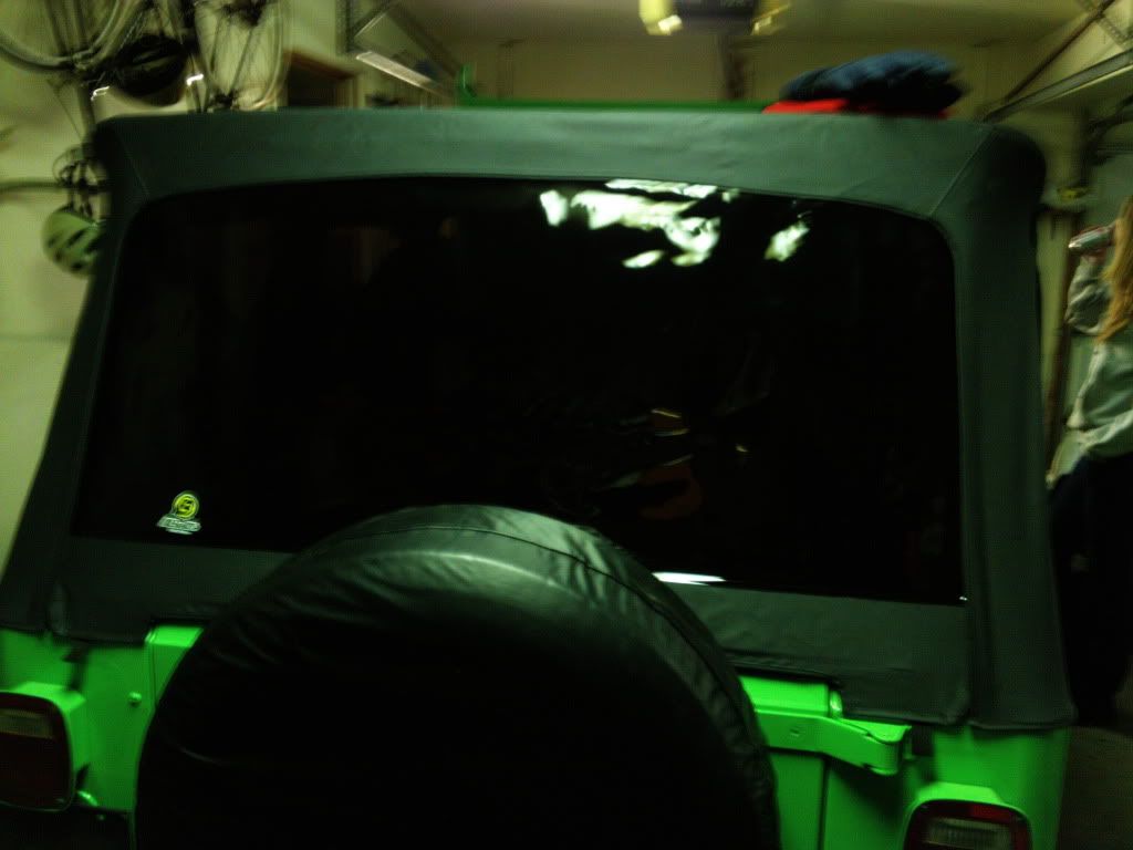

Next was the supertop:

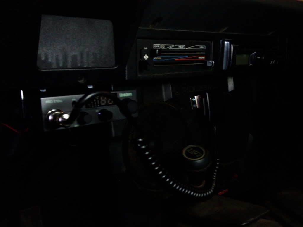

Then came the CB install:

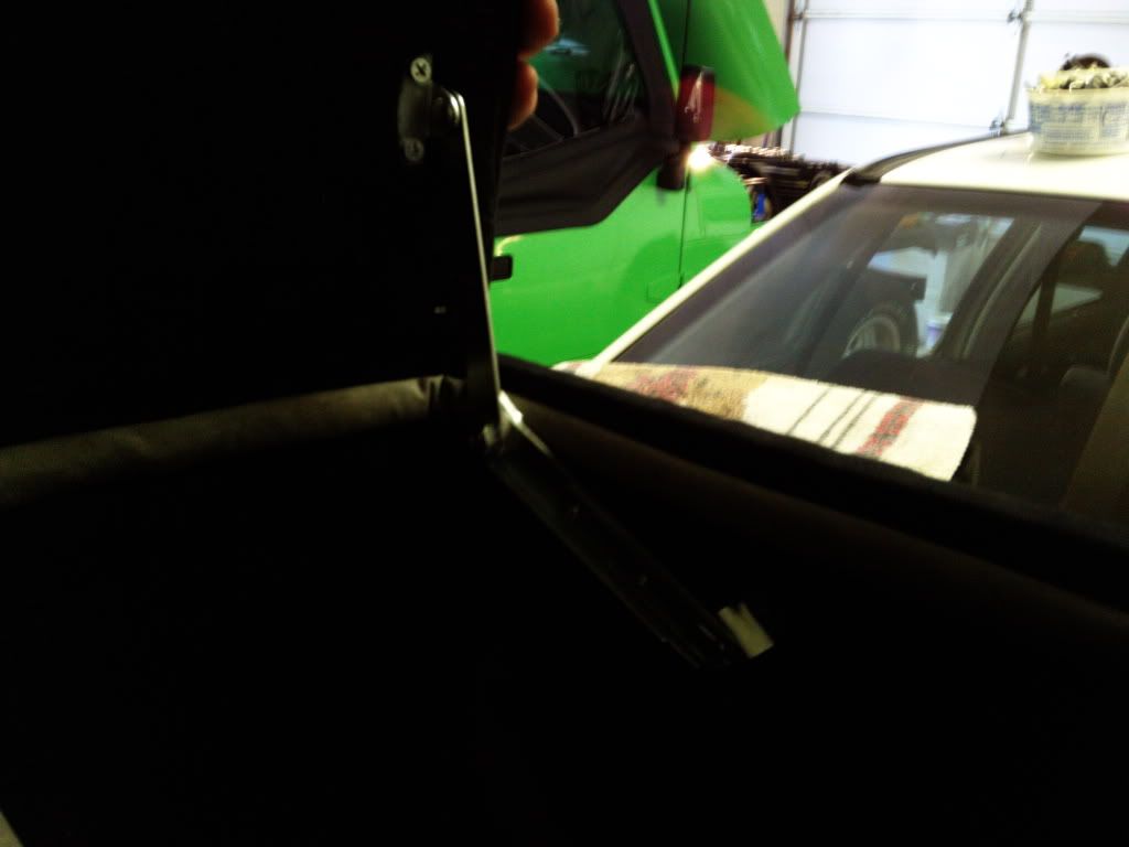

Fixed the console hinges and added a support arm:

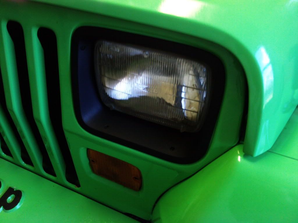

Lastly, the headlight bezels were painted due to boredom and the hope that they would look good:

dude, take those taillights off and paint them black, or if you have 40 bucks go to walmart and get led tail lights, and your tailgate stop take it off and paint it black it will look 10 times better, check out my build i did the tail lights cheap and very easyyyyyy.
other then that love the color nice jeep
