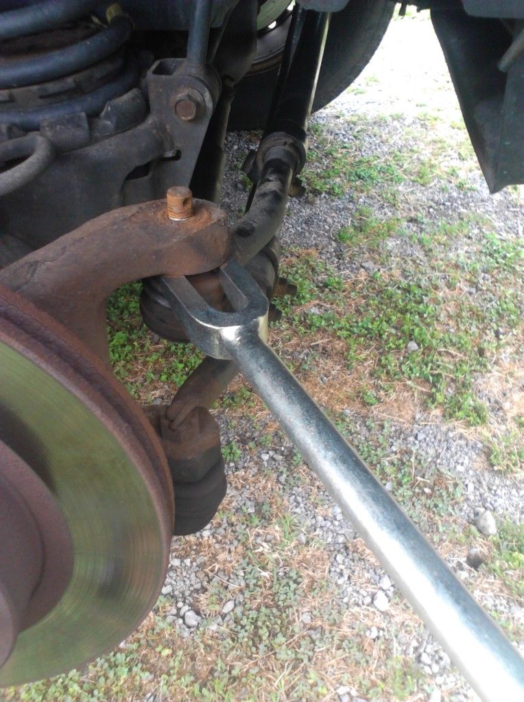

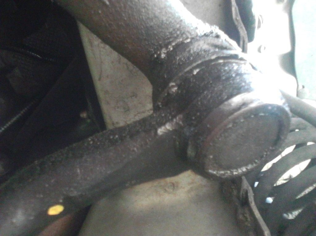

Tie rod end replacement complete! What a mess. This took WAAAY more time than I was expecting. Mostly because the pitman arm to drag link tie rod was stuck on there.
It took four hours of beating, an acetylene torch, two cans of PB Blaster, and a 6' breaker bar to get that thing off. Anyway, I digress:
This was the main culprit. The bushing between the pitman arm and drag link had fallen apart, leaving grease everywhere.

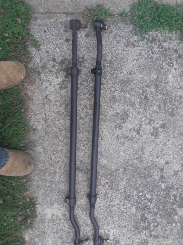

I only took pictures of the new drag link setup...
Two solid hits with the BFH and this guy fell right off.
