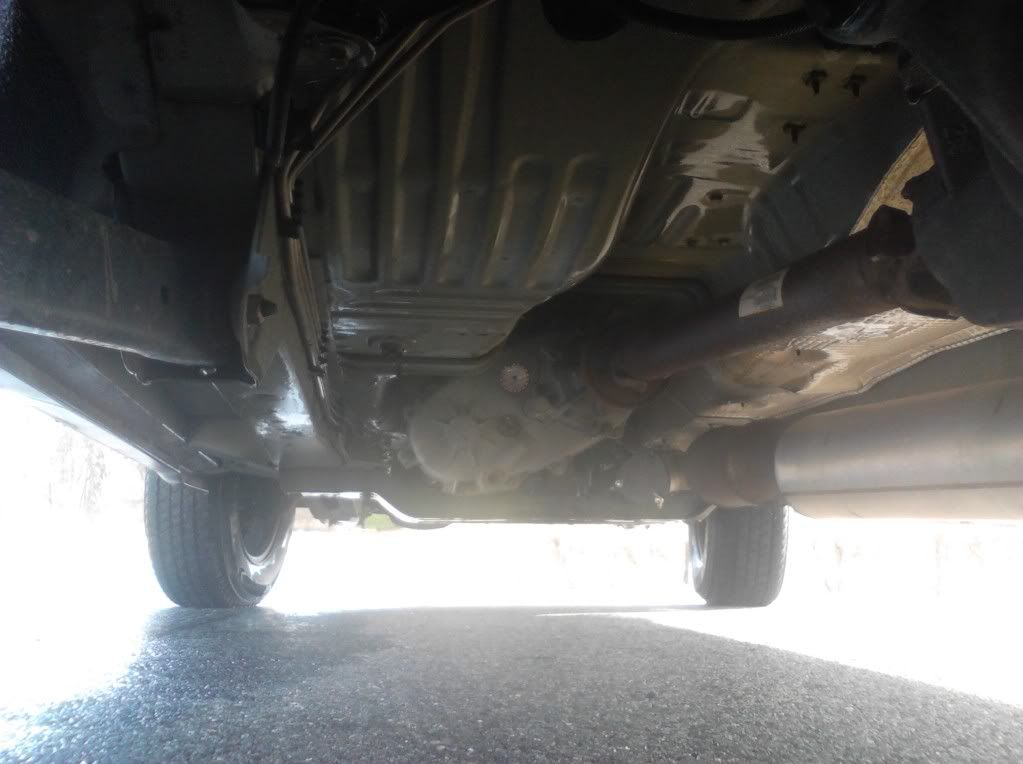

After reading a bunch of people complain about rust on the underside of their WJ's I decided to do a little preventative maintenance. I live on the eastern coast, so there's lots of salt and mud that gets stuck up under the Jeep. I spent about two hours with a pressure washer and a Brillo pad fixing that.
***BEFORE***
Got it all up in the air
The cutout and muffler; caked in mud
***AFTER***
Clean enough to eat off of

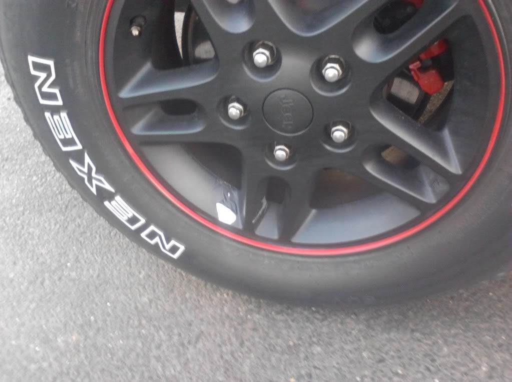

Problems with Plastidipped wheels
I hit a small tree going sideways about 35mph. Luckilly the Jeep was 99% ok. The only problem was the little scratch it put in the Plastidip on the wheels. It started, as I feared, to peel away.
This is how to fix peeling Plastidip wheels without redoing the whole wheel..
-CUT OUT the area that has the peeling paint on it that you want to remove
-Remove it
-Repaint it
The peeling area
Cut out and removed the peeling area
And ran out of time to take pictures of the finished product.

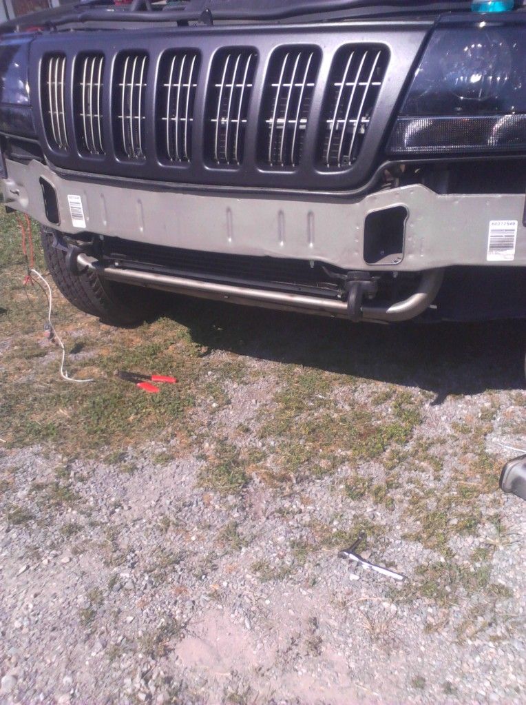

Got some lights from Wallyworld today. Impulse buy. Mounted them behind the grill...
The switch that came with it was broken when I opened the package.
And the wiring mess on the inside.

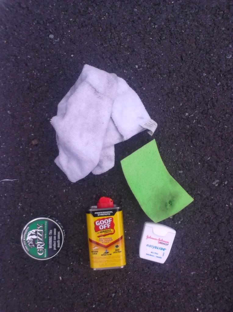

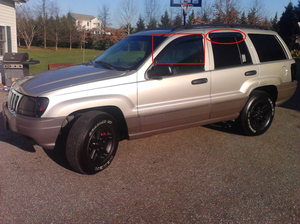

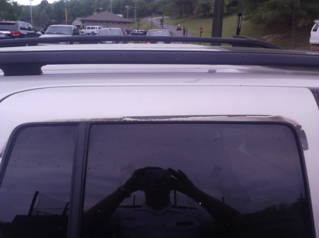

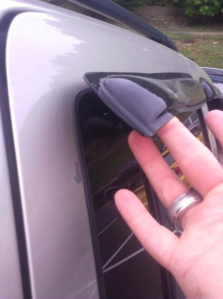

PO put window deflectors on my Jeep. They're starting to come off. I hated them from day one, but was worried about ruining the paint.
These stupid things:
I was going to wait until after finals to finish this, but the Jeep had other plans. The rear, passenger side deflector came off some and started smashing into the side of the Jeep at speed. The plan was to just take off the one that one and find a method that works.
You can see how much of the thing had come off...
I gathered some supplies that I had sitting around. I didn't get the eraser or fishing line yet--I was in a big hurry and didn't want the thing flapping in the wind anymore. So Goof-Off and dental floss made due.
This is what was left after cutting it off with the dental floss:
And then about ten minutes into cleaning off the glue with goof off and a rag it started raining. I quit and went back inside. If it stops, I'll go out and finish the other windows. This is what it looked like right as it started to rain:
The Goof Off and rag worked pretty well. I'm thinking about trying one of the Mr. Clean "Magic Erasers" tomorrow to see if that works. There were a couple of scratches in the paint, but I'm pretty sure most of them were from the #$%*ing thing banging in the wind. Hopefully they all buff out.

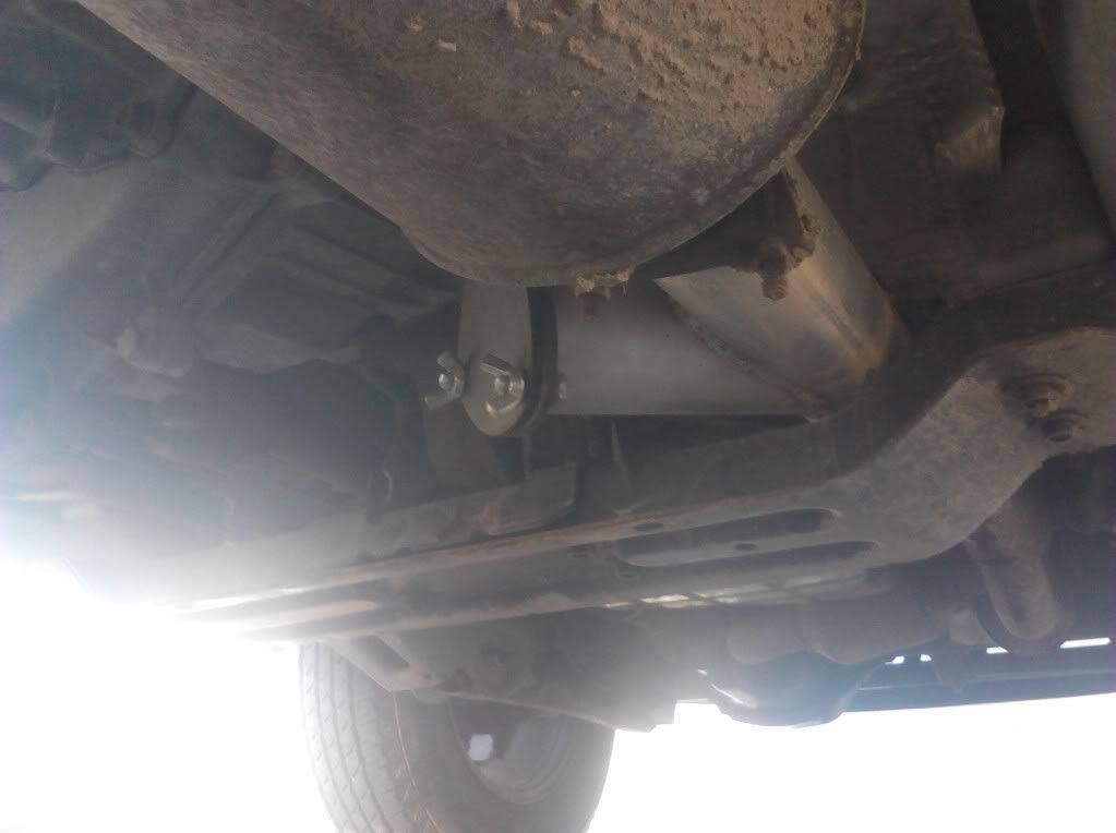

I was driving on an "improved surface" and my muffler got caught on a stump... Pulled the exhaust all apart. Left the muffler hanging about 1" off of the ground.
Jacked it back up into place and put some real welds on it. At least its not dragging on the ground now...

Finally finished this @#$%ing job. I got some braided fish line and it made quick work of cutting off the deflectors. It missed a little tiny bit of tape along the top of each, though. I found this stuff that Turtle Wax makes for removing tape and stickers from cars. It sounded like it was just what I wanted to finish the job.
This is right off of the label:
Penetrating formula quickly dissolves adhesive residue on glass and painted surfaces
Easy solution for removing window stickers, bumper stickers, residue from tape, markers, crayons, lipstick and more!
Safe to use on all nonporous automotive surfaces, metal, paint, bumpers, plastic, and glass windows. Will not damage automotive paint.
It was great on the tape. It took less than 30 minutes to finish it all off. My only complaint was that it took off the @#$%ING CLEARCOAT! and in a couple of spots ate through the base paint. I sprayed it on like it said (2"-4" away), let it sit for 60 seconds, and wiped it off. Well after finishing and washing the whole Jeep, it was pretty obvious that this stuff was a little too good at removing. The fact that it smells like pure paint thinner should have been a warning...
Oh well. After 4 hours in the driveway with my entire kit of paint correction supplies usually reserved for the other vehicles, I fixed my @#$% up. It looks 90% back to normal. There's still some fade under where the deflectors were, but they're gone.

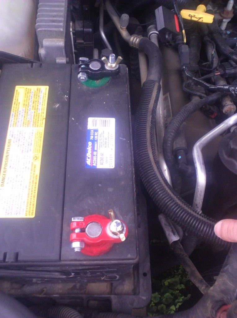

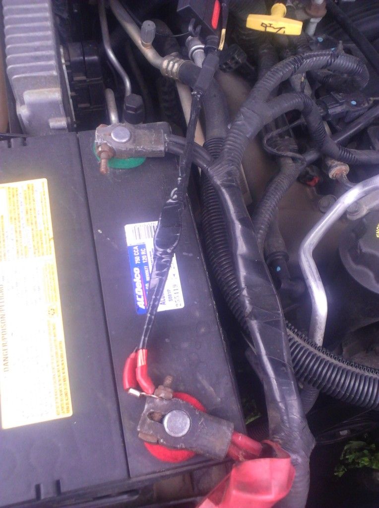

Threw some marine terminals on the battery. It took 10 minutes and $6 in supplies. It's already one of my favorite little touches, though. The two other wires coming off of the +12V are the power inverter and my amplifier.
Old terminals:
Made sure the new ones fit before I started cutting anything...
And everything all connected.
I'll probably end up taping/heat shrink wrapping it all in the next couple of days to pretty it all up.

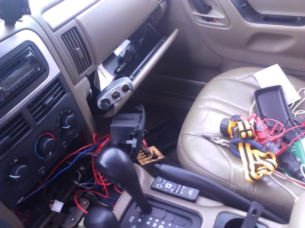

I had the day off so I spent some quality time with the Jeep. First thing was changing the oil. It was 27 miles over due... Oops. The I put some bump in the trunk.
Seat still closes just fine.
Put a bass-level controller in
Wired in a kill-switch for the amplifier.
Mounted and wired up a Harbor Freight power inverter while I had the rolls of 4 gauge wire out.
Aaand put the shorty antenna on.

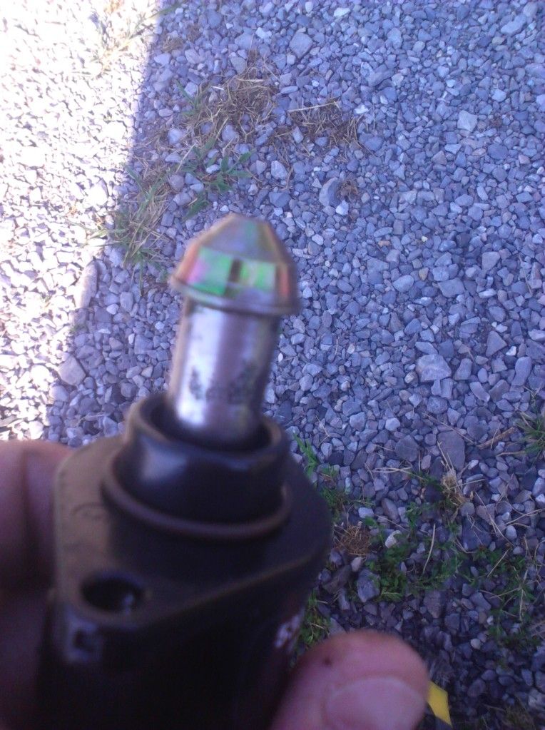

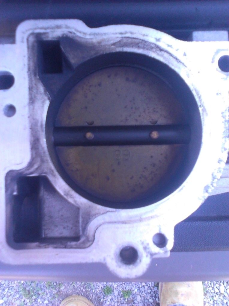

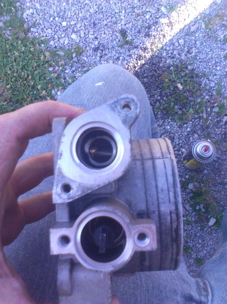

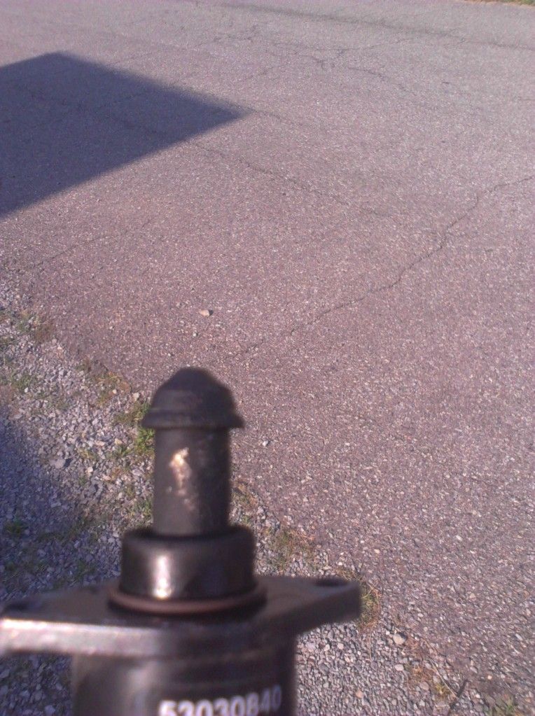

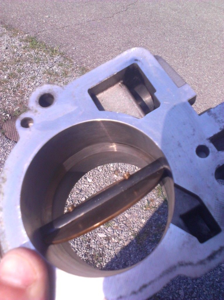

Cleaned the IAC and TB today. Not really a "build" addition, but routine maintenance. I wasn't having idle issues, but I haven't cleaned it since owning the Jeep so I assumed it couldn't hurt.
Before:
After:
Before:
After:
For some reason, cleaning the IAC hole reminded me of cleaning the star chamber on an M16... Before:
Star Chamber:

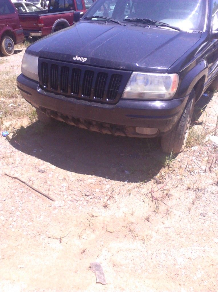

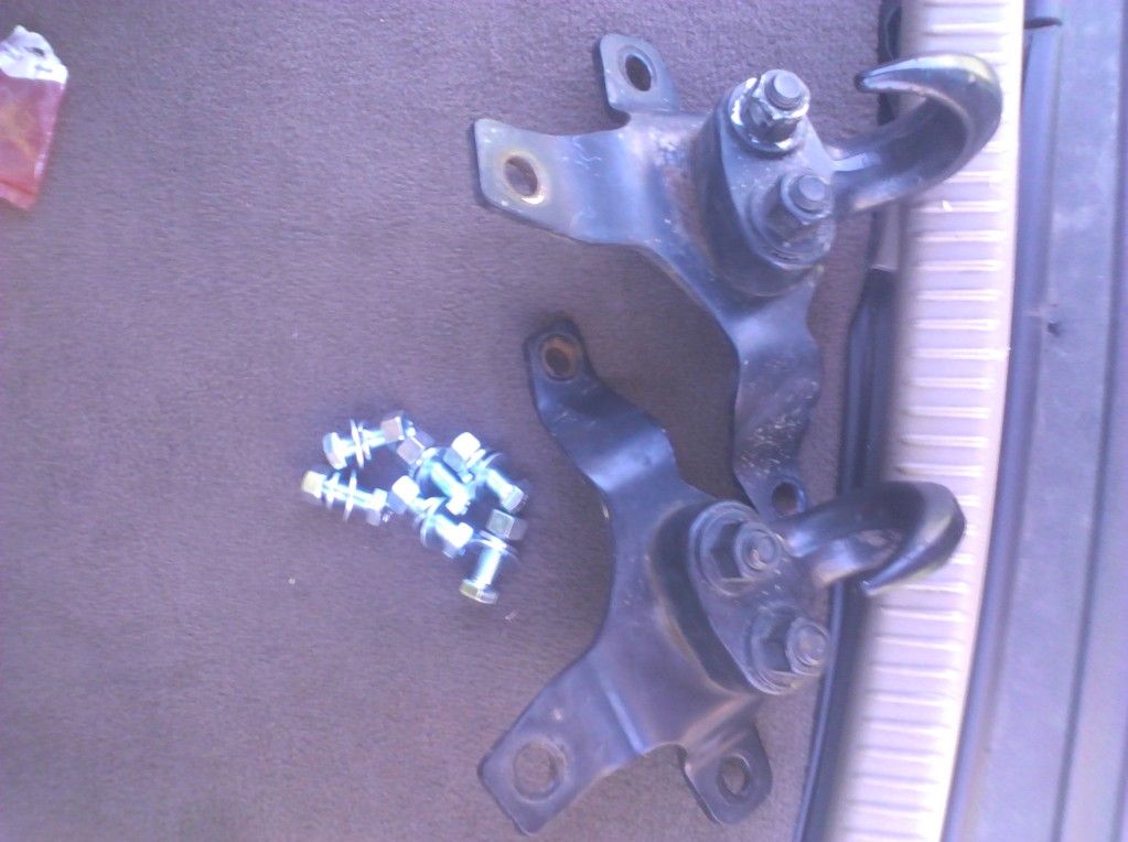

Went back to the junkyard. This poor WJ has only been there for a couple of weeks. It's still 99% complete.
Grabbed a dash speaker and replaced the one I blew the other day.
Also put on the tow hooks I took from the same donor Jeep a couple of days ago.
All new grade 8 hardware
Installed:
And all buttoned up:
