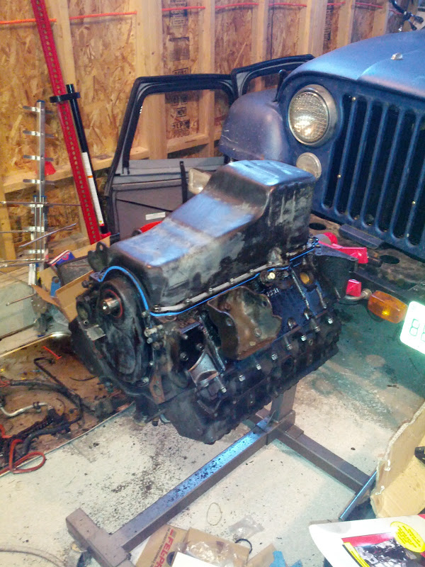

I got a little time this afternoon to put the oil pan, oil adapter, and crank pulley on. (Pic before crank pulley)

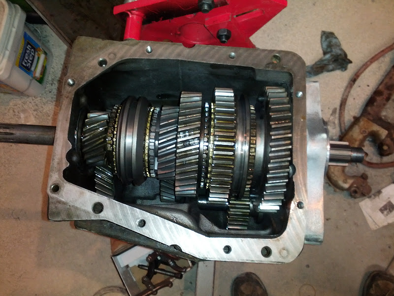

For anyone interested in the inner workings of the SM465, refer to the photo below:
This is before I rebuilt it. Third gear on the countershaft was slid to the left to facilitate removal from the case. Normally it goes right up against 2nd gear.

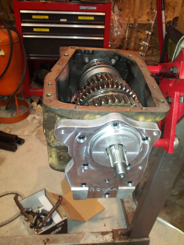

Quick update - no luck still on the pilot bearing, but the adapter plate came in from Novak today.
View of the gears, installed:
Plate installed temporarily to check end play:
Good view of the third gear spacer from Anaheim Gear on the countershaft through the PTO port:

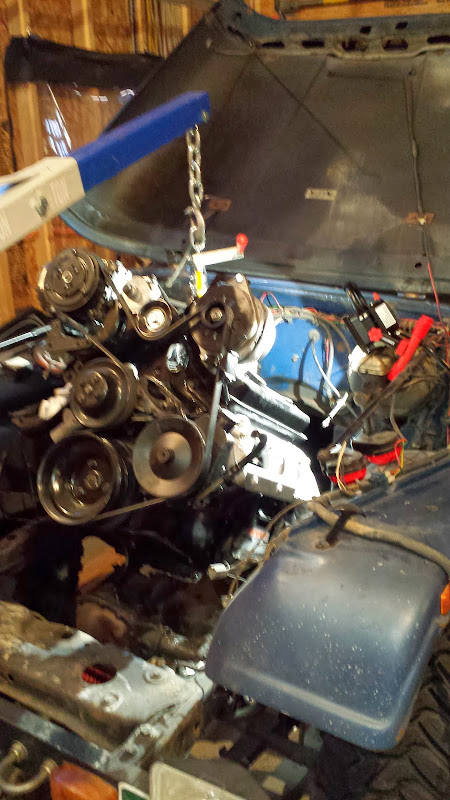

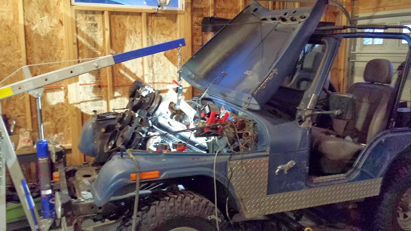

It's been quite a while, but I made some modest progress this past week.
Here's a couple of pics of me lowering it in to mock up motor mounts, etc.

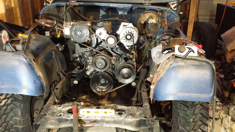

No hoist!
Engine is resting on the permanent mounts, finally!
And a view of the transmission in the tunnel
