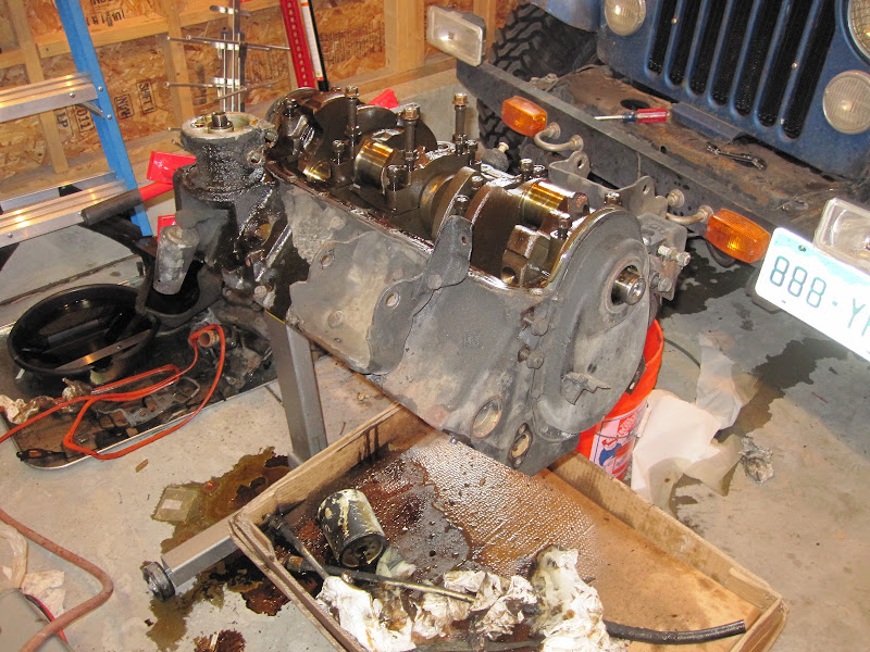

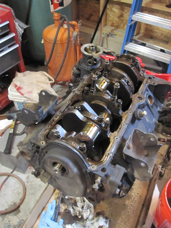

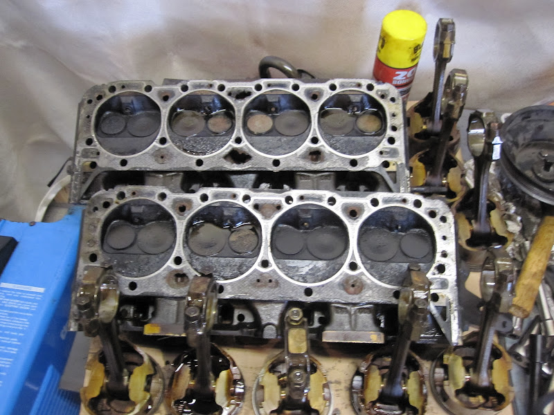

It was a snowy day here in Colorado, and the garage was decently warm, so I spent some time out there and got the engine completely disassembled.
The lower end is in remarkably good shape. You can even still see the crosshatch pattern in the cylinders. The heads, on the other hand, are at least filthy, if not worse. Anybody have any opinions on head casting 10110810 on a SBC?

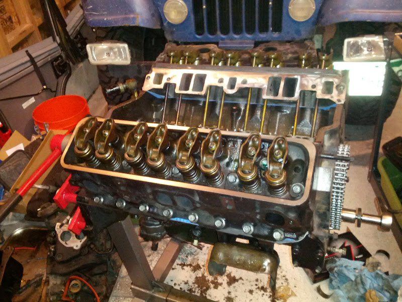

I got the heads installed last night as well as the timing gear, and got the valves "adjusted" - hydraulic lifters are so easy!
