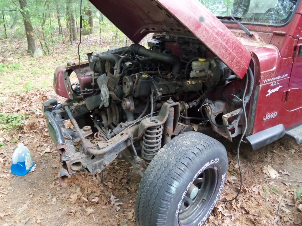

post #65 of 100 Old 05-13-2013, 12:43 PM Thread Starter
kvesi122
Location: Sudbury, Mass
Posts: 232

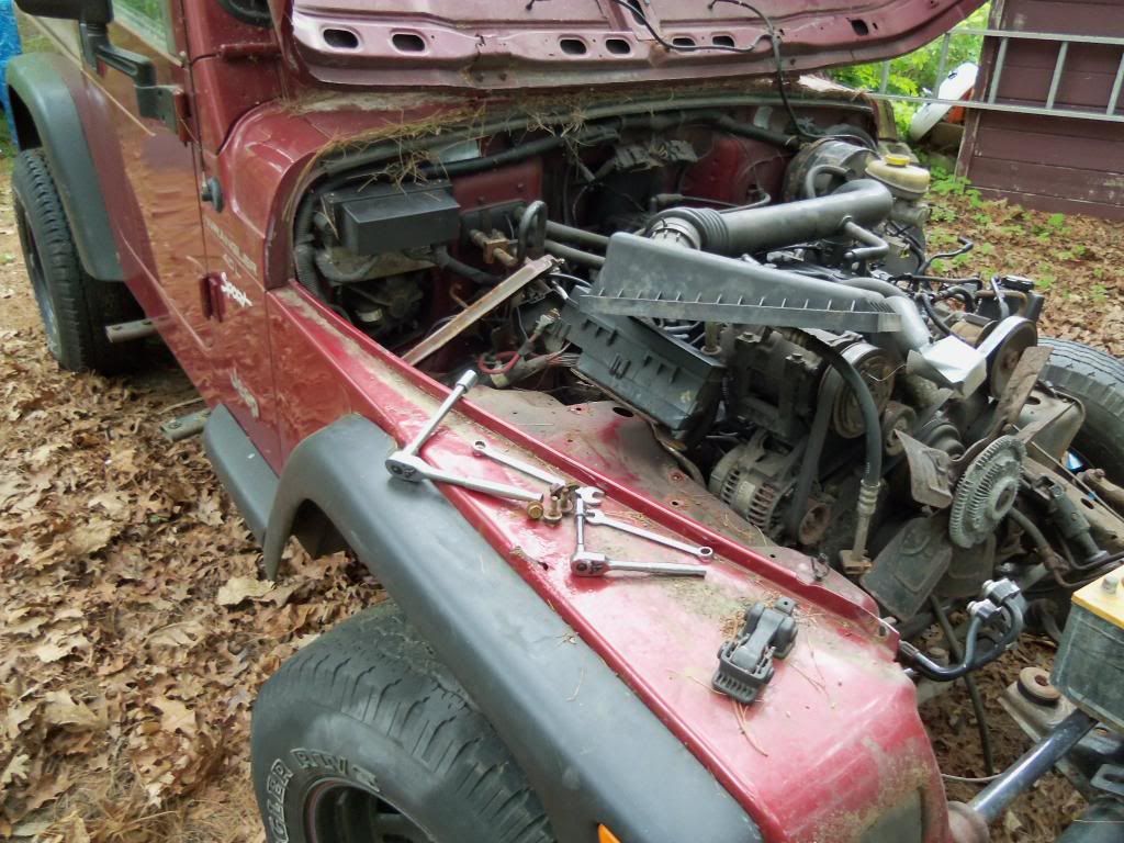

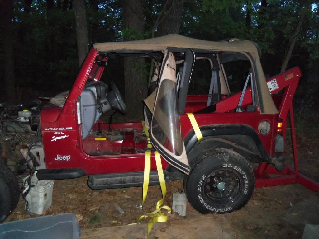

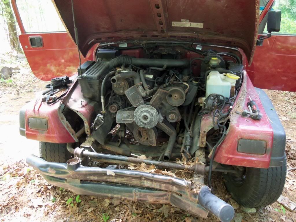

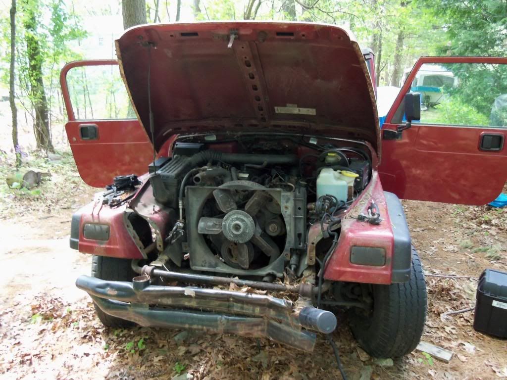

It's been a long a$$ time since I've worked on the jeep but I have some updates! I removed the radiator along with the wiring harness for the headlights. Also began labeling the copious amounts of wires under the hood. After I pick up my new (to me) engine hoist later today I'll continue ripping stuff apart and labeling it. Should have the tub off by tomorrow night or Wednesday.
And the most important part about today was that I finally freed up the tub mounts. I'm so glad they didn't have to be cut out...yet. Debating whether or not to replace the tub.

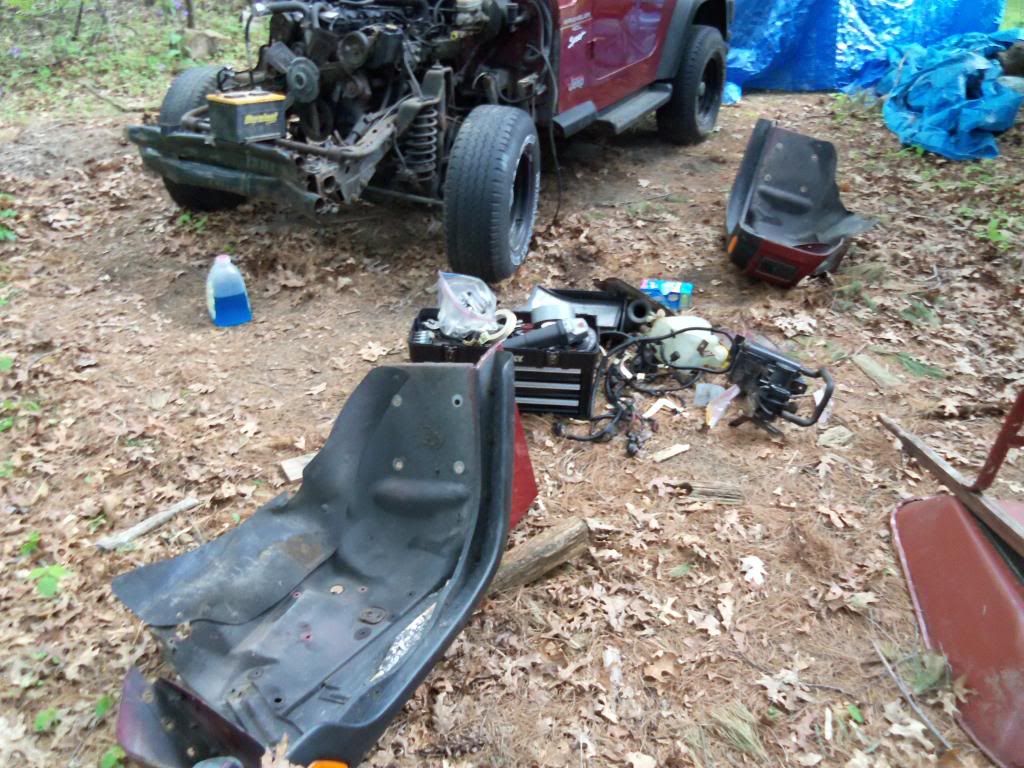

post #66 of 100 Old 05-14-2013, 04:34 PM Thread Starter
kvesi122
Posts: 232

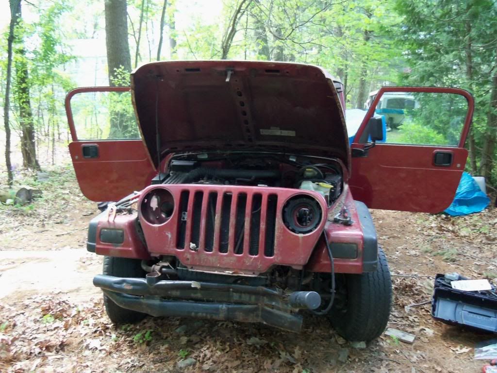

Some pics from working today:

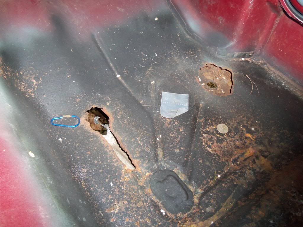

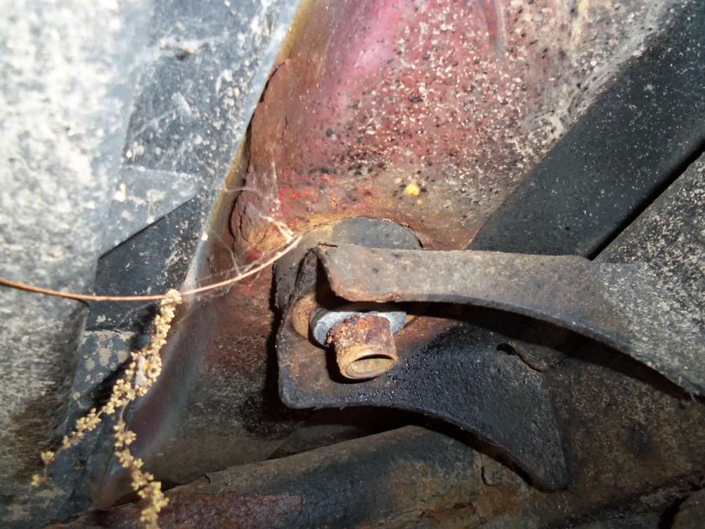

post #67 of 100 Old 05-17-2013, 02:14 PM Thread Starter
kvesi122
Posts: 232

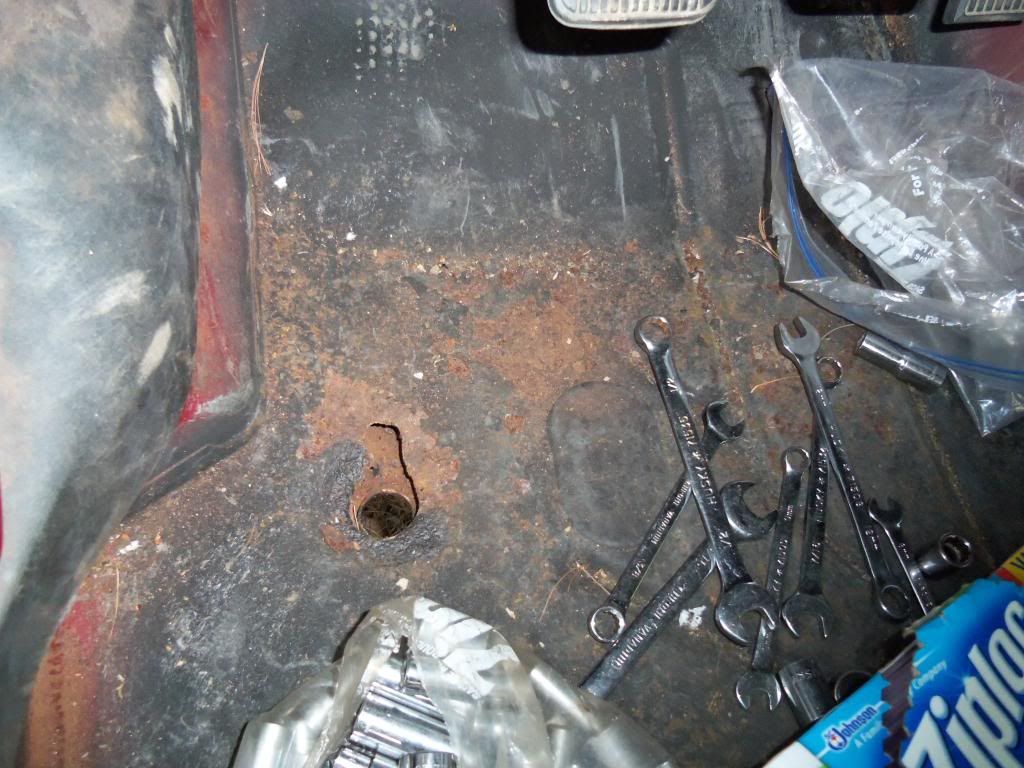

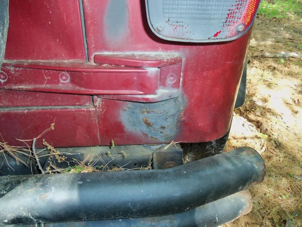

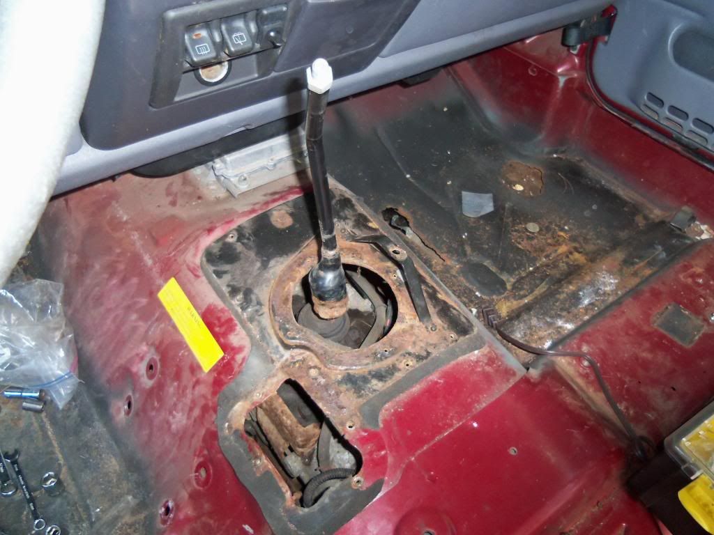

The rust...
All the shifters are removed and or out of the way.

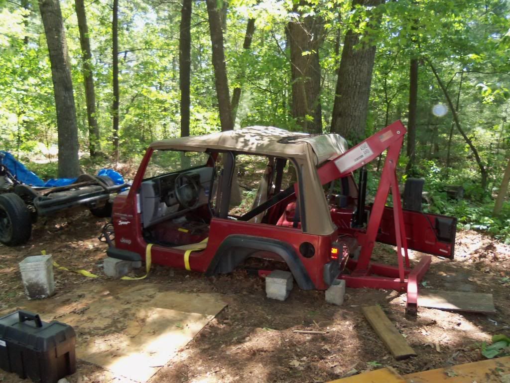

Worked on the jeep for a good 8 hrs today. One of my buddies came over and we disconnected a couple of things that were left undone and I did a pilot lift on the tub. The 2 body mounts on the rear crossmember for the coil springs were extremely hard to remove. I couldn't fit a breaker bar in there because of the gas tank and shock so I managed to get them out after a lot of swearing with a 3/8 socket wrench and a 6 inch extension. Rust is slowing down every process.
kvesi122 is offline

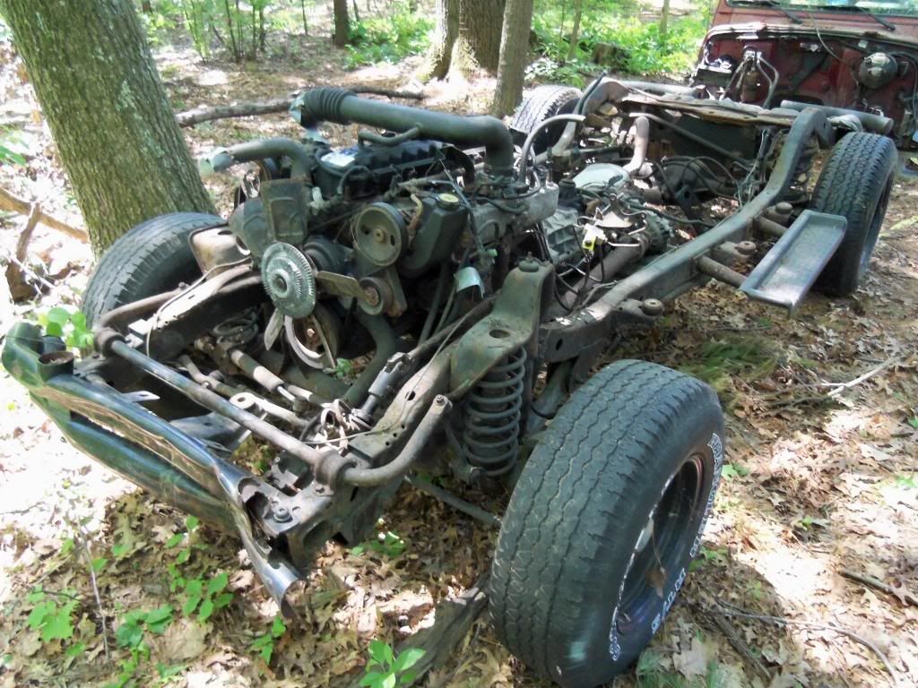

post #69 of 100 Old 05-27-2013, 07:46 PM Thread Starter
kvesi122
Posts: 232

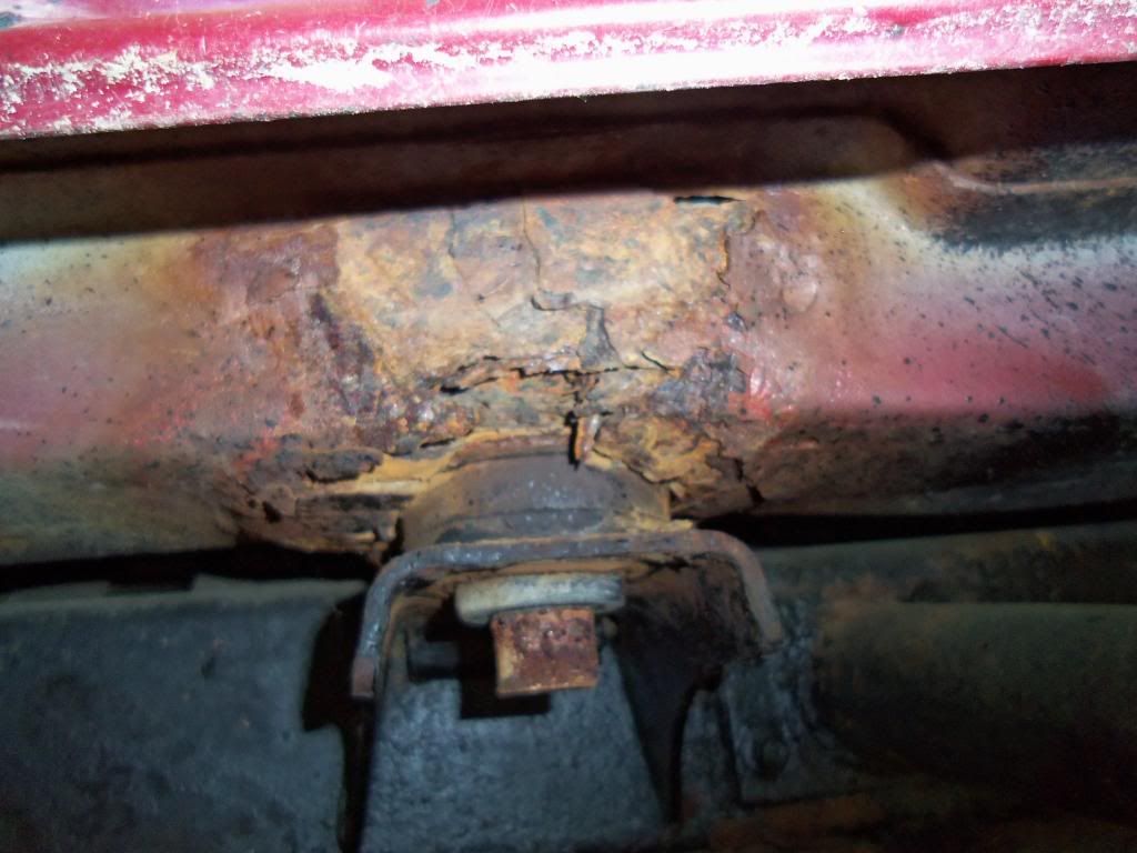

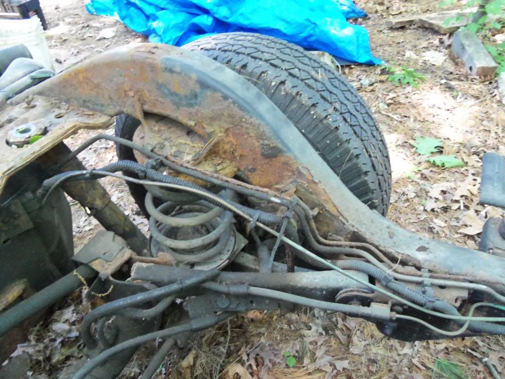

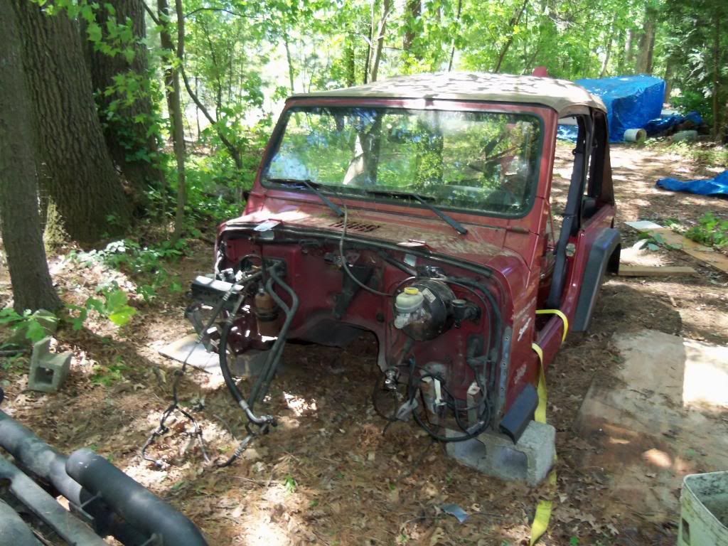

Big news!!! The tub is off. The control arms are off the rear axle and I'm disconnecting the driveshaft tomorrow.

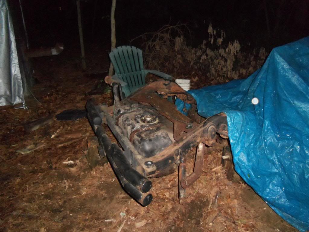

Crusty frame near control arm brackets. Still need a picture of the rips on the bottom.

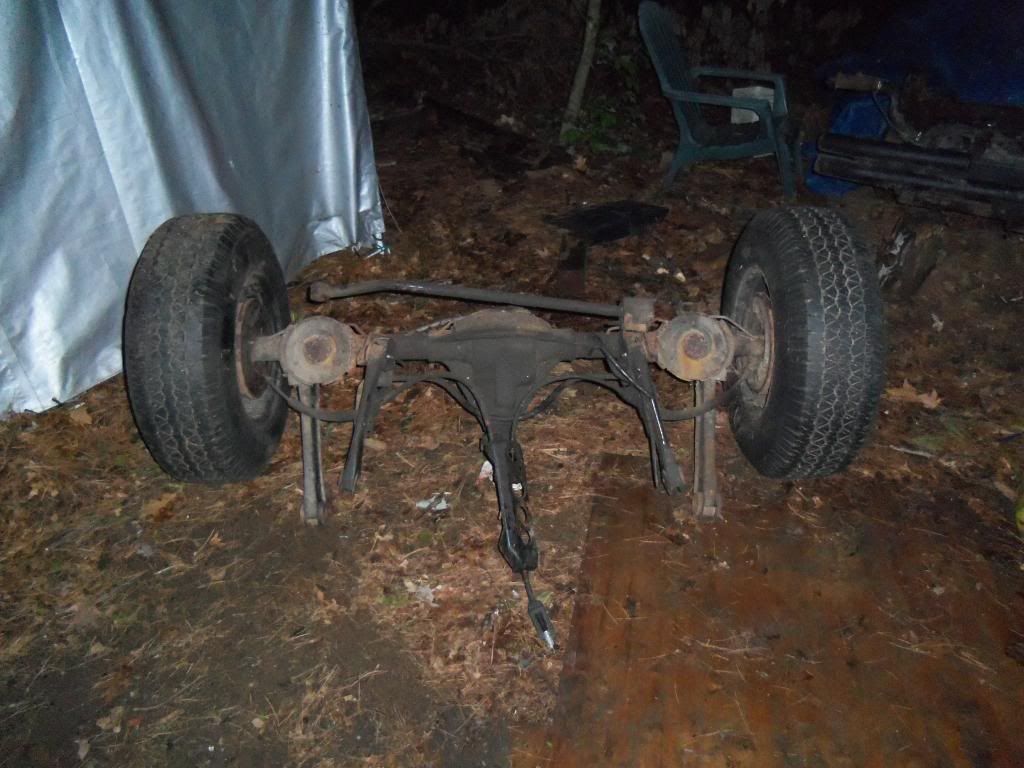

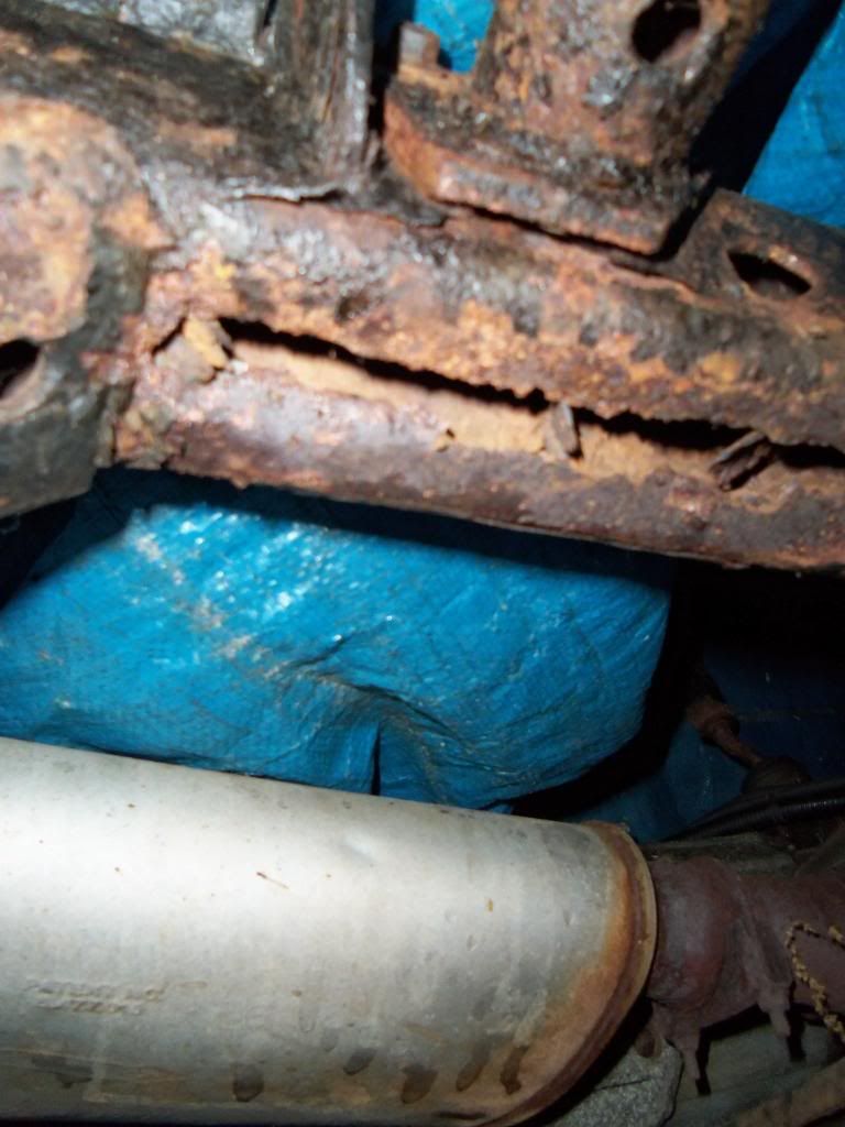

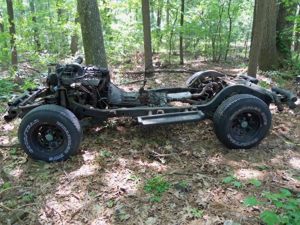

Rear axle is finally out! Took some time with a torch to heat the lower shock bolts.
The track bar bolt was the biggest PITA so far. Haven't had to cut any bolts yet but this one broke the ice. My friend came over with an oscillating cutting tool and a sawzall to cut the bolt out. Took about an hr of cutting and another half hr of pushing the axle around to pull it out.
And the obligatory frame rust picture. Get the eye bleach ready!
Back end is held up with stumps right now. Didn't want to leave any jack stands out in the rain tonight.
