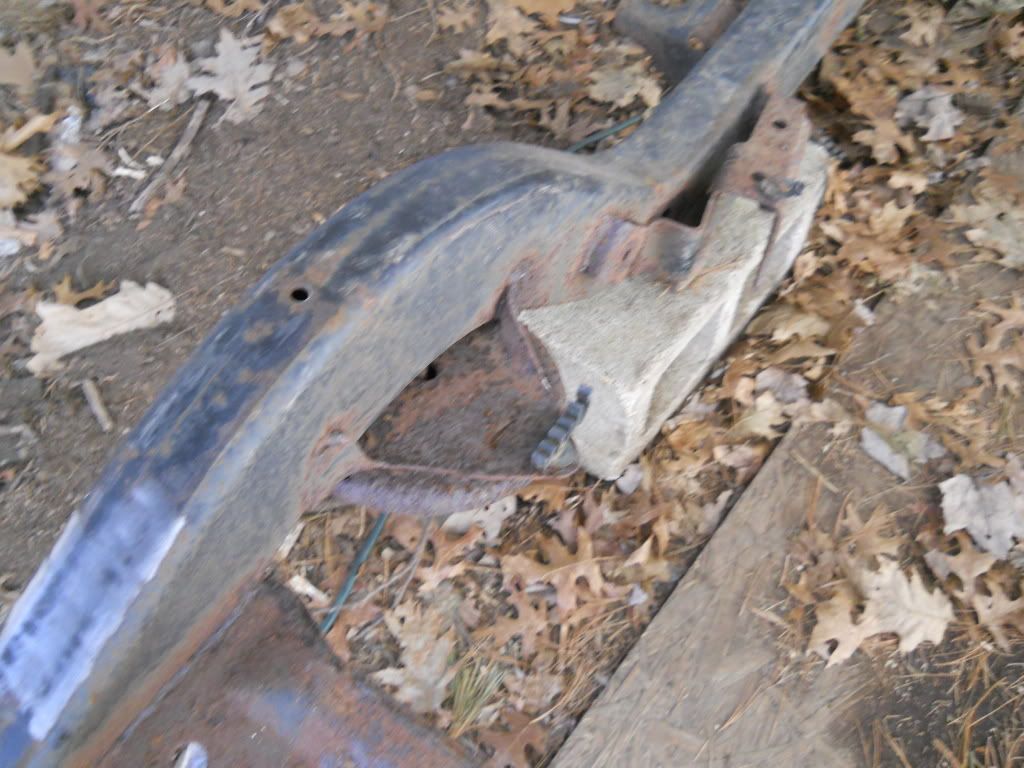

Got the compressor wired up in the basement so sandblasting the frame is happening this weekend! Finally. I ordered $160 worth of paint and cleaning stuff for the frame haha. 4 cans of eastwood internal frame paint, marine clean, metal ready, quart of por15 (already had it) and a quart of flex cote. I'll post pictures up as I go.

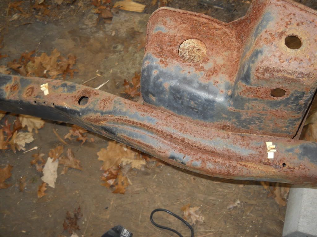

Well I was a little behind schedule but it's getting done! Here's the current work as of 4:00 today:
Before:
During:
The bottom still needs a spraying of Prep and Ready and then it goes into the garage for its POR 15 coats and Flex Cote. I have to say that Marine Clean really rips a lot of the crud right off.

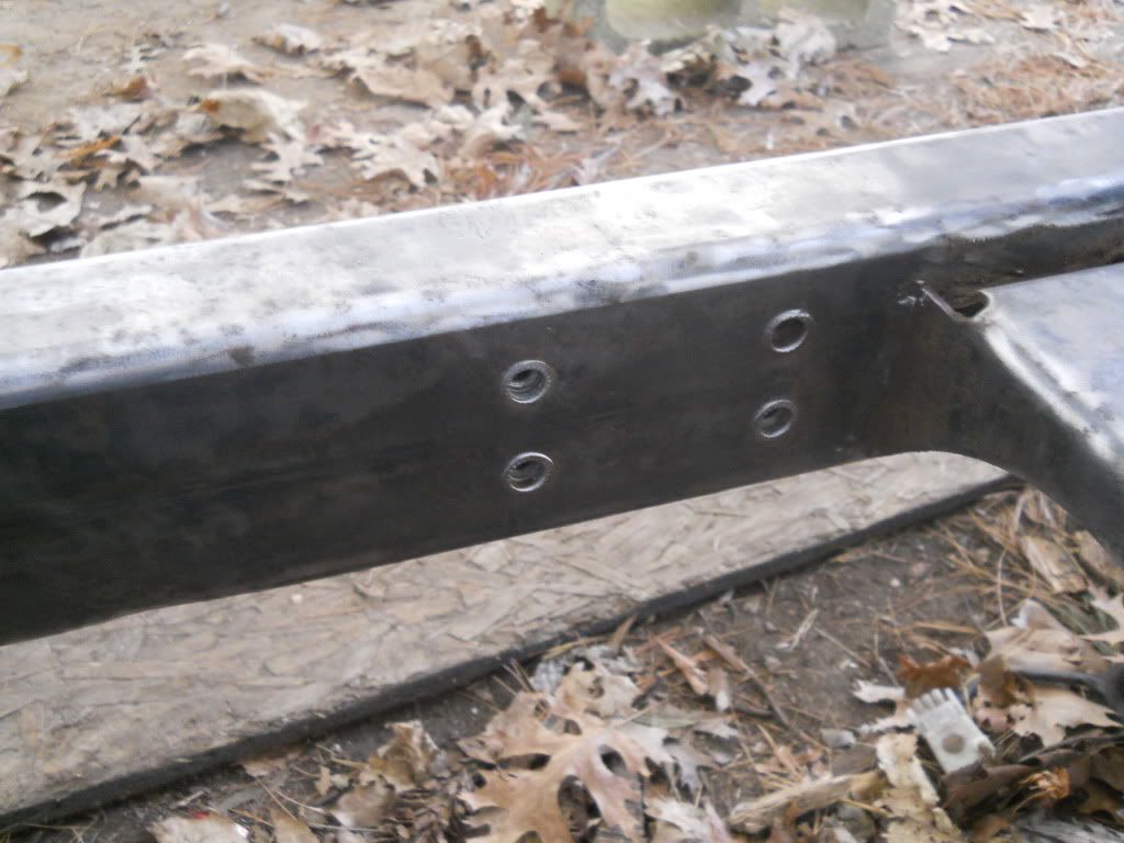

Here's the frame all finished up. Pardon the crappy cell pics, my brother took the camera back to college with him.
Took the jeep out for a little cruise today in the snow then it went into the garage so I could gut the interior.
