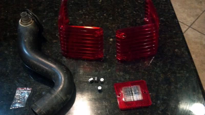

today shall be known as FSJ friday!
These were all donations from very kind FSJers to my cause.
got a set of NOS tail light lenses (holy hell, they're literally new!) a single NOS reverse lens (whish i had 2) and a lil set of jeep valve stem covers was an extra.
Also got an old fuel filler neck in perfect condition, so hopefully i can get my original fuel tank back in the truck very soon!

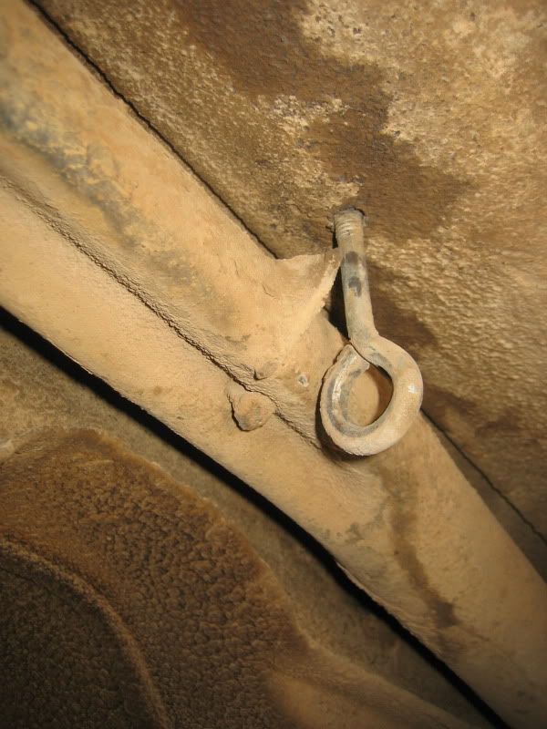

My truck had an aux tank and the original tank, original tank was removed by PO, for a dumb reason but we wont go there, and the enter system was screwed up. no breather tube, it was impossible to get a full tank, guage read wrong all the time, tank was rusty inside, etc etc, so out it comes!
I discovered that 2 of the 3 mounts were still in tact, and the 3rd mount was attached to the tank, not the truck (somebody got chop happy).
Front mount:
Rear Mount:
Missing middle mount and a random eye-bolt that was drilled through the floor?:
breather tube is still there...

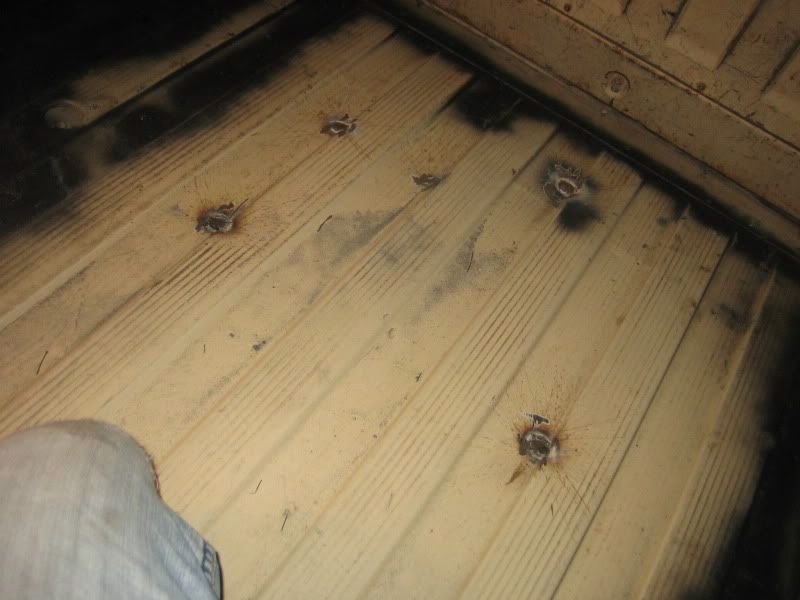

Then I had to drop the old tank, which was bolted to the BODY of the cargo area with 3 REALLY long carriage bolts. the issue here was that i couldnt turn the nuts/washers on the bottom of the tank because the carriage bolts would just spin inside the truck, and i couldn't grip them.
Well, im smarter than a 40 year old truck, so out comes the welder!
Zap zap zap!
Unbolted everything, disconnected the lines, and started lowering the tank which had about 7 gallons in it. Looked like the truck was giving birth!
got the tank part way down and saw yet another example of how brilliant one of the many PO's was. (also, as a side note ALL the "added" wiring on this truck is the same color blue. You know how much fun it is sorting that out? Musta been a sale on blue wire at the hardware store in idiotsville where the truck used to reside)
Yes, thats an electrical-tapped ALIGATOR CLIP on the sending unit...and notice how theres no ground either. I wonder if that had anything to do with why my tank never read full, only 5/8ths and used to fluctuate all the time? Sigh.
Anyway, got the tank dropped with no issue.

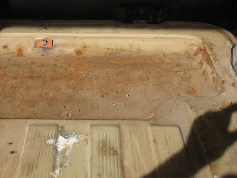

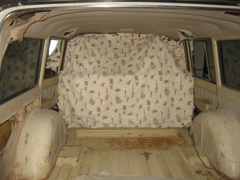

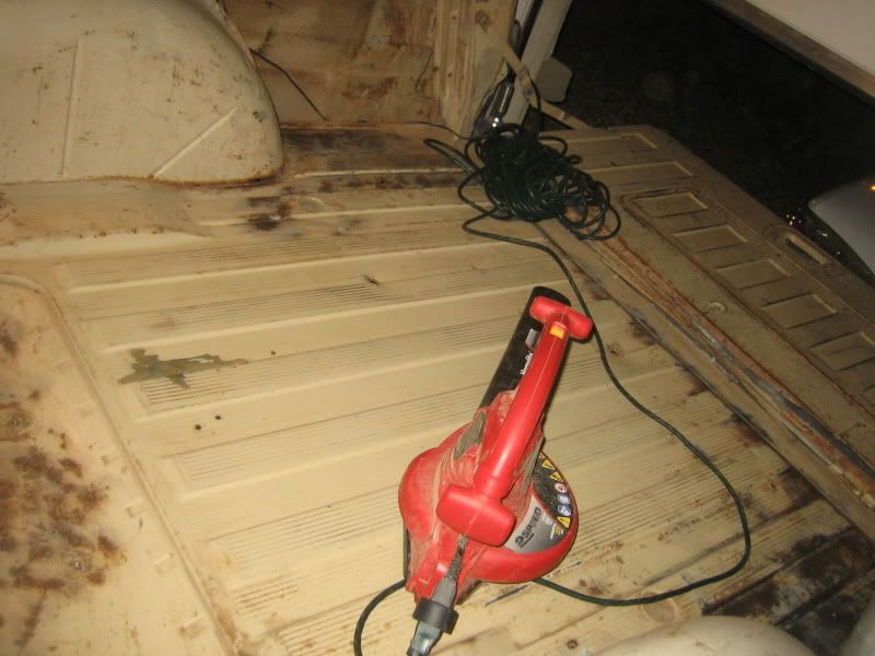

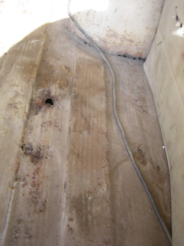

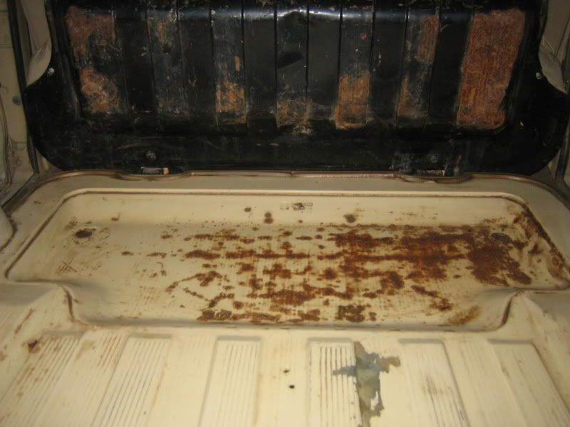

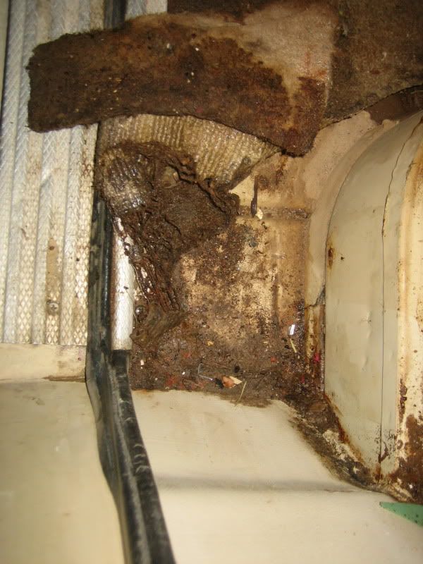

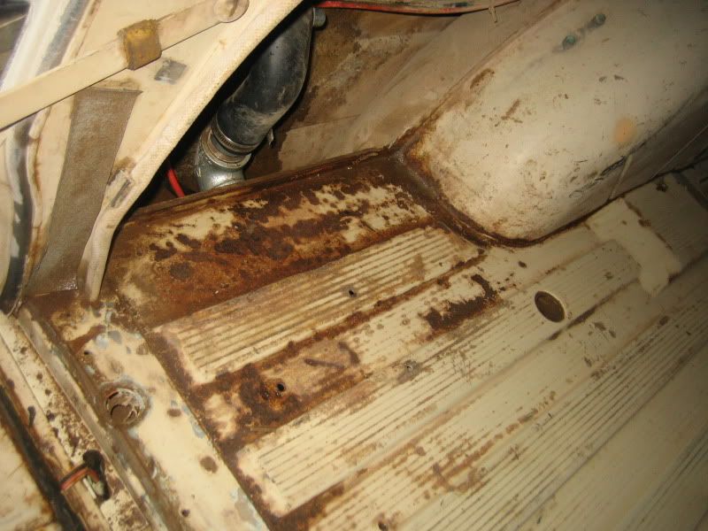

Welol, while all of that was going on, I was working in the cargo area as well.
I started by clearing out all the crap I haul around (under sized spare tire, oldschool lift jack that doesnt fit anywhere on the truck, rendering the already useless tire even more useless, a tool box that weighs like 80 pounds when empty, a 30 dollar tool set from harborfrieght that i dont care if it gets stolen and has saved my butt more than once, a bunch of cardboard so i dont leak all over nature when wheeling in the desert, and a myriad of bottles of vehicular fluids that require constant topping off.
I got a good look at the condition of the rubber floor mat.
I unbolted the trim back there, took out whatever that random bracket on the left was (spare tire?) and took out about 12 other screws and bolts that went to nothing and pulled the rubber out. It was pretty much trashed as you can see

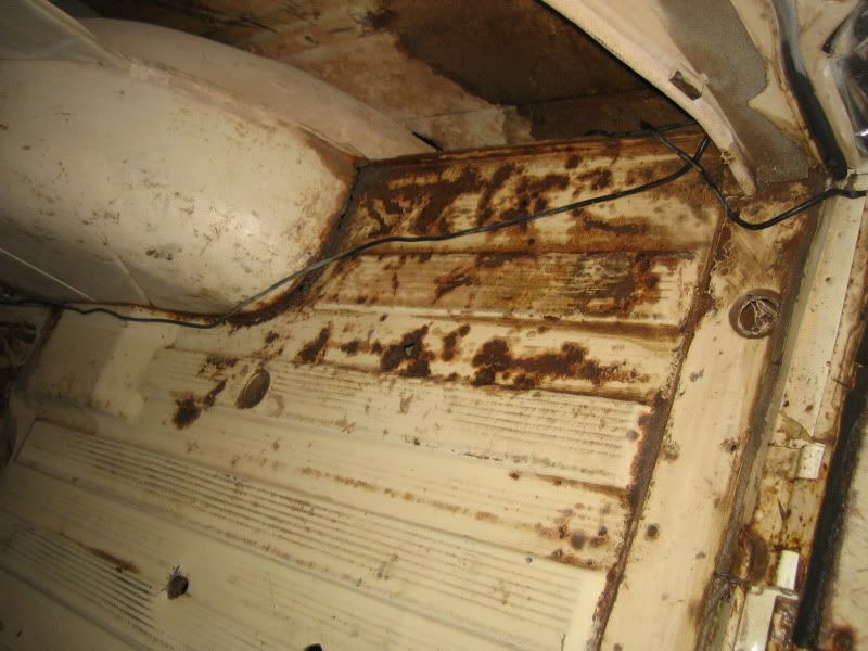

Now, even though its a desert/california truck, this was a little scary to do. A little moisture can do alot of damage after 40 years....i braced myself.
phew, not bad at all. I knew those holes on the right side existed, and knew it was a lil crunch over there. These are the only holes through the body, there is also a hole in the fender on the outside right there, guess this corner used to get more wet or something There are a few small holes, a few pinholes, and then a bunch of surface crap.
Other side had more surface rust than expected, but its not bad.
Up under the seat (read low point) wasnt too bad either.

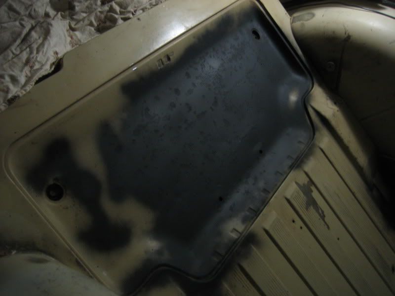

After doing all the gas tank stuff, I went and hosed out the interior, and wiped it down with a cloth to get all the MUD out. Please note that desert vehicles that accumulate 40 years of dust become very muddy when they get wet inside.
better look at the rusty areas
The plan back here is simple. I'm gonna bed line it i na desert tank, then decide whether or not to put any carpet or rubber back in. I'm going to start tomorrow by wire wheeling the whole area and getting the rust down to nothing, then spraying on some "rust converter" or something, then I'll just go over the top of it. I'm not very worried about the structural integrity of it, its pretty dern solid.
I'm going to also make new side panels out of thin plywood, and bed line those as well, and bed line the wheel wells, and bed line under the seat area. Should make it nice and easy to clean up whenever I want to jsut hose it out, and clean it up alot back there aesthetically.
This is where I need some advice. Does anybody have a good brand of roll on bedliner? I've used herculiner, but it doesnt come in a tan, and the only other thing I know is gonna be Monstaliner. Suggestions?

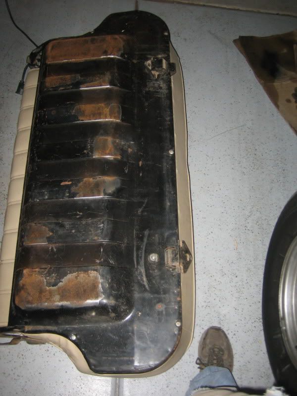

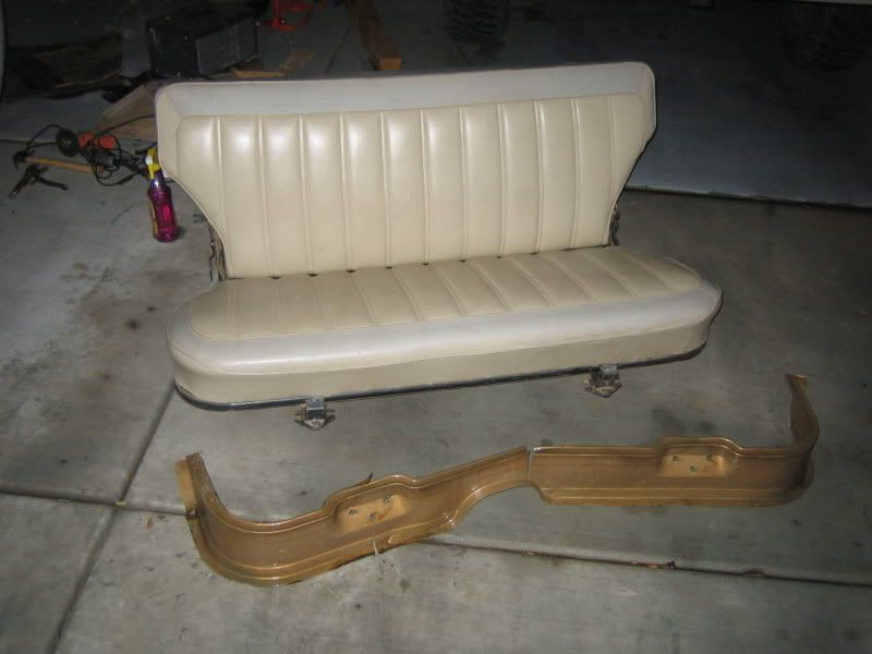

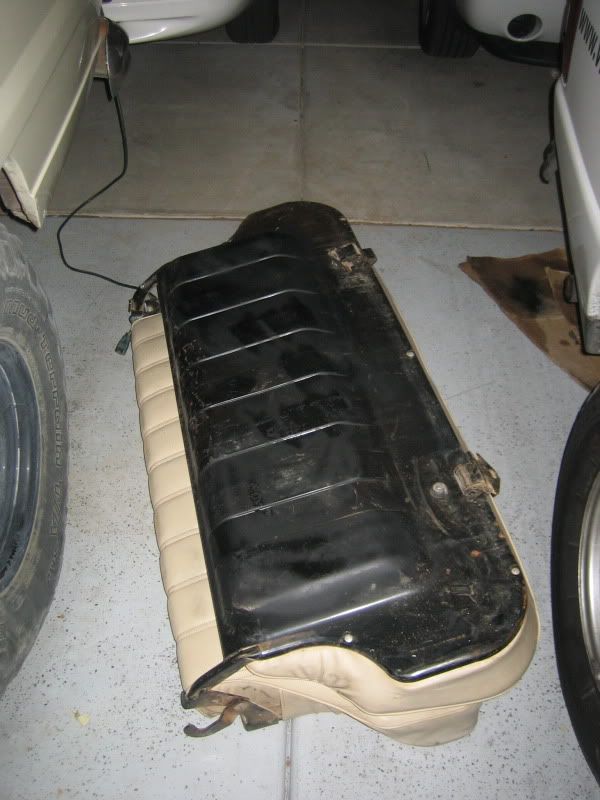

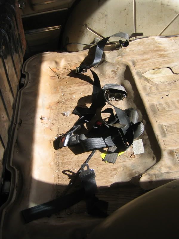

Anyway, i continued on and removed the rear seat, and the plastic edging or whatever.
I also checked my inner corners...nasty and gross but no rust and its solid!

So, all that out of the way, I wanted to start something I could actually finish.

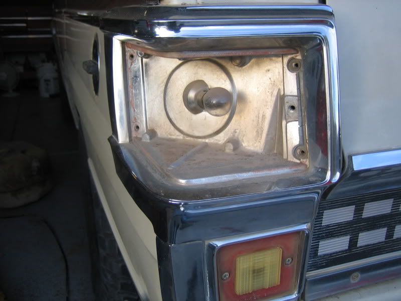

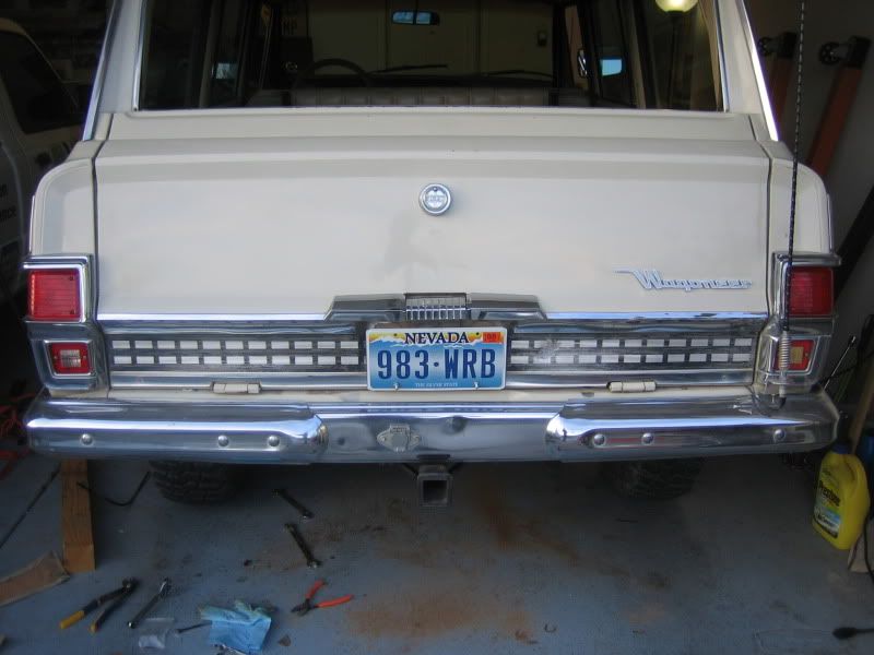

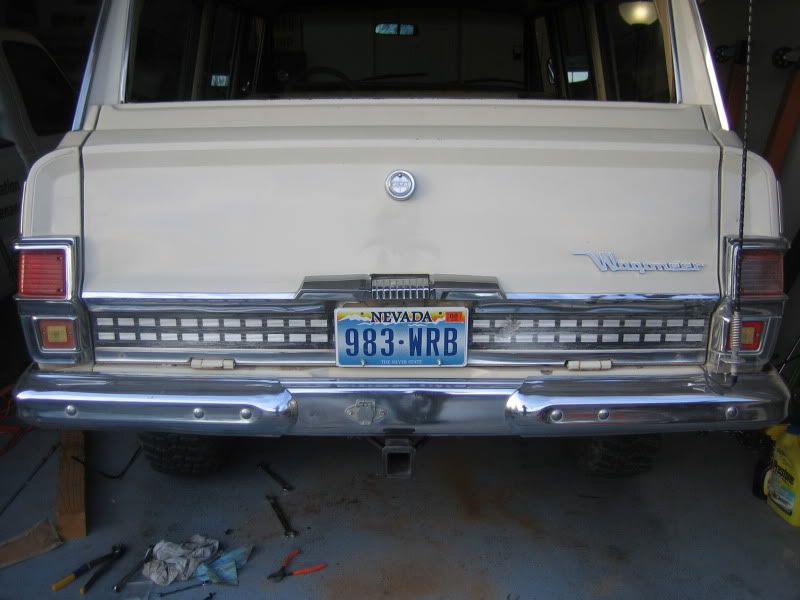

A member here hooked me up with a set of NOS tail light lenses to replace my old faded ones. Not only were they faded, but they had this dark red tape inside them maybe to bring back the red....but all they served to do was make the already dim-arsed lights even harder to see....especially in the day.
the right side was the bad side...but the right side reverse lenses is better than the left?
old next to NOS.
I also figured that my light bulbs being half covered in dust and the inability of any of my chrome to "reflect" due to the same reason might also contribute to the less than stellar (ha, again, puns) brightness of my lights.
old on the right new on the left
old reverse lens next to the new.
got em all in...
If anybody has another set of reverse lenses that they are willing to sell, please contact me. I only had one NOS one, and need to replace the other side, or both of them with lenses in similar condition.
Thanks!
Oh look how pretty, its like christmas again!

Set up a little shield to keep the upcoming dust and debris out of the main part of the cab.
Spent some time with a wire wheel and a grinder, got all the rust ground down.
then hit it with prep all to clean it down, and then sprayed it with some rust converter stuff. I dunno if it actually works, but I've used it in the past on bumpers and stuff back in NH and it never rusted anymore than it was already, so, might as well, right?
Spray spray spray!
Then as I was laying around on my creeper under the jeep, hiding from my woman even though I was done, the gaping holes started to bother me seeing all the light coming down through the floor, so I came up with a bad idea.
I grabbed the welder and filed the holes with just the wire....meh, not the best way to do it but it'll work. I then ground everything down and smoothed it out a "bit" but dont really care too much since there will be some good thick bed liner going down in there.
Anyway, thats where i got tonight, i didnt get to work on it all day because we had prior engagements.
