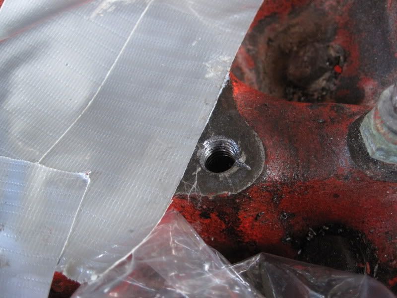

Jeep is still down for the count, gonna try to drill out and tap the manifold tonight. if I fail....I'll be selling it.
Sell it to me...I'll drill it out and then helicoil it.
It isn't like you're talking about a manifold bolt or something...Or you could try starting with a small drill bit and stepping it up one size at a time until you can just pretty much scrape out the left overs...then chase the threads with a tap and clean them up.
I wouldn't hesitate to helicoil this either since it isn't a crazy torque on the bolt...I wouldn't helicoil a bolt holding the heads on.

I just tapped it one size larger. From 5/16ths to 3/8ths.

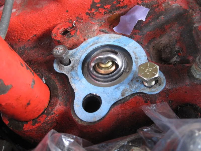

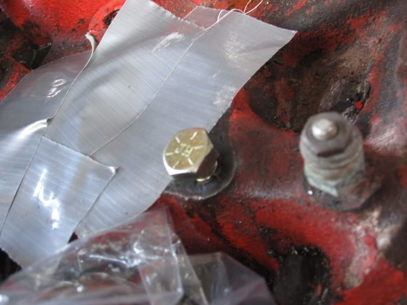

The offending bolt:
First time I've ever tapped anything...scary...but...TADA!
It threads all the way in to the bottom of the cut I made with just my fingers, nice and smooth. I just made sure to take my time, every step forward I took, I took a step back, and just went slooooow.
I just need to bore out the hole in the housing so i can fit the new fatter bolt through it...and pick up a replacement for the other bolt...i dont trust those old ones anymore, haha.

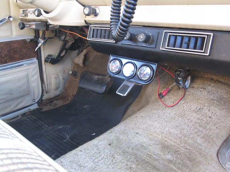

So, before I busted off that bolt, i took it shooting...
and installed a CB...
and installed some gauges (this is why I broke that damn T-stat bolt...temp guage)

Good job, you tapped it correctly if you kept backing it out to clean the threads...
Otherwise the shavings can muck up your fresh threads before you even get a bolt in there.
