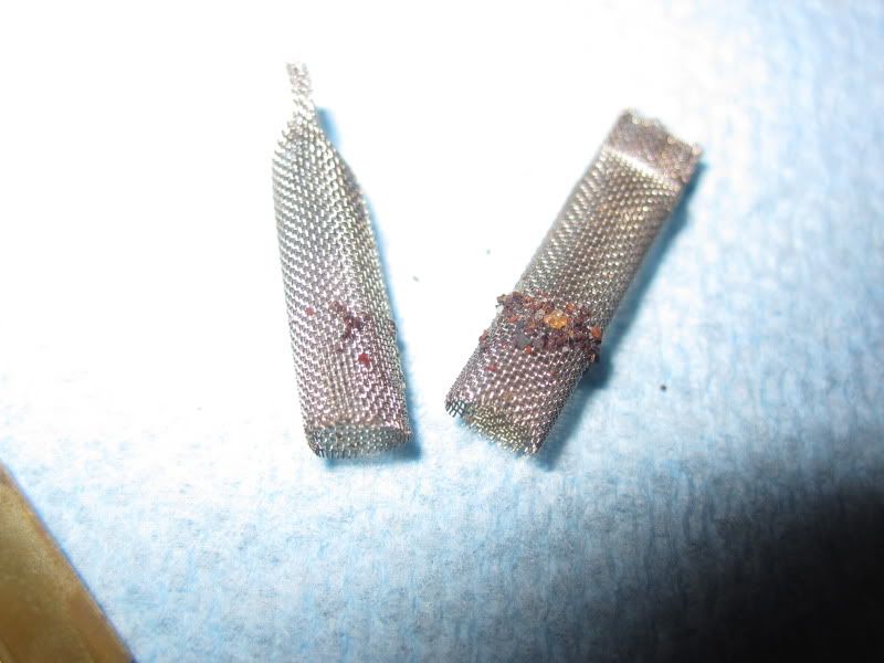

I started the truck up fine this morning, it ran and ran and ran, nice and smooth, not missing or anything. I let it get up to temp and was revving it and it showed NO signs of any issues.
Then i took it around the block and it started doing the stuff as listed above right when i got back to my driveway, and it stalled out in my garage. I opened the throttle under the hood, and white vapor was coming out, slowly.
So I pulled the airhorn, fiddled with the floats and noticed one of the needles wasnt falling freely when the float was in the down position...pulled it and noticed a few specs of sediment on it or something, figured that was strange...

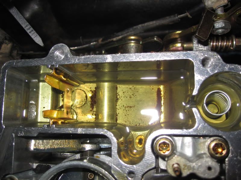

I set down the airhorn and looked into the body of the carb, and was kinda surprised to see this in the bowls:
Uh, what the hell? Where did all that come from! I have a fuel filter less than 2' from the carb.

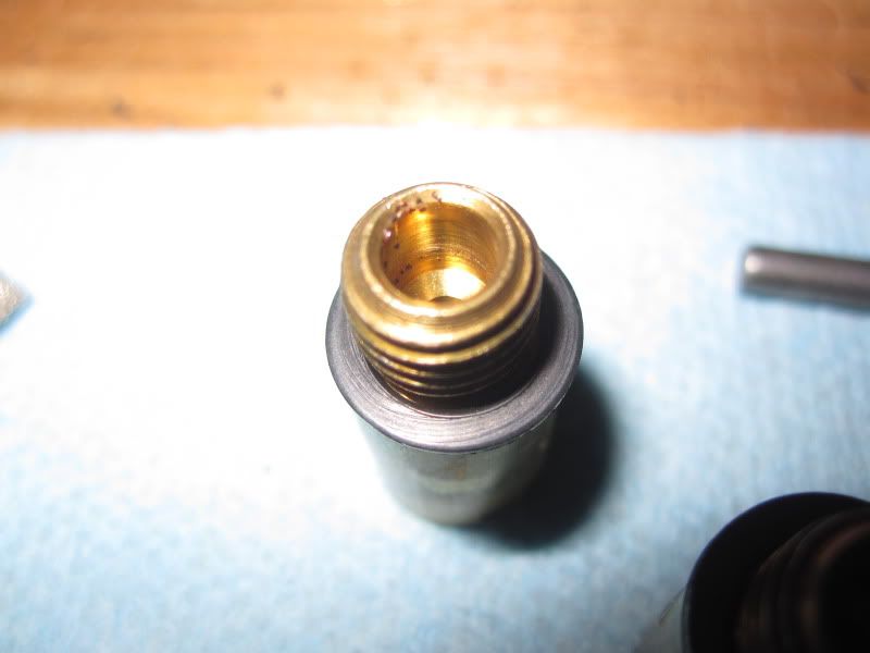

I pulled the needles and seats and found sediment in the top of the seat...
Pulled the little filters on the top of the seats...
holy crap! How did so much stuff get through?
there's even crap inside my fuel filter.
The filter was either not catching anything, or it was coming from the line after the filter...or it was already inside my brand new carb. It looks like rust or something? But i dont know how it would get from the tank into the carb with a filter....
Anyway, i took it all the way down and cleaned it. cleaned all the passages, venturies, etc. There was a buncha the sediment in the secondaries, i dont know why there was more back there but still.
I'm not sure if this could have caused or been a leading cause of the issues above...but its definitely strange and not good.
Whats next? Get some good gas into it, do new rubber fuel lines (from pump to carb), new fuel filter, and see what happens? I'm working on getting the parts to put the OEM gas tank back in.

Hi, all that crud in the carb is typical of what ethanol gas does to fuel systems, most likely it's from your fuel line. It also causes what is called "white rust". White rust looks white and is crusty like rust. When I had my Streetrod NSRA inspected the guys inspecting it asked how much rubber fuel line I had in it, they then told me ethanol rots the fuel line from the inside out. Try putting a fuel filter as close to the carb as possible. Good luck and I'll be following this thread.

Yeah, I plan on picking up new fuel lines, but that looks like rust to me, from the tank, not really like deteriorated lines.
Immediate plans are to put a filter down by the tank, and to put a new filter (not a POS glass one that apparently wasnt filtering) as close to the carb as possible.
Perhaps the wonderful mountain gas broke loose a bunch of crap in the gas tank. This could also explain why it wasnt getting any gas to the carb when on an incline, if some of the fuel pickups in the tank are clogged, i'd imagine that could do it.
