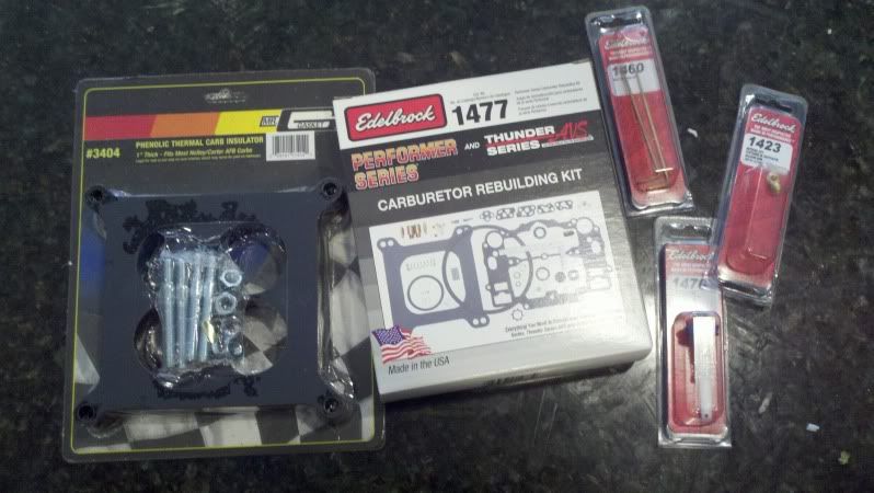

Jusr ordered a boat load of carb parts to get the ball rolling on emissions...at least to make sure the CARB isnt the issue. I need to open it up anyway to check what jets its running and figure a rebuild and cleaning will do it some good. Also because my choke sticks open once its warm, so it starts hard the next day.
Ordered:
Complete Rebuilt kit
New accelerator pump
stock size jets and rods (Need the stock ones to have the full range of calibration offered by my calibration kit)
1" Phenolic spacer
Spacer gaskets
Should be a fun weekend project, picked up this book:
I'll try and get good step by step pictures for reference. Should be fairly simple.
FWIW the Edelbrock carbs are nearly identical to the old GM Rochester carbs. I have years of experience with those. At my altitude I had the best luck with about a 20-point spread between the jet size and the metering rod size. EG jets would be #54 and metering rods were the early #74 style.
At your altitude you would want to tighten that up a bit to an 18-point spread. When I lived in Salt Lake UT I used a # 52 jet and the #74 rods. The lower the number, the tighter the jet (leaner) for the same size of rod. The metering rods are opposite: The bigger the number, the bigger the rod diameter (also leaner for the same size of jet.)
You can get a stiffer shot of gas out of the accelerator pump if you stick a washer under the *upper* spring, where it rests against the carb top.
Also, the angled brass floats are better if you can find one. Make sure the level is correct, and use a fresh needle and seat.
Choke: If it sticks open after cooling, my experience is that its usually gummed up or binding in the internal linkage. There's a little rod with a certain kink in it that works the choke and sometimes it can get hung up. If you have the electric/bi-metal choke then its fairly easy to just get a fresh one. The best chokes I ever used were just a little bi-metal "doghouse" bolted to the top of the intake (pre-1974 style)
If you need to know any more, just ask.
