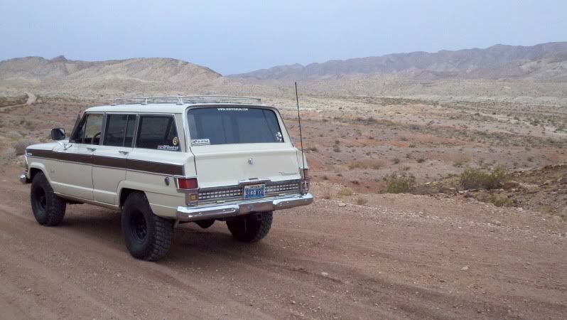

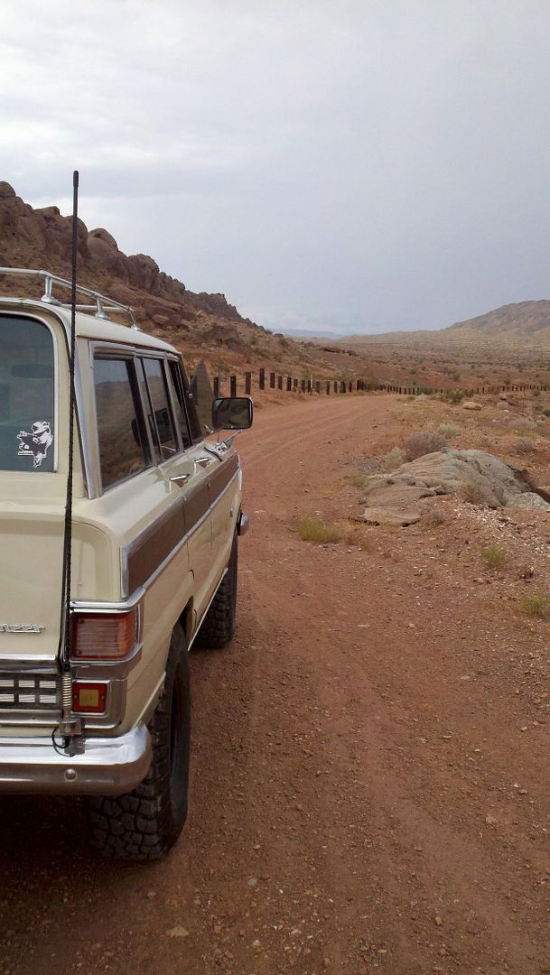

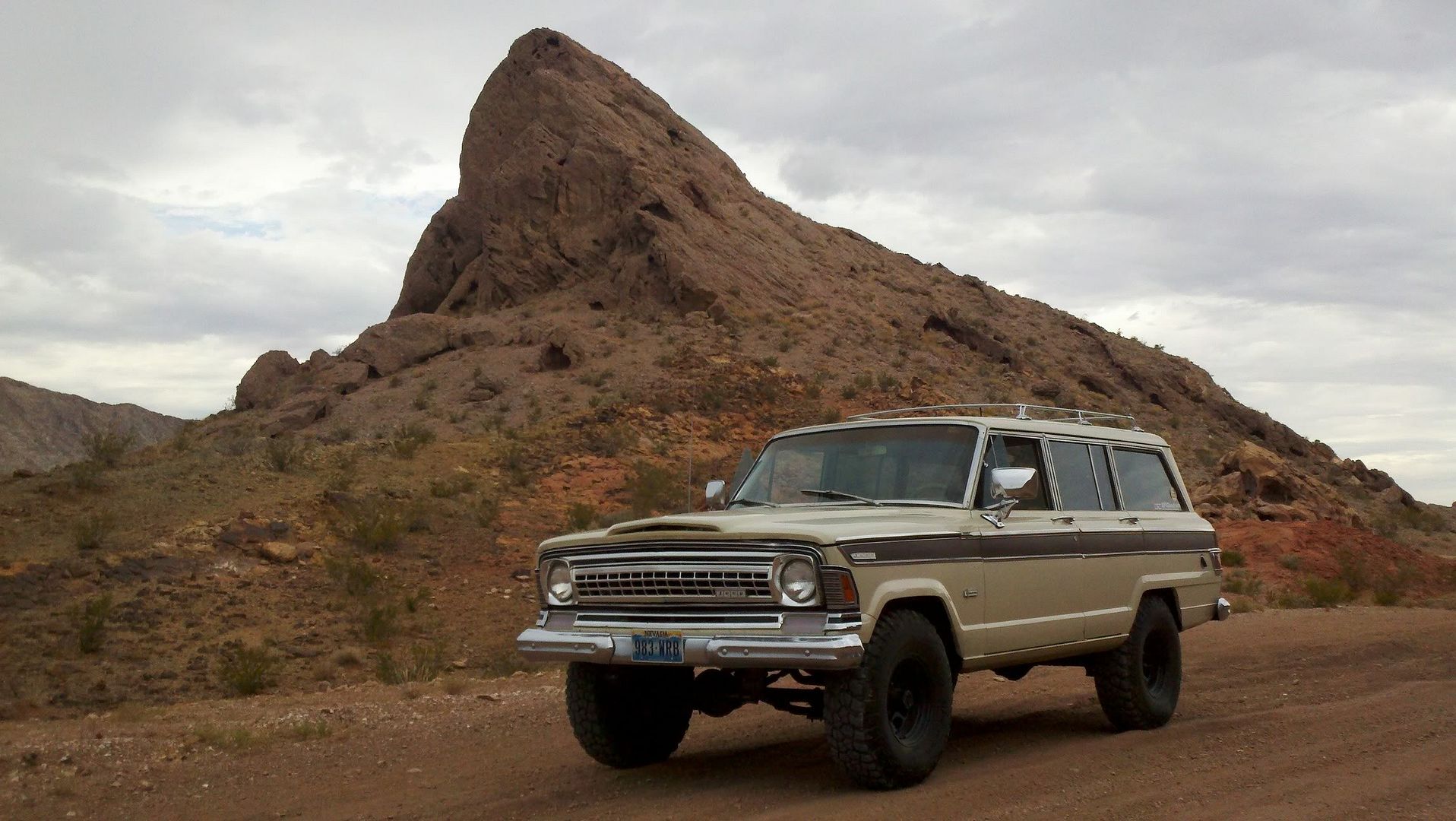

I was going out to try to smog the jeep with my retarded timing and after getting it heated up, but the smog station was closed, so I took the jeep and my girl on a little ride, out to the Kodachrome area. Real pretty colors out there. Maybe thats why its called Kodachrome?
Snapped 1 decent pic with my cell, and just thought I'd share.
A few others that are not as good. It started raining so I figured I better go home, seeing as i drove through like 5 washes.
