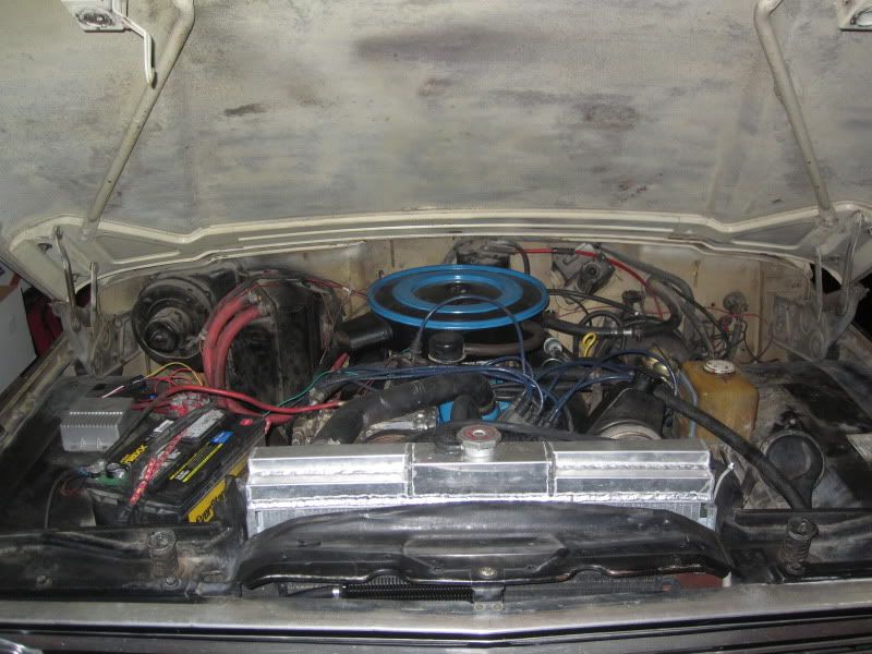

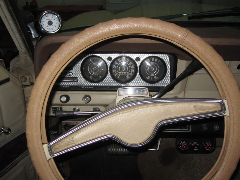

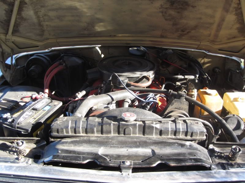

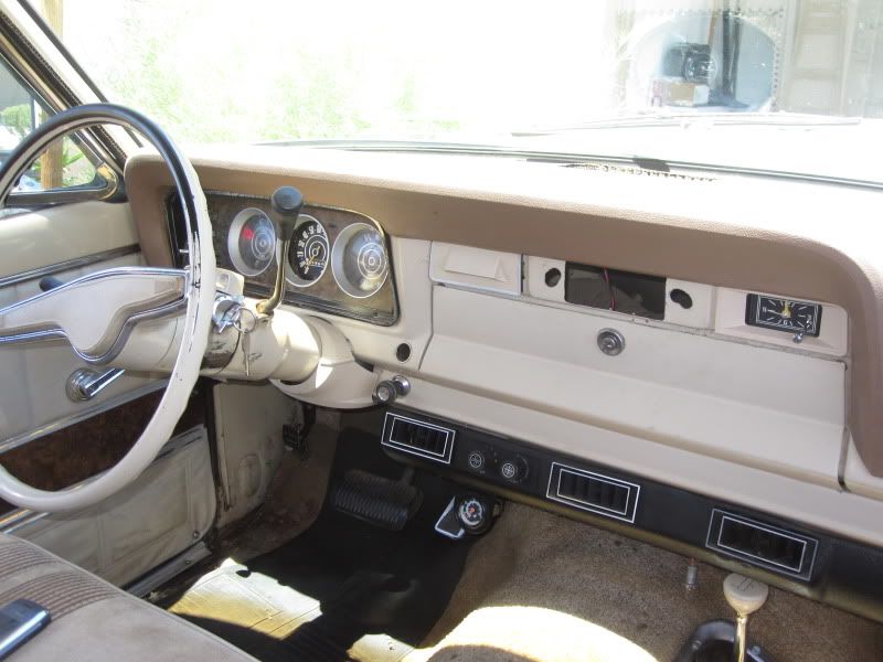

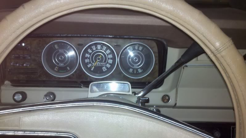

Well, it's been almost 11 months since I picked up the beast, so I figured it's time for a little then vs. now...
I've come quite a ways, it seems, even though at times it felt like i was pedaling backwards.
Then....the day I bought it...
Now:
Then:
now:
Then:
Now:
Sigh, I'm starting to realize how many hours and dollars I've put into this truck, not to mention how many bumps, bruises, cuts, curse words, and whatnot as well...but I suppose there have been smiles as well.

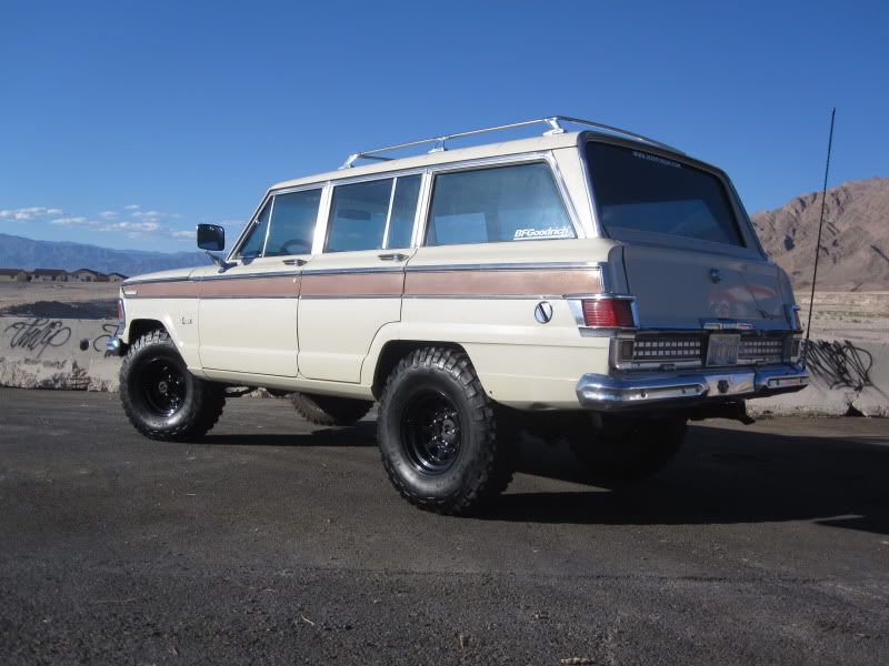

post #552 of 1819 Old 05-09-2011, 10:53 PM Thread Starter
Marn
Station Wagoneer
Marn's Avatar
1973 FSJ Wagoneer
Location: Reno, NV
Posts: 11,307
that side shot was tire shined like 2 weeks prior.
it DOES pop with shiny tires though....but this is before the refnished paint and the wood grain.
-Andrew
