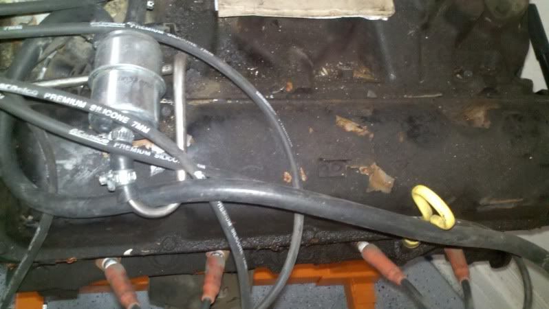

Also made some progress on the engine this past weekend, even though it was very minor.
As you all know, I'm not planning to dig into this engine at all really, just wanna drop it in and rebuild my old motor.

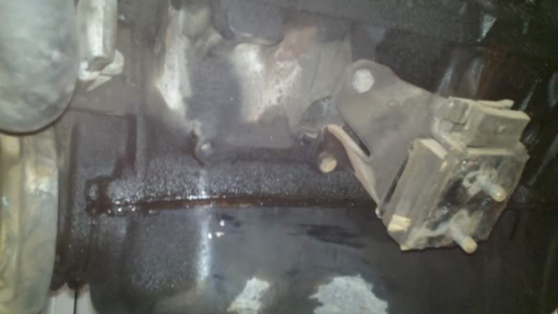

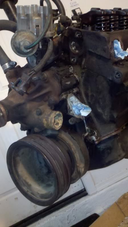

The valve covers apparently were sealed by a blind man....so the whole engine is covered with oil that dripped from the top down. I started to clean it off.
Before....gross. Literally about 1/4" of caked on oil and crap in some spots.
Got 1 corner cleaned up, more or less.
gonna get the other side tonight, and do the valve covers/gaskets. Might do the oil pan gasket if it's arrived at autozone.
I'm contemplating repainting the thing while i have it out, but I'm not sure if I will. We'll see how clean I can get it.
Lastly, I'll report more on the condition of the engine when i pull the valve covers, but i think my oil smelled a bit like gas (fuel pump issue) and a few of the spark plugs were oily when i pulled them out.
It's probably getting old and worn out, but i was told it ran well and didnt noticably burn any oil or smoke or anything, so, some blow by doesn't worry me TOO much right now.

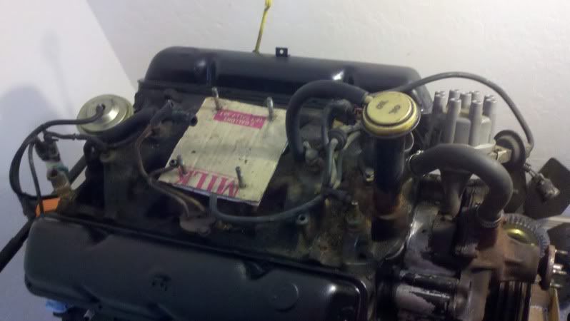

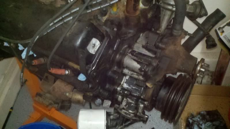

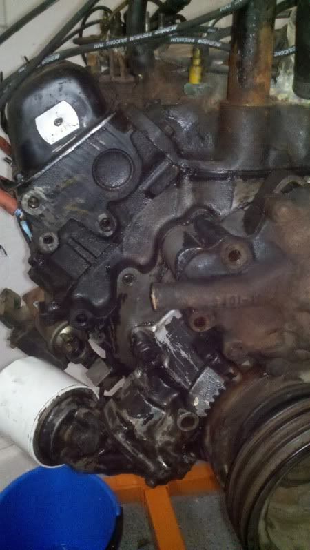

Did the other front side of the engine tonight after work. Lots and Lots of degreaser, with lots and lots of paper towels.
Pulled the fuel pump (as you can see above), because my oil smelled a little gassy. Figured 23 bucks aint much to pay for peace of mind. While holding my finger over the inlet side, I could still pump the old one by hand, the new one seals up tight and wont let me pump it. Good! That'll go back on soon.
Poked at the timing chain and didnt feel much slop...Watched the rotor while I turned the harmonic balancer. Only about 5 degrees of reverse slack in the chain, which apparently isnt a bad thing. Guess it was probably swapped out at some point...

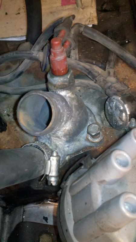

Cleaned up the t-stat housing quite a bit. I may just end up using the one from my old motor, because this one was ROUGH. I had to sand down alot of corrosion, and I'm not sure how well it'll seal. You can see the before shot in the above post. Also ran the bottom over some 400 grit to smooth it out and make a better mating surface.

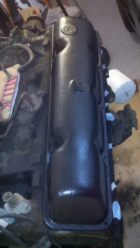

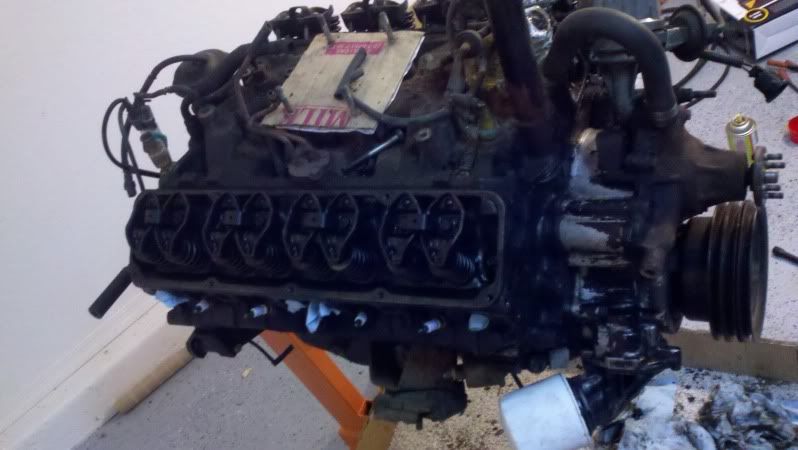

Lastly, I pulled both valve covered, and cleaned off all the old gasket. Whoever worked on this thing before me was in love with silicone RTV. It's everywhere. On both sides of rubber and paper gaskets, all inside the thermostat, etc. This thing didnt seal worth a crap! I'll fix that.
Inspected all the rockers and bridges, everything was good and tight, no play in the rockers, and everything was clean, no sludge. Looks like it was kinda sorta cared for.
Anyway, cleaned all the caked on oil off of the valve covers too. I had some krylon wrinkle finish sitting around, and gave them a fresh coat of paint. Apparently wrinkle finish loses its ability to wrinkle after having sat around for a few years. I just did a few final dustings to give it some texture. Starting to look cleaner every day.

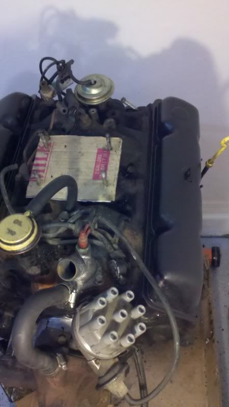

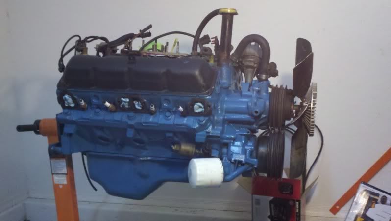

Before...
After
I havent painted the intake manifold yet, because its in such gross shape (rusty, dusty, oily, flaky, cakey, etc). Hopefully tomorrow or the next day I'll have the ambition to tackle that. So the oil fill tube and everything wil be painted eventually. Maybe that should be black as well, might look nice.
I think I like having the valve covers black.
It doesnt look too bad....i mean, its a textured metal surface with crust and rust and flakes under it, but its probably the worst paintjob I've ever done on anything. It'll look good under a hood though.
Oh and..I think it's a chevy blue or something. It looks way different blue in the pic than it really is, but I got the closest to amc blue I could find. Or, well, the closest to the google image search results for "amc blue"

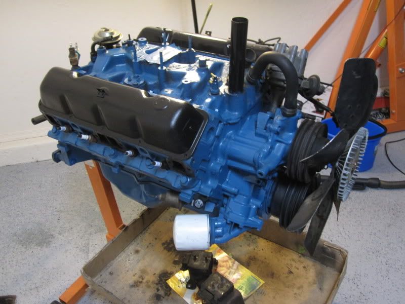

almost there....
now...to paint up the air cleaner to match!

Motor is lookin snazzy! I like that color combo. A chrome air cleaner would really look good

I've got an edelbrock pro-flow on the engine in the truck right now...but its a foam filter.
I'm thinking I'll just paint the stock air cleaner back to black, with some blue accents.
This motor is not nice, nor is it new...so i put absolutely minimal effort into painting it and cleaning it, but it looks about 1000x better than when I got it.
Its a super wrong blue, but i dont really car. AMC blue needs to be special ordered these days. It's just a chevy blue from auto zone. Better than "nasty oil caked black" that Chrysler provided me with.
Who the hell paints an engine black anyway? Have fun finding out if its leaking and where its leaking from.
