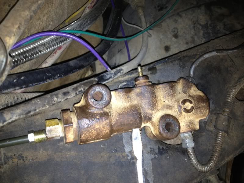

post #1511 of 1819 Old 06-17-2013, 10:39 PM Thread Starter
Marn
Station Wagoneer
Marn's Avatar
1973 FSJ Wagoneer
Location: Reno, NV
Posts: 11,311
progress!
bent all the lower lines and mocked everything up. need to cut the long 1/4" line and the short 1/4" line and re-fare.
Also need to cut and switch fittings on the lower line on the front.
I'll be welding a bolt to the frame to hold the prop valve in place, but all the "out" connections to it are mocked up.
So, after making the aforementioned line cuts/flares, i just need to mount everything thats on its way in the mail, and then make the 2 lines going from the MC to the frame. Easy peasy!

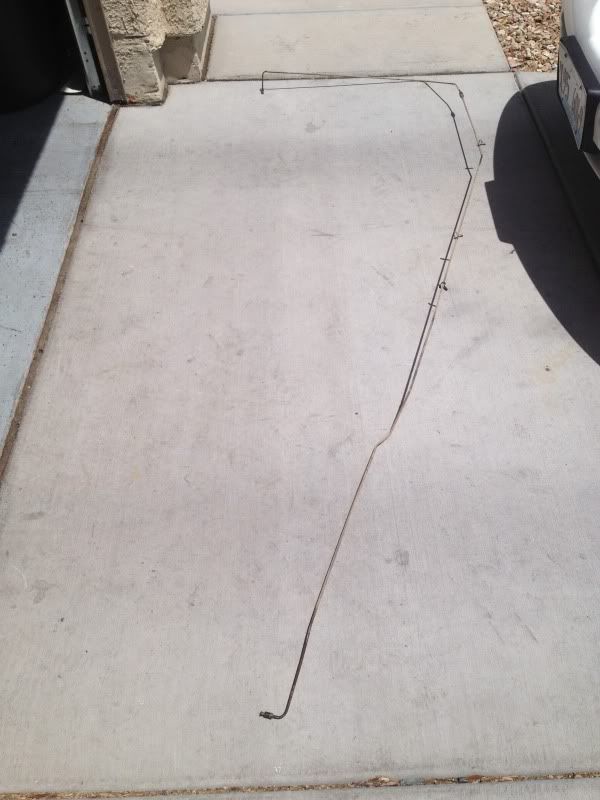

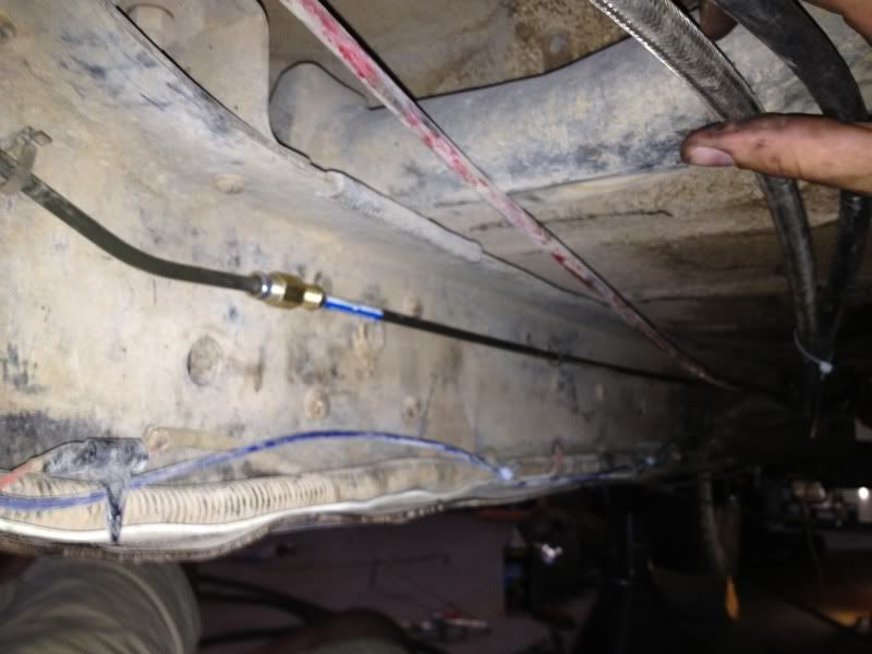

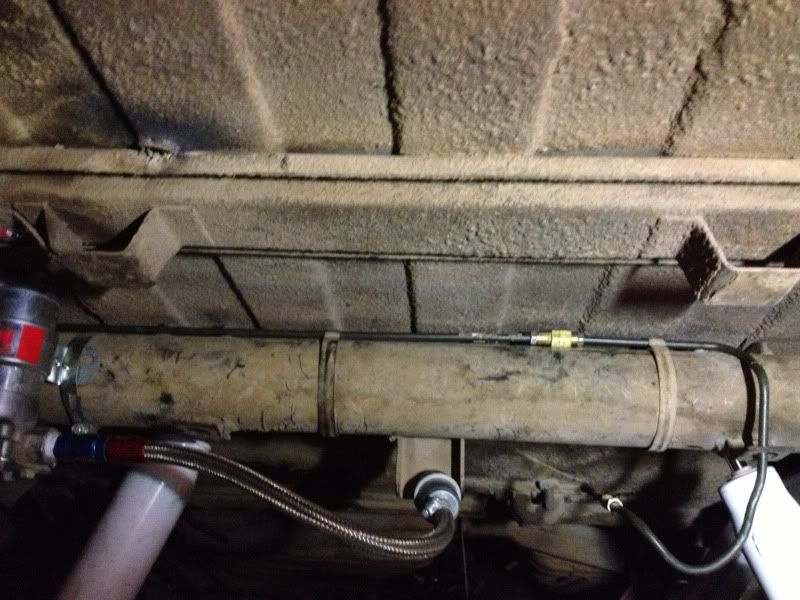

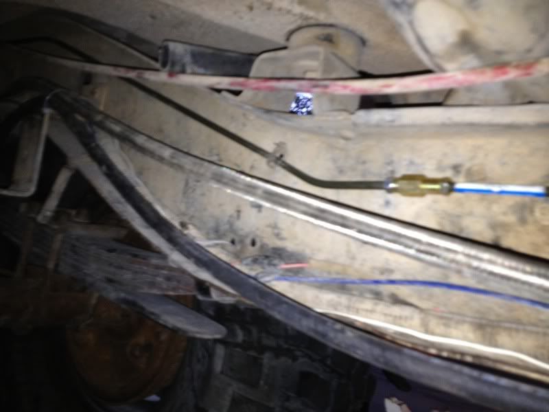

post #1515 of 1819 Old 06-20-2013, 10:55 PM Thread Starter
Marn
Station Wagoneer
Marn's Avatar
1973 FSJ Wagoneer
Location: Reno, NV
Posts: 11,311
Got one of the lines made....
