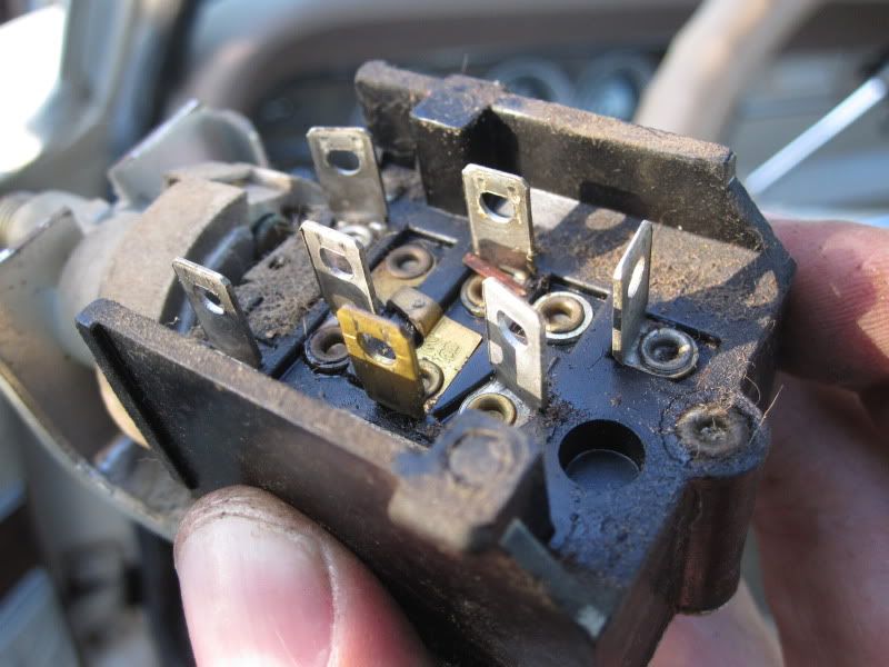

Well, it was suggested I replace my dimmer switch, as that is a common source of headlight issues.
Well, i thought it looked like it was in good condition and was clean...and it was. No issues there. My flickering headlights and diving amp meter still happened, so I pulled my headlight switch finally and took a look.
Nothing heavily corroded, but this is a 37 year old switch, with 37 years of dust and crap all up inside it. I figure this is the next step in identifying the problem. Next will be to look for bad grounds or shorts somewhere. When the lihts went out the first night, i was reaching up under the dash poking and prodding, and the lights would flicker every few pokes. I figure this helps point to the switch or at least a bad connection under there. I also smelled something hot, but not quite burning. Hopefully it's on the switch and no a bad wire or connection elsewhere under there.

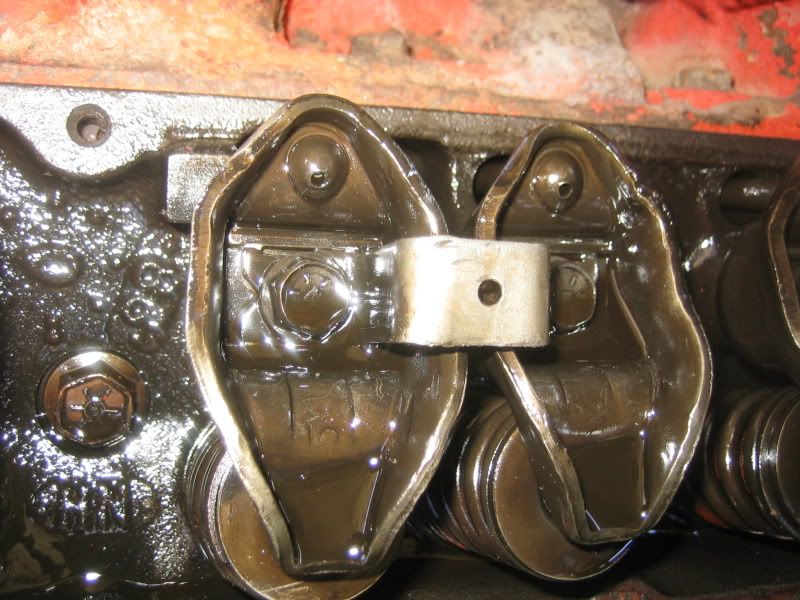

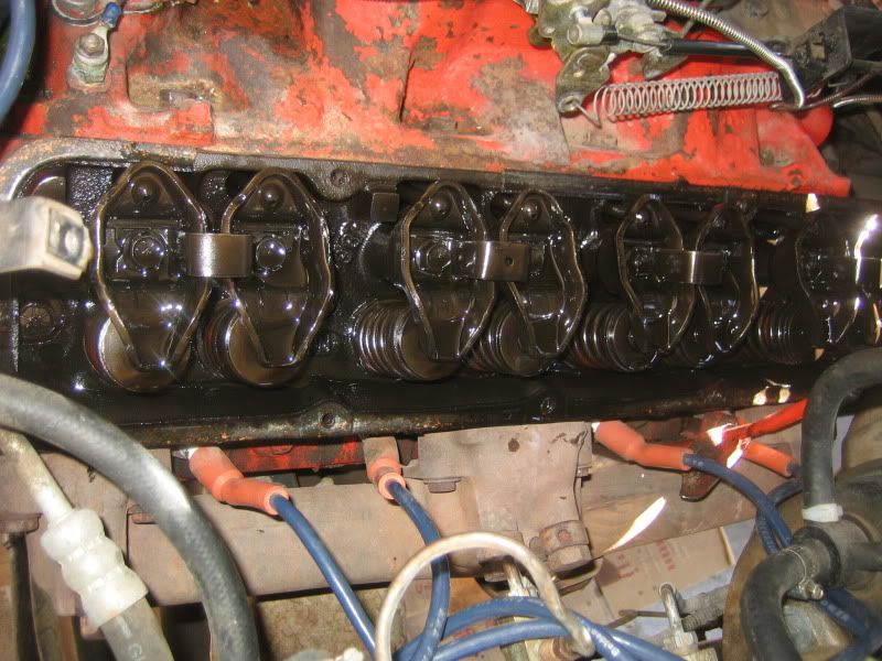

Hmmm, could this be the culprit of my rattle clack click? Methinks I found the answer.

Methinks we told you that answer. You need to adjust the rockers. There aren't supposed to click like that.

As far as adjusting, from what I can tell these are just a straight torque setting. I'm being told that chevy's are different and need to be adjusted while running, but this truck is 1 straight torque spec across the board.
All the bolts are tight past spec (19 ft lbs) from what I can tell. I loosened 1 or 2 and tightened them down with a torque wrench, but they are still clicky. The bolts were so tight that it bent one of the bridges as I loosened it. I had to bend it back and turn the rocker back into place. Dunno why they're so tight.
I guess this means the rocker on the inside or the pivot are worn out. I can pick up a new set of 16 rockers and pivots and 8 bridges for like $116 bucks I think. That'll have to wait for a bit. Should be an easy enough repair once I have the parts

AMC 360.
There's 1 bolt inside each rocker, it goes rocker, pivot, bridge, bolt. I didn't see anything that's adjustable. It's 3 parts then 1 bolt.
Lemmie get some pics uploaded.
Edit: Instructions from a 1974 TSM:
1. Install Pushrods.
2. Install Rocker Arms
3. Install bridged pivot assembly
4. Install Capscrews and tighten to 19 Foot-Pounds of torque.
5. Install cylinder head cover and gasket.
6. install retaining screws and washers. tighten screws to specified torque.
OH and it looks like the PO missed step 6 there. I have 1 broke off valve cover bolt. *******it. The forward most bolt on the passender side is snapped off in the hole. Atleast I know how to deal with that now

Here we go.
Apparently this is the newer style rocker, which seems to come on 74's but not 73's....so again more evidence that this truck was probably rebuilt a while ago.
So, see, rocker, pivot, bridge, bolt.
Even though I didnt technically do anything today other than poke around, it was satisfying. I atleast found what i THINK is part of the noise. I cleaned up the old cork gaskets and installed some rubber ones because I couldn't find cork locally. Hopefully it'll leak less now though.
Anyway, learning about stuff is fun. These old trucks are so simple it seems.
