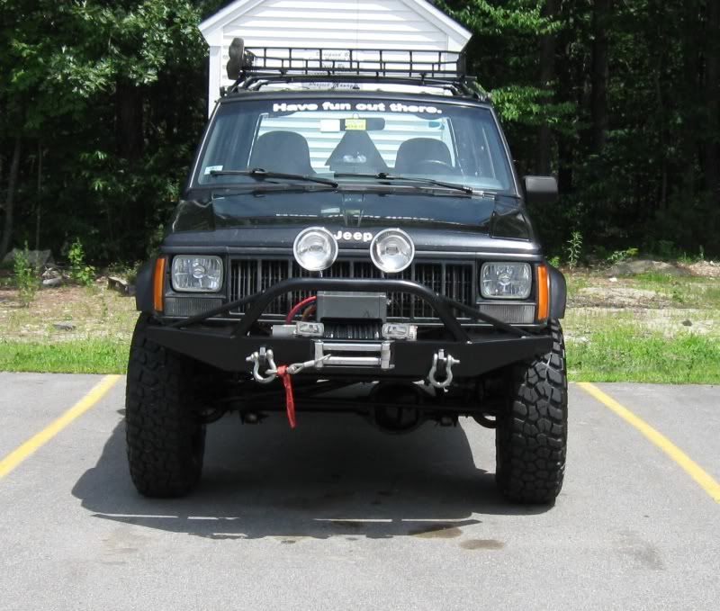

I hit the front bumper with a quick coat of fresh paint, as well as the axles. I think it helped make the Jeep look cleaner now that it sits higher.

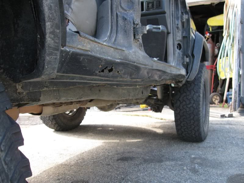

Passenger side rocker, dented, smashed, and slightly rotten.

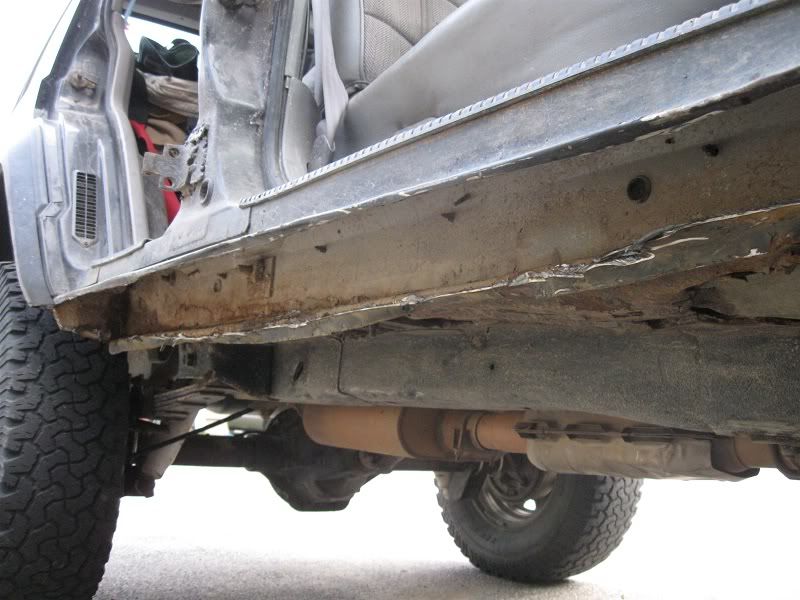

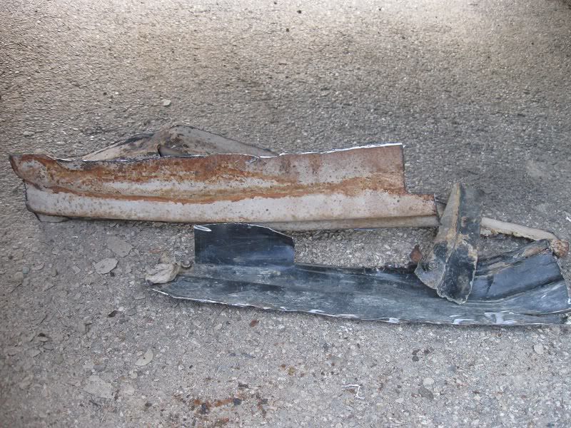

Most of it cut out
Opened up. I still need to cut out the pinch seam, I'll be welding some 1.5" angle iron against the floor facing outward and I'll attach the 2x4x1/8" box tube to that, then weld the top portion of the rocker to the tube as well for even more support.
I got a deal on 9 feet of 2x4 tube but I needed about 10 feet so I added 5inches to each length by using some scrap 1.5x3" tube I had laying around. Put them side by side and welded it up. The empty 1 inch space will be on the inside so no one will ever know.
