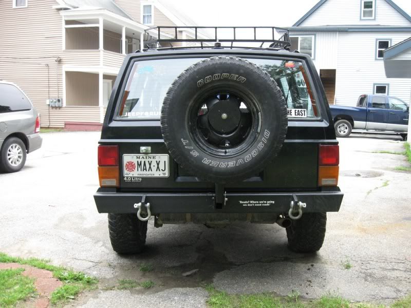

I started working on my tire carrier yesterday and finished it today. It mounts in the 2" receiver on my bumper so I still have the same departure angle. Only thing I don't like is that it wiggles in the receiver a little but nothing major.
The welds on the bracket are obviously crappy. The welds underneath and on the back are much cleaner after I turned up the voltage to get more penetration.
I used some self tapping screw to mount my license plate on the fiberglass tail gate. The plate light is an old light made for a trailer that my Dad found for me in the basement.
I made the hinge out of a 9/16" bolt and some steel tube with an ID of 9/16". It's a very simple design and works flawlessly. When I fold it down it also make a nice seat. The pin is also a 9/16" bolt, with a handle made from some scrap metal and a clip to hold it there.
