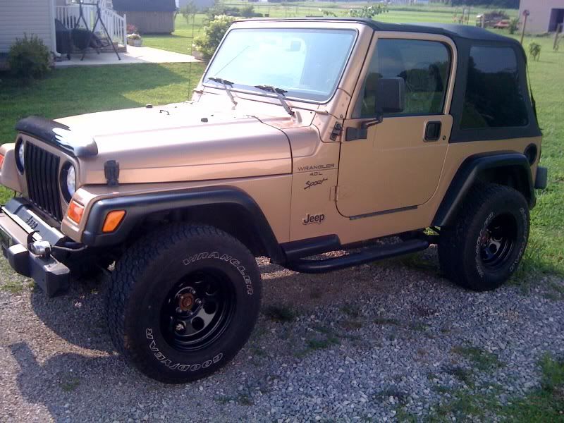

Here is how this starts. I bought my TJ back in Nov. '10. 2000 model 5spd I6 with 88k miles on it. Had to finance half the price and I might have paid to much, but I'm impatient and was ready for another TJ after being without for a few years.

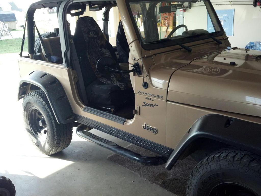

After getting it home the first step was to get ride of the horrible chrome. I'm not a chrome fan on a jeep. To each his own, but it's not for me. I put them on craigslist and found some one to trade me money and their stock bumpers for these. They also bought the step bars from me. Since it was my DD, and I have small kids, I had to replace them. I would prefer rock sliders at this point, but we will get to that later. So I order some rugged ridge black step bars along with black grill inserts and headlight bezels. I also bought some rubber bumper ends to rid me of the faded milk jugs.
The top was shot when I got it too. I went with the Rampage Bowless soft top in black(seems to be a theme here). I think it looks great, and it keeps the rain out 95% of the time.

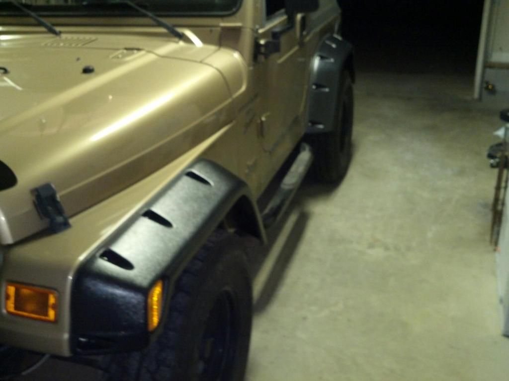

I went with the Falken Rocky Mountains from Discount Tire. Same as the Wild Peaks only the are DT version. I got 31X10.5 and with the soft 8 backspacing they fit great on stock suspension. Now I had a problem with water and mud spraying me in the face since my tires stuck out further then the factory flares. I got me some Rugged Ridge flare and some cheap rocker guards to go with it (mostly for looks).

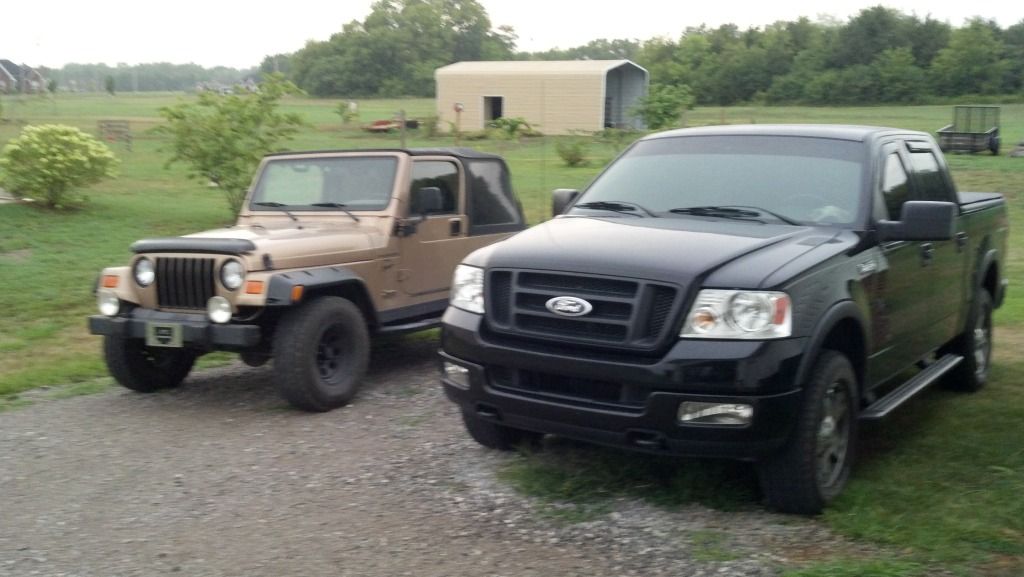

Now to bring it up to date. This is how it sits now. Right next to my new to me DD 2004 Ford F150 SuperCrew FX4. With a new daily driver I am ready to start some real work and make this a trail Jeep.

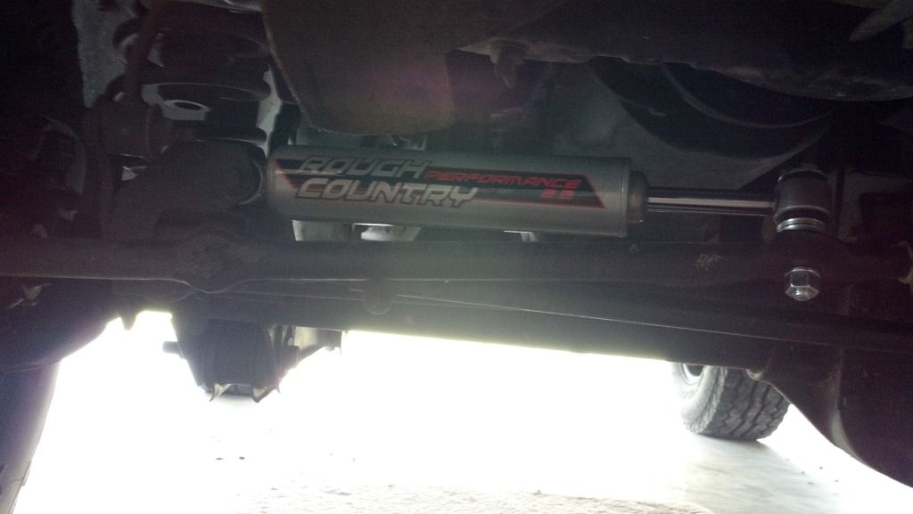

I found out Wednesday that my brake lights didn't work anymore. Luckily it was my father that noticed and not a cop or another car that didn't stop soon enough. Easy fix. $13.10 for a new brake light switch and a very uncomfortable bending of the body to get under the dash to replace it and it's fixed.
Stabilizer came in the mail yesterday. It will get put on tonight and lift will get started in morning. I can't wait to get this done and get to wheeling... then come up with what is next.
Lug is offline
post #13 of 25 Old 08-27-2012, 07:09 AM Thread Starter
Lug
2015 JK Wrangler
Location: Chapel Hill
Posts: 98
Well I started friday night trying to put the steering stabilizer on. Everything was going well until I tried to get the bolt out of the tie rod. What a pita. I had to consult the jeepforum to figure out I needed a pitman arm puller... and o'reillys was close... and I was a few beers in.
So I got up bright and early saturday, before my lift help arrived and went got me a pitman arm puller. $15 and 2 minutes later it popped free, but since I had beaten it with a hammer for an hour the night before I had to get out the grinder so the bolt would fit back through. Got it done and started on the lift.
Lug is offline

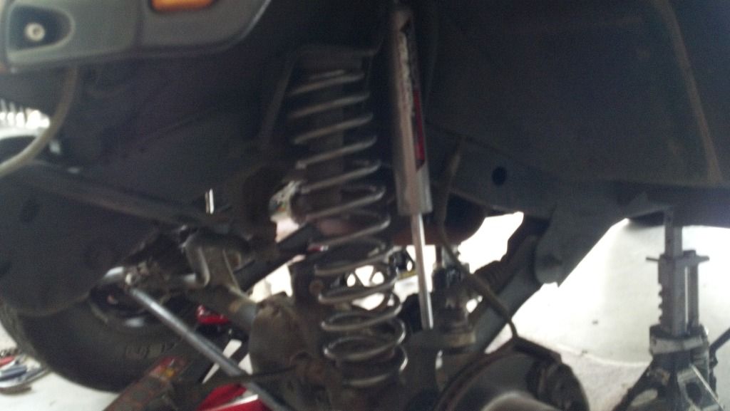

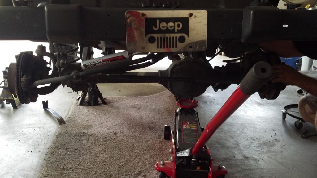

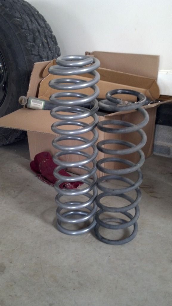

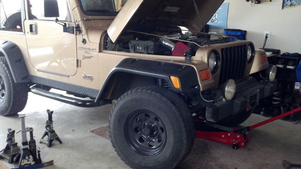

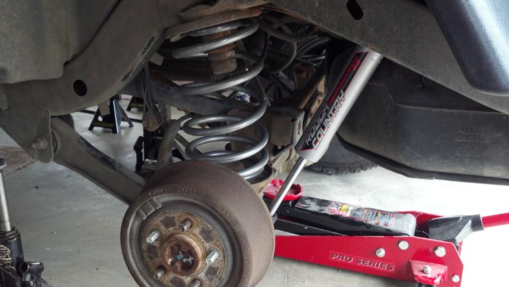

The lift itself wasn't to bad to put on. I'm sure most of you reading have done some kind of lift before. Nothing special or different here. I had to go borrow a spring compressor from a friend of a friend, but other than that I had all the tools in my garage to do it. The front was much more difficult than the back. We spend about 2 hours on the front and less than an hour on the back with a subway break in the middle. Here are a few pics.
Difference from factory to new progressive spring.
Got driver side done.
Front done.
Again the back was much easier.

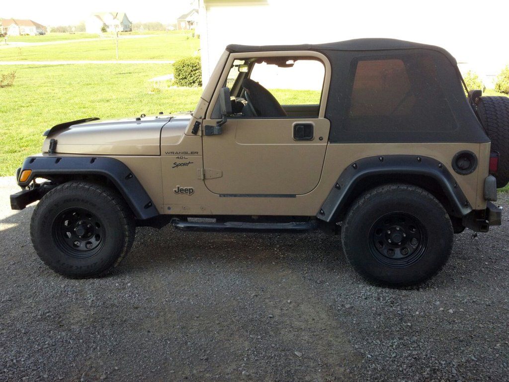

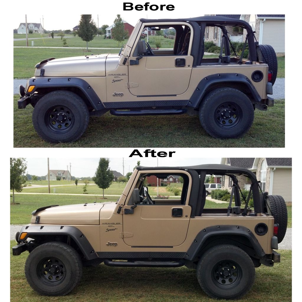

Now a before and after look.
Took it out for a spin and had a not so nice vibration from the rear drive shaft on acceleration. Yesterday I went and got some washers and longer bolts and lowered the transfer case skid plate and the vibration is gone.
After all this my friend tells me that if I'm going to wheel it I need to get dust boots for the shocks and I should really look into sway bar discos. I guess those are next on the list. All in all I'm very pleased so far with this lift. I look at it and think, when those tires wear out I need a 1" BL and 33X11.5 tires, but that will be awhile.
