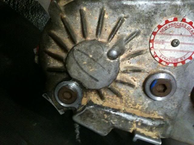

It was a '96 or later Grand Cherokee and I believe the t-case was an NP242. I'll probably just put a layer of teflon tape and call it good.
I've also seen these plugs on TJ t-cases.
Does anyone have good idea for the fill plug on my AX-15? I finally got it off. It's chewed up from my vise-grips and every time I tighten it up I have a time getting it back off.
