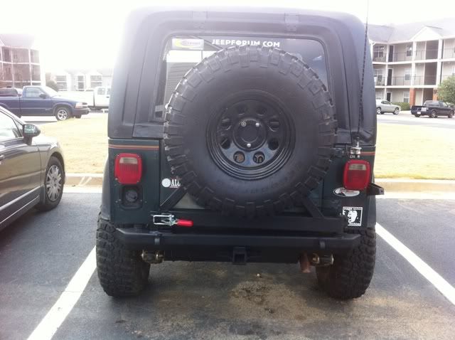

Unread 11-26-2011, 02:14 PM   #86
Louie4
Powah Injanir
Louie4's Avatar
Location: Raleigh, NC
Posts: 10,109
Finally done with the tire carrier.

Unread 11-27-2011, 03:55 PM   #87
skyj
Location: Helena, MT
Posts: 3,465
looks good
skyj is offline   Reply With Quote Quick reply to this message
Unread 11-27-2011, 07:38 PM   #88
Louie4
Powah Injanir
Louie4's Avatar
Posts: 10,109
Originally Posted by skyj View Post
looks good
Thanks man. I appreciate it. Now I just need to find a permanent spot for my tag. As of now it's ziptied to the spare tire.
