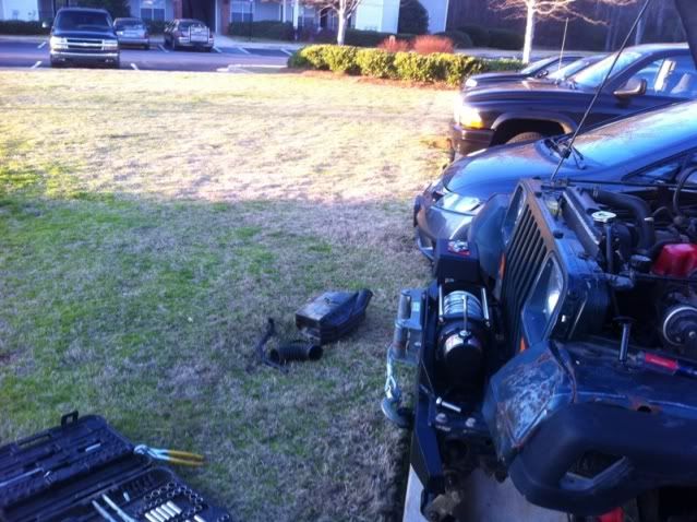

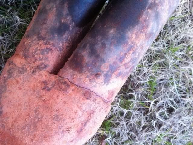

When I got home I figured I was still gross so I started tearing into the jeep. I took it to the exhaust shop Saturday morning and got a quote from the guy. I also said I was putting a new manifold on so I told him I'd bring it back after I got it on. So here I am.
My workspace...the parking lot. But with 70 degree weather I can't complain.

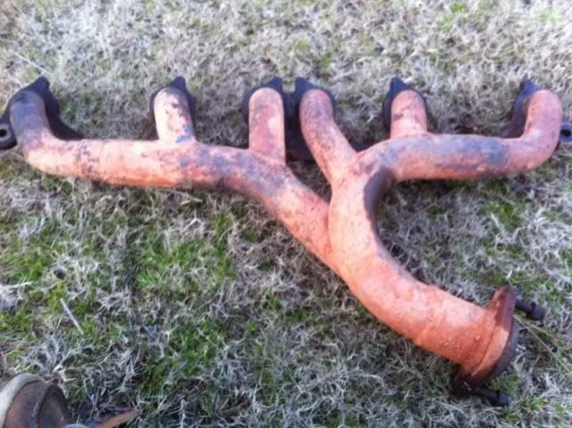

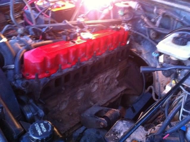

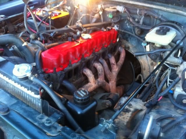

Disconnected everything.
Got the intake off.
Manifold off.
I thought it had a crack in it and it did but it was not as bad as I thought it was.

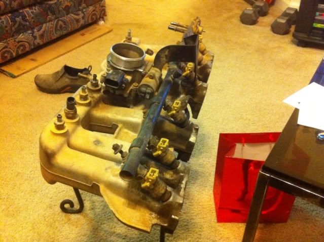

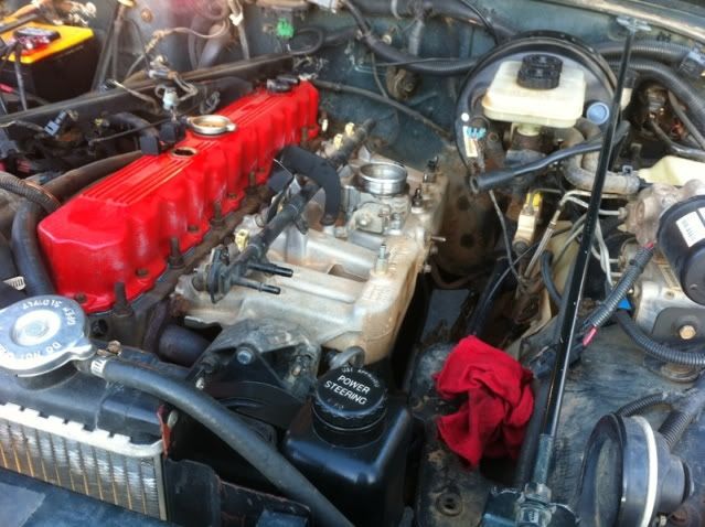

Here's how I spend my evenings in my apartment. With my 4.0L intake manifold.

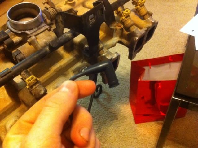

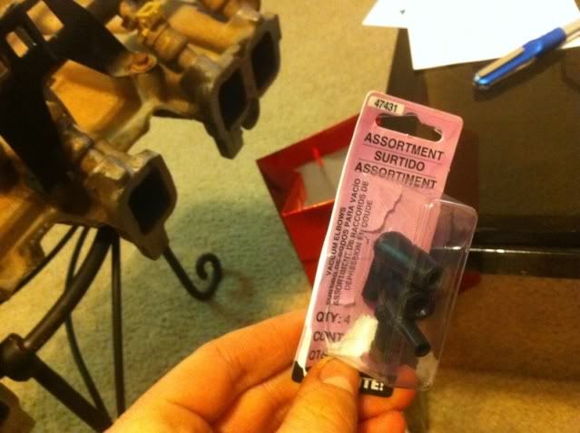

I'm going to wipe it down and clean out the inside. While I was pulling vacuum lines I noticed the elbow to the FPR was dry rotted and cracking so I went to Autozone and bought this box of elbows for $4.99 but I only needed one.
And the new $5 elbow.
I should get my manifold tomorrow per FedEx.

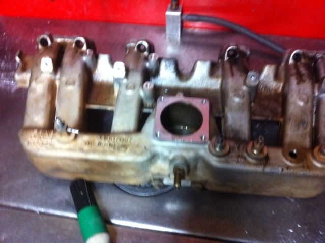

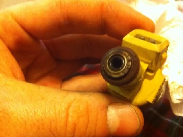

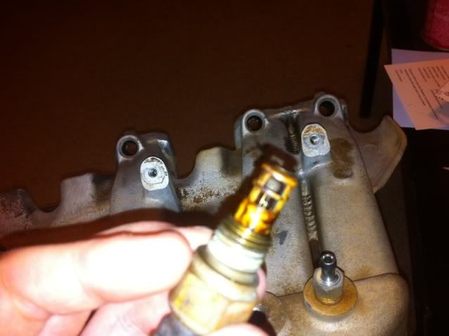

Well I was going to just clean the mating surface on the intake and throw it back on but I started looking more closely and it was full of sludge and crap from 1993. I don't believe I've ever cleaned it in the last 11 years I've owned it (on the inside). I was scrapping chunks out with a small screwdriver. It was really gunky near the injector tips so I ended up taking every thing apart on the intake. I cleaned the manifold, throttle body, fuel rail, and injectors. These pics suck but oh well.
