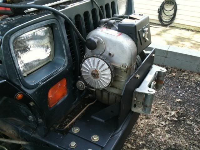

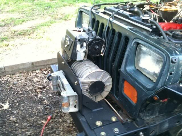

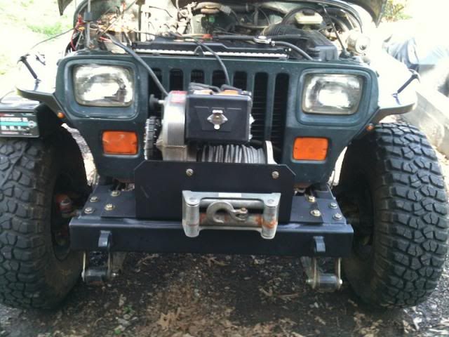

Got a few things done to the jeep. I bolted the M8274 mount to the bumper. It fits well but there is a little overhang on the corners (pics). I can deal with it though. I still need to pick up some welding cable and lugs to make my own cables. The cables on it are a bit short and the ground is only 6 ga. They positive is 1 ga but corroded. Oh, and everything on the front is grade 8 hardware. I had some laying around and bought (4) 1/2" bolts.

Looks good!

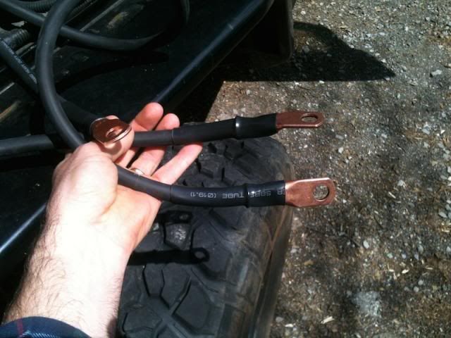

Well yesterday I spent driving around town getting parts. I finally found a welding shop that would make me some winch cables. I used 1/0 welding cable in 5.5' lengths for the winch. They also put lugs on them too but I found out they had a 1/2" hole so I had to figure something out. I didn't go with #2 cable since it seemed small and I didn't want to go with 2/0 since it was as big around as my thumb. Well, for $39 I had the two cables made. They didn't have shrink tubing but I got some at HF and was able to put it on with no issue.

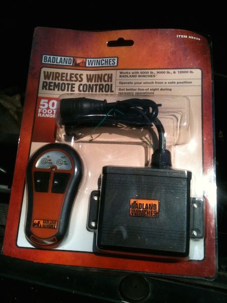

While at HF, I found their wireless winch remote for $32.99 plus tax. I don't have a controller yet and this was something to try. I will need to get an extra "23A" battery for the remote and I'm going to use an existing switch in the dash to power the wireless controller. I don't want it hot all the time incase the controller buttons are depressed by accident.

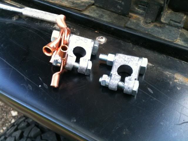

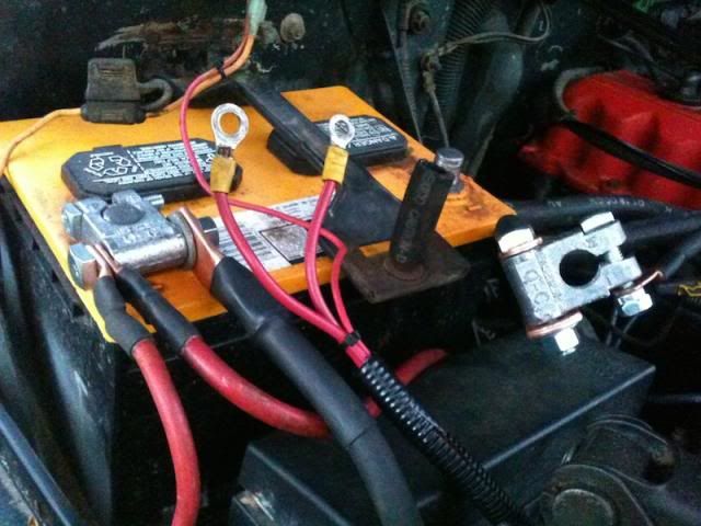

Once I started getting the connections off the wire on the winch and running it to the battery I found I would need to change things up. My current terminals would not accept the lugs of the new winch cables. So I called around town and found some military style battery terminals and of course it was all the way across town. I also needed to put lugs on the bare battery wires that were used in the old terminals. I got an assortment and crimped them on with my homebrew method and put shrink tubing also. Here's the terminals.
Here is everything mocked up. I didn't want to put the negative on because I still need to work on the positive terminal. I need (2) ring terminals to accept the 5/16" clamping bolt. One day I'll put an extra 12V power distribution panel in with fuses but all in good time.
So, once I get the new terminals I'll be ready to rock. I also need to get some wire to extend the wireless controller signal wires. It has 4 wires encapsulated so I may be able to pick something up at Home Depot.

Where are you mounting the remote reciever unit? I've been thinking about putting one from HF or e-bay on mine.
I have mixed feelings on my "in cab" switches (they work fine, but depending on what I'm doing, I don't always like using them). Mine is set up with a master switch that lights up the momentary switches when they're armed. Nice and idiot proof.
I've got my wired remote, but it'd be nice to not have to dig it out. I was planning on wiring it into my "in cab" switch wiring so that the master switch would also stop the wireless remote from working.

I just finished up the install and put the receiver on the pass. side fender near the alternator. I then ran a switch power source to it (in cab) and ran the negative to my high speed fan relay. I then ran the two 'in' and 'out' wires to the control box. Works great but of course there is that split second delay when pressing and releasing the button but nothing too troublesome. I figure this will get me by until I can find a controller.
I did solder and extend the wires coming off the receiver and put shrink tube on it.

So, I've been driving the jeep around the last several days and the front has sagged some which is fine. I expected it to. In addition, the winch is oily and I believe it's leaking from the top case half seam. I will leave it mounted and pull the motor and top half of the case, suck the old oil out, and put more non-detergent 30W in.
Grant, would it be that easy to do that?

Pretty much. There's not a whole lot to them.
There's only a few places to get a leak. Most of them leak (at least a little) where the drum goes into the main case. Other than that, the only possible places are the shaft where the brake attaches, the motor mount, and the clutch cover.
Unless you do a full rebuild, there's nothing you can do about the first two that I mentioned (and they very well may be no better after), but the other spots are easy enough to take care of with your favorite gasket sealer.
It's also worth noting that these things only get a very small amount of oil. Unless the winch has been on it's side, they rarely leak out, but leaking water in is a whole different story if you go through deep water. If you only dunk it occasionally (or not at all), you can just change the oil afterward. If you need a solution for deep water, let me know. It's a bit more involved, but I have a solution.

Well I took the winch off and the top, motor, and solenoid pack. I can tell someone serviced this one from the clear gasket sealer. The top half bolts weren't that tight either hence the leak. I also found the case had ATF in it and some water.
