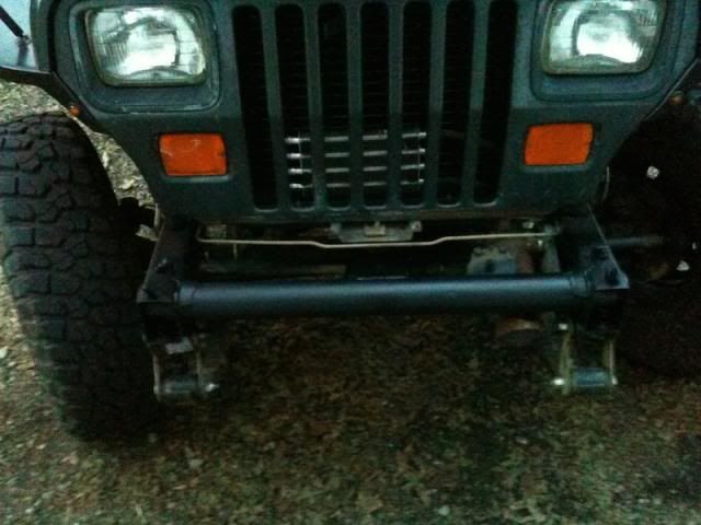

Oh, I forgot to throw this on there but I started cleaning up the bumper and bracket. Thought I would just touch up where I cut but that was going to look crappy.
Lou

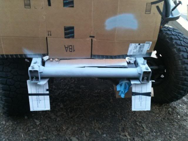

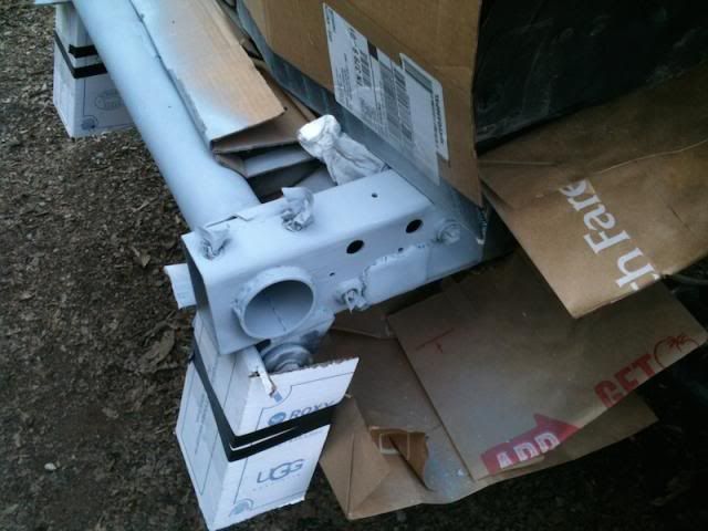

Well I got the mount and bumper painted. I put a couple coats on then waited 45 minutes and put two more on. I went with the semi flat black over the gloss. I think I like it pretty well.

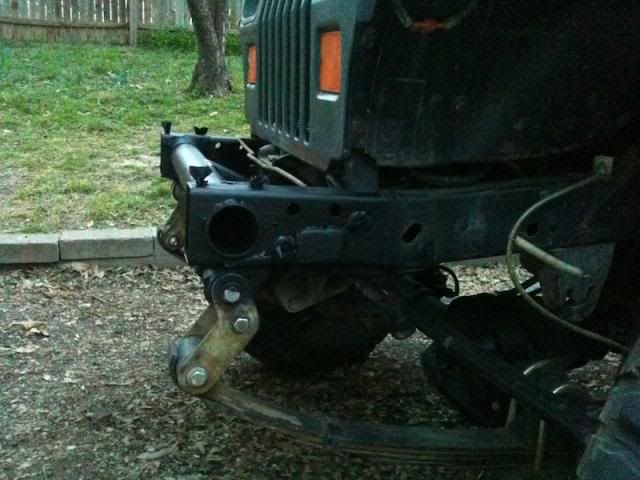

I also started to finally repair my frame from the seized nut inside that holds the steering box up. I put a tack on the nut and filled in some of the cuts the disc made. I will grind it down with a flap disk and put a patch over it.

Well I am one step closer to having my new winch on.
Got the frame patched (and what a hack job is looks to be) and primed.
After letting the primer set up I lightly sanded it and washed it off. Then shot the black on there.
