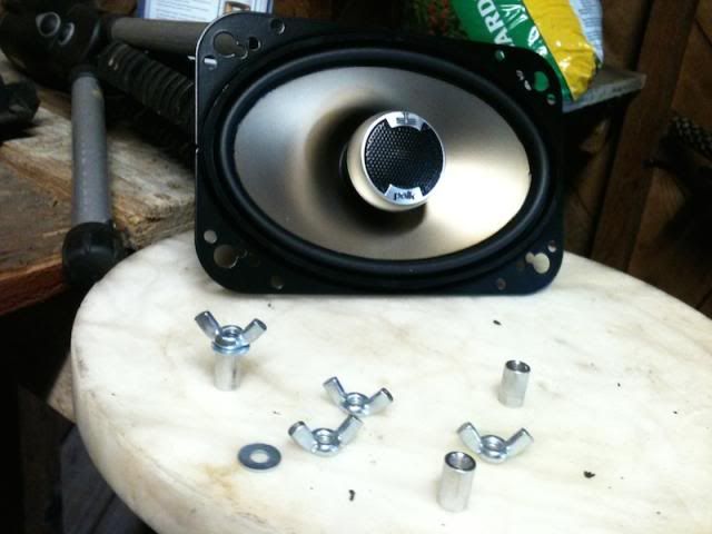

I looked over the speakers and determined I need some hardware. I went to Home Depot to get some wing nuts for the#10-24 studs that hold the speakers in place. With the new Polk speakers (and like the old ones) the tweeters protrude past the mating surface of the outer frame. If you don't use a spacer it will push the tweeter in and pop the back plate off the magnet, thus ruining the speakers.
So I actually found some 1/2" #10 aluminum spacers that worked great. I also put a washer in between so the spacer wouldn't go through the larger holes. Then I used wing nuts on the studs to hold it all down. Now I have speakers that are mounted solidly mounted to the dash. My previous speakers were not and it was something that always bothered me over the years.
I also like to reuse the magnets from old speakers. Here is what I picked up in my gravel driveway. I found more on the second go.

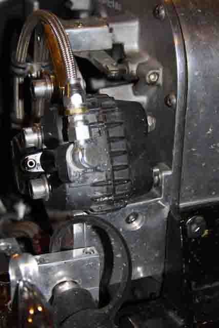

Yes there is a cable and a handle in cab you pull and turn to lock it in place but if the drum gets wet its a bit slippy. I have a better pic somewhere of his setup I did find this one though.
Pretty genious actually some day I will do it and plan to rig up a solenoid the operate the caliper.

His is the nicest I've seen. (Snow mobile brakes if I remember correctly). When I picked up my Belleview, it didn't have any of the interior controls. It just has a normal (single) solenoid attached to what appears to be a remote starter (the under the hood kind) to operate the motor. I've also seen where a fellow used a motor from a Ramsey to make one a "power in/out" winch by using the Ramsey motor housing over the armature from his original motor, but I don't think that it survived too long.
I've been torn which way to go on mine (just purdy'in up what's there, or modding the brake). I'll probably just do the former. I don't want to sell the Belleview, but I've got nothing to put it on. I'll most likely either put it on my brothers Bronco as a permanent loan or the same deal on an old Scout 800 that my dad has if he ever starts rebuilding it.
