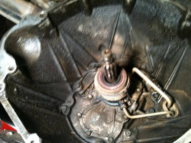

Today I got the bellhousing on the AX-15 as well as the fork and the throwout bearing, then I realized I didn't have the fork retainer spring. So I ordered one from Quadratec for $1.99.

A couple of pics. I couldn't find anything to use to install my AX-15 input shaft oil seal. Finally, I noticed my 8.8 spider gears in a small box doing nothing. Fit perfect.

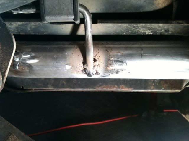

I also chopped my Flowmaster off so I can put my new tailpipe in. I took it to a shop a year or so ago and they didn't do that good of a job now that I am looking at it.

Well I'm waiting on my spring for the clutch fork. Per FedEx it will be here this Saturday...ugh. Here is where I'm at and a comparison of where I was.

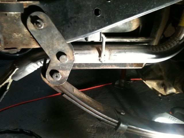

So, I decided to tackle the exhaust. I bought the new tailpipe so now I needed to install it.
I bought a hanger off of eBay for the rear, same as the one the exhaust shop put on before I ripped it off.
On the new tailpipe I had to cut the rear hanger rod off the pipe because it wasn't lining up too well. I moved it back maybe 2 inches and angled it properly.
I also prepped the Flowmaster by pulling the old pipe out of the ends. I was about to use the pipe expander I borrowed from Autozone but found it was too big. I need to go get the smaller one. Once I expand the pipes between the converter and the Flowmaster I can burn in the tailpipe. I may just put a clamp between the cat and the Flowmaster just so I remove each part separately.

I have the Flowmaster cleaned up and I got the proper tube expander to slide the front of the Flowmaster into the existing pipe. I'm going to weld the tailpipe to it and have the front use a clamp so I can have a point of disconnect without chopping it every time.

I checked on my order for the spring pictured above. It was coming FedEx and they said it was going to be delivered February 15. I checked that day and it said it was delayed to February 18th. Well, this weekend was looking for working on the jeep so I said screw it. I called the dealer and they had one for $4.75 (tax included). I went by and got it, no problem. I came home and my wife and I took the dog for a walk and checked the mail as we always do. It turns out I got a package from Quadratec...which contained my spring...ugh. Apparently, FedEx got USPS to ship it. So now I have an extra.
The good news is I got the transmission installed as well as the t-case. Filled both up with fluid and reconnected the shifters, plugs etc. I also may have forgotten to mention I jerked the wiring out of the reverse light switch when I took the transmission out so I had to fork out the $56 for a new one at Autozone. I also bought a master/hose/slave cylinder on eBay for under $25 shipped...well it's crap. So now I just ordered a new master/slave/hose kit from Summit Racing for $102 shipped.
So for now I've welded the Flowmaster in and need to finish bolting all the exhaust up and I'm now waiting on the master/hose/slave cylinder kit to finish everything up.
