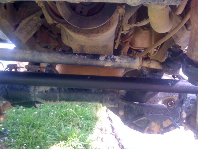

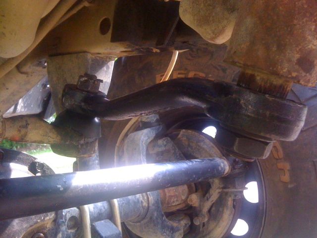

Here's some pics of the pitman arm.

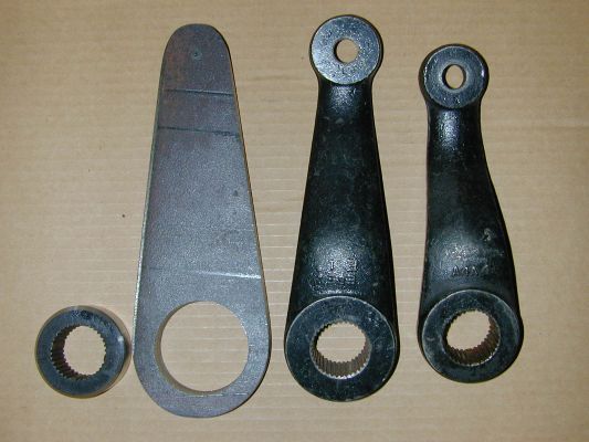

Here are some comparison shots to the stock TJ arm I was running (I got them off Pirate).

Any clearance issues with the new pitman arm?when you turn full lock does it hit the bump studs on the knuckles?
No clearance issues that I can see. I can turn to the steering stops going left and just barely touches going right. My jeep finally turns like it did before I upgraded the steering.
I also found a castle nut backed out on the drag link TRE on the knuckle. The goferit allowed the TRE to sit low in the arm. When I put the castle nut on it was tightened down past the cotter pin hole so I put a washer on top then a cotter pin. Well it backed out to the washer so I stacked some underneath the castle nut until it was up near the hole. Steering is better and I aligned the wheel straight also.

A WJ pitman arm. It's 1" longer than a stock YJ or TJ arm and since I had to grind out the keyways in the arm I had a lot more adjustability when I installed it.
