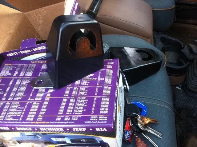

I also took my Solid cover off the 8.8 because it was leaking after my last rock bashing wheeling trip. So I need to fill it up and take the bumper off Sunday. The gas tank is sitting in the back of the jeep for now. Also my buddy brought me the Daystar extended bumpstops he got me for my birthday a month ago. Good thing too, I pushed on the front driver's side bumpstop and it fell off. Another thing I'm going to do is put the stock pitman arm on because the drag link is still close to the tie rod. I'll take some measurements of the pitman arm/drag link to the tie rod and extended bumpstops to the axle tube.

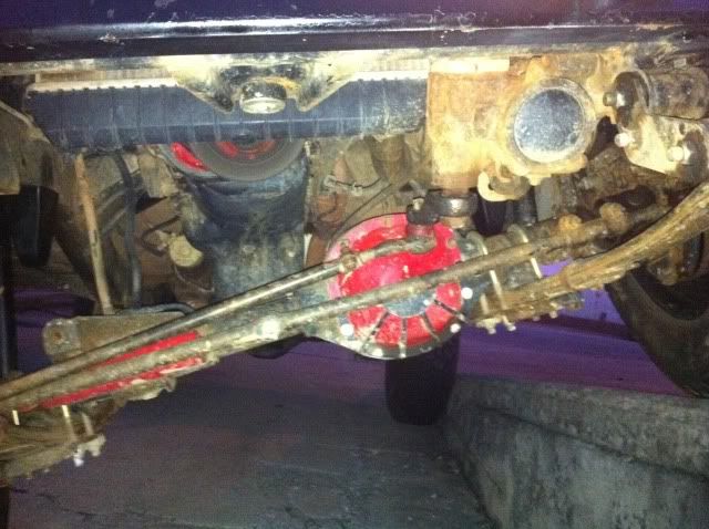

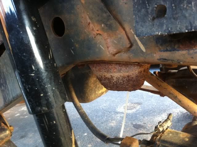

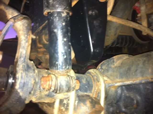

I got the 8.8 filled up, the bumper and tire carrier off, the new Daystar extended bumpstops on and the stock pitman arm back on. Here's a pic of my steering before and after. The angle on the drag link is a little steeper but I believe this will keep my drag link TRE at the pitman arm from acting as a bumpstop on the tie rod when I'm at full stuff on the driver's side.

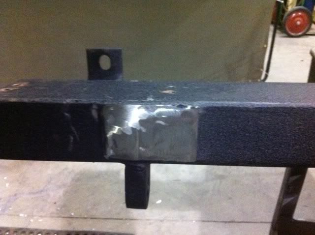

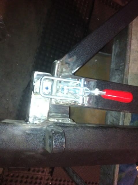

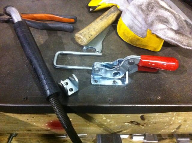

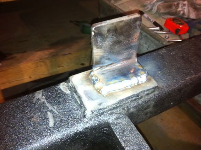

Well last night I took my bumper to work and did a little fabbing. All I used was a piece of 2 x 2 angle iron and my Destaco latch 341R. The latch is beefy. Now for some pics.
Here's the Destaco latch:

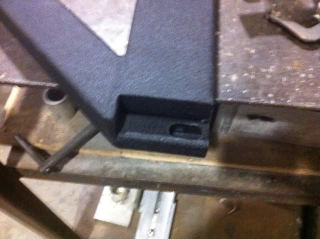

This is the standard Smittybilt tire carrier end. All that stuff was in the way to I cut it flush and put a plate over it.

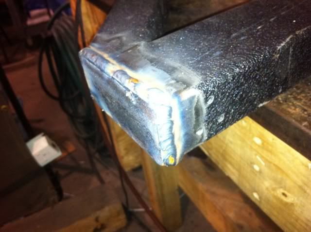

I had to clean off the bumper as well to make room for the new metal.

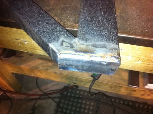

Then I made a backing plate for the tire carrier so it wouldn't go into the tailgate. I think I'm going to put some kind of rubber on it as well.

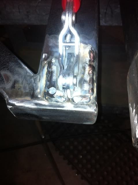

Next I welded the Destaco Latch onto the tire carrier. I didn't want to fool with drilling it and having to put bolts through it. Water might get in there and cause issues later down the line. I know my welds aren't the best but the last time I put a hood on was over a year ago.

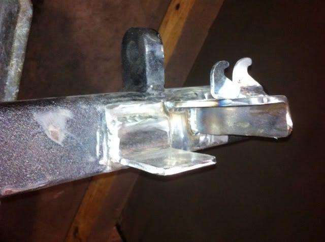

For the final part I cut a piece of angle to size to weld the hook on for the latch. None of this is very pretty but I'm going for function over fashion.

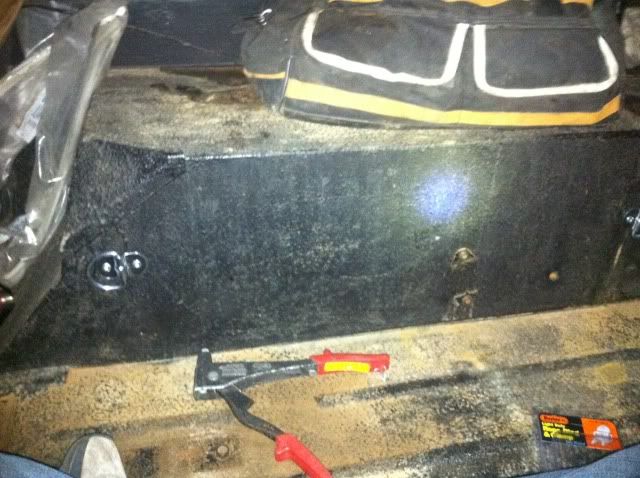

Well I am going to put my dropped pitman arm back on as the extended bumpstops might not be of much help plus I have a little bit of room. I also put some eyelets on the side of the back fenderwells to hold down my tool boxes. My buddy picked them up for me and let me use his rivet gun.
