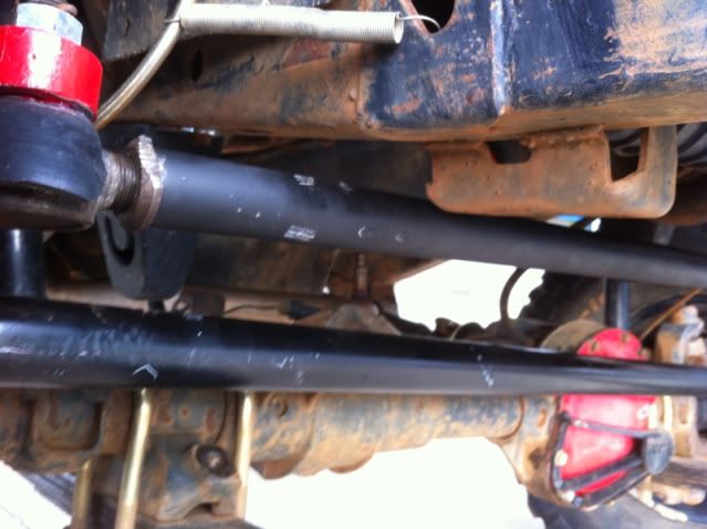

I went out and measured the distance from my relocated pass. side bump stop to the axle and the distance between the drag link and the frame. I found that I have 4.5" between the frame and drag link and 4.375" or so from the bump stop to the axle. I think I may put some washers in between the bumpstop and frame just to be safe.
Here is a picture before the front axle refresher I recently posted about. You can see the bumpstop isn't close to touching and the drag link is nearly hitting the frame.
