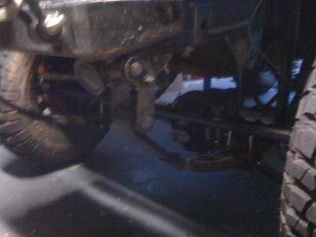

Here is a shot of the front axle under the jeep. It's not very good though. I got the tires on and all I need to do now is fill the D30 up with fluid.
Lou

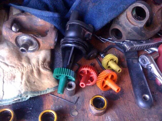

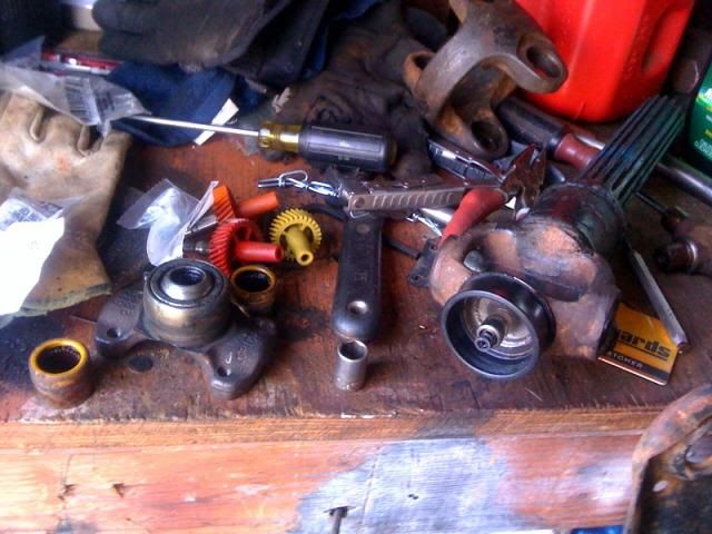

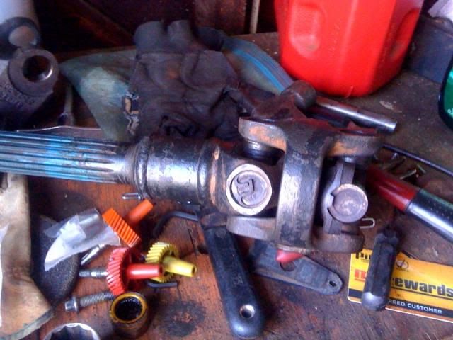

I got to go to the junkyard today and get a few things. I started to find different color speedometer gears while looking for a front driveshaft out of a cherokee or a grand and kept them hoping one would be the right tooth count. It looks like I got a 34 tooth which is what google says I need for 4.10's and 33's. My stock one is 30 tooth so it looks like I may have gotten lucky.

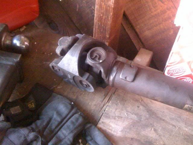

I also found one front driveshaft out a grand cherokee. It is in good shape too. I took the double cardan apart and merged it with my Tom Woods. I also put the Spicer u-joints from the cherokee shaft in because they were in good shape.
Here is the finished product. I also found out there was suppose to be a spring in the small post which my TW didn't have. I may have lost it years ago.
I also received my speedometer pinion o-ring and isolator bushings today.
Lou

Sweet. I wanted to bet that would work; glad it did. I had never considered raiding Speedo gears. Did you take then from transfer cases or transmissions?
Thanks for the ideas. I took the speedo gears from t-cases out of Grand Cherokees and Cherokees. Everyone I raided had a different tooth count except for the last one. Another thing to consider is the gears I snagged have a larger diameter than my stock 30 tooth so I am interested to see if the gear will actually work. It fit in the t-case and when I turned the output yoke I removed it and saw that it moved. So I'm hopeful.

I got the jeep driveable again and it rides pretty good. I put a 36 tooth speedo gear in and I think that's the proper one. Everything feels pretty tight and definitely not as much slop as it use to have. I went ahead and changed the pinion seal on the D30. It started to leak even after I put a new yoke and seal in about a year ago. I also think I found the reason. It seems that the pinion yoke had just a slight amount of play in it. So I took the yoke on and off about 15 times changing preload bearings till I got the right feel. I am pretty happy with how it rides.

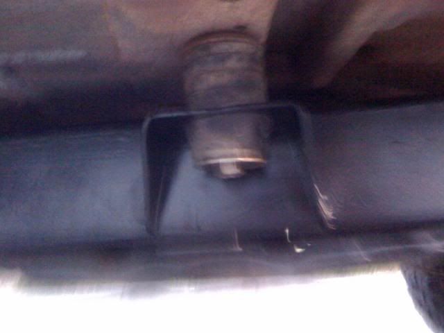

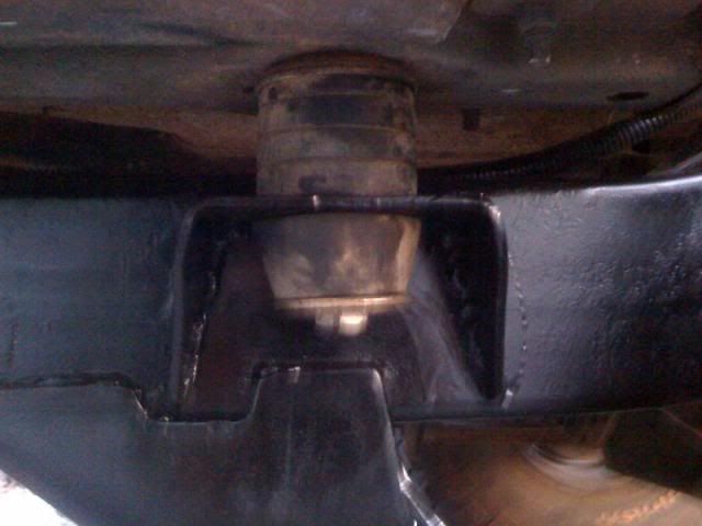

I'll keep my eye out at the junkyard. Here is my body mount on the drivers side near the rear tire. I have since bent it back and welded it but the pic sucks due to poor lighting. I'll post the fix later this week.

I got the jeep out today after fixing the body mounts.
Here's a before and after:
This was the worst one:
Here's the other:
Lou

Wow thats clean work - you would never know. In case yu ever get real rich, check these out... I need to start playing lotto or something http://www.genright.com/ProductInfo....ductid=BMT2001

I never could figure out why jeep didn't weld those mounts on the top. Since water is bound to collect there and rot them out.
