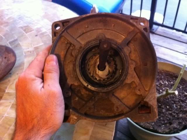

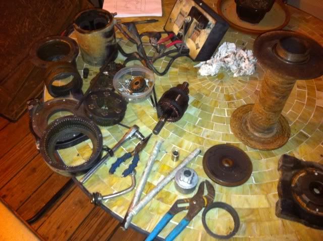

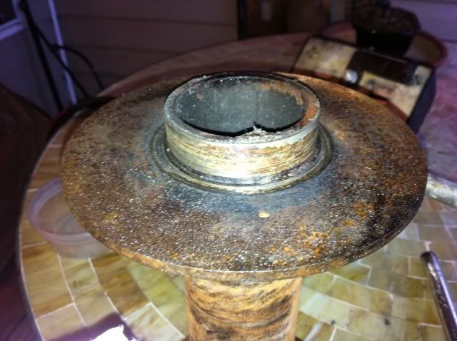

Here's everything bead blasted and degreased. Everything was gross. I'm pretty sure the horrible smell was the burnt varnish from the windings.
Lou

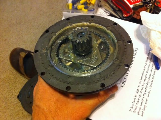

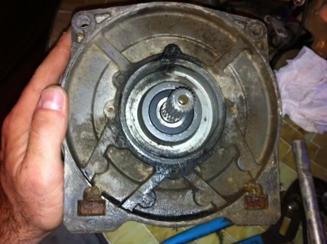

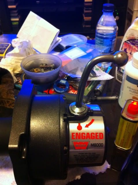

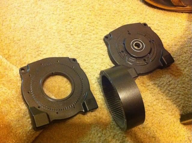

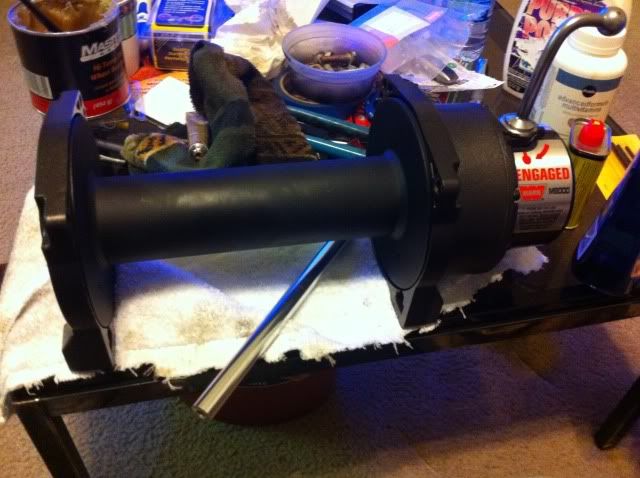

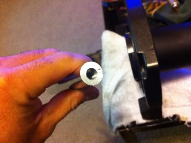

Some pics of the progress. I have 2 threads right now on this winch rebuild but I figure my actual build thread needed them too.
I threaded the aluminum rods but I need to get some shorter bolts. I'm going to ACE to get some 5/16-18 socket head cap screws.

Posts: 2,537
Winch is lookin good. Wish I had the budget for that LOL hey, if yer into engineering and want to see some interesting winch deals (among other things) I highly recommend you check out www.surpluscenter.com
They deal in industrial and military surplus, including winches. I've got my eyes on a hydraulic setup in case I ever have the $$$ in a year or two. That or one of the rebuild Ramsey's. Not to mention they have all kinds of air compressor stuff, electrics, PTO stuff, etc.

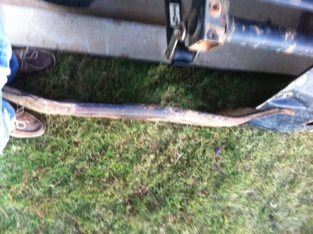

A few more updates.

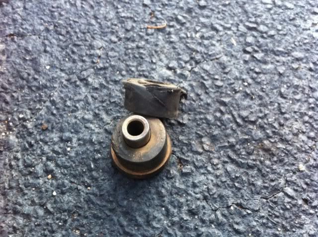

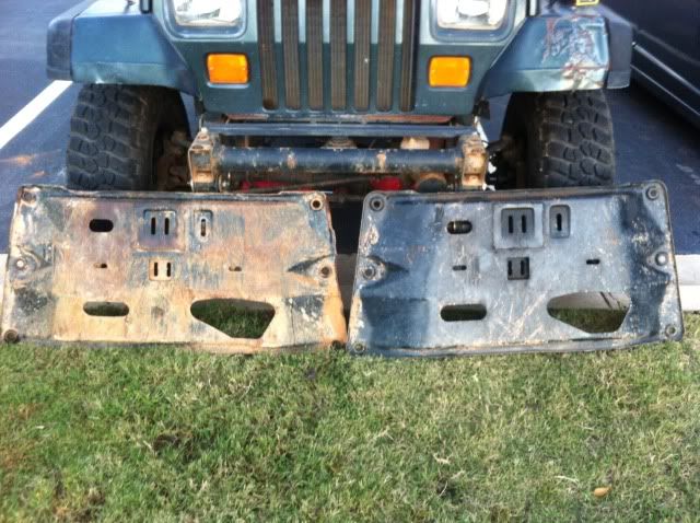

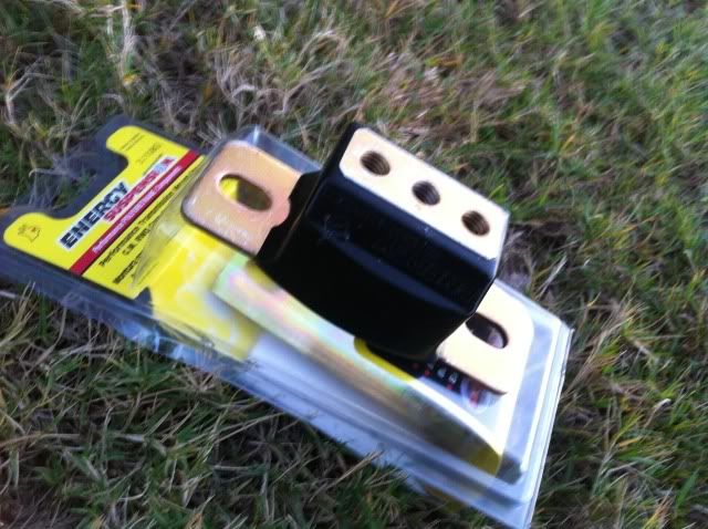

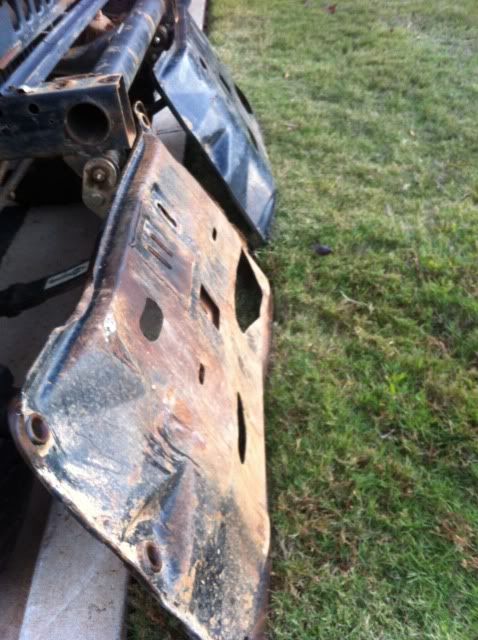

The weather this week has been amazing and I wanted to get a few things done to my jeep before it gets too cold. I recently acquired a new (to me) cross member from a '95 YJ that was in great shape for free from a buddy who did a tummy tuck. I figured why I was swapping it I might as well put a new transmission mount. I also need a new stabilizer stud and bushings as my home made one has seen better days. I got a poly transmission mount and I'm going to order the stabilizer bushings and stud today.
Can you tell which cross member was mine?
Notice the deformity in my old one.
I was glad I went ahead and got a mount. It looks like I needed it. This is the one from 1993.
My stabilizer bushings.
Mount installed. Pardon the exhaust. It will be getting replaced in the next month or two.

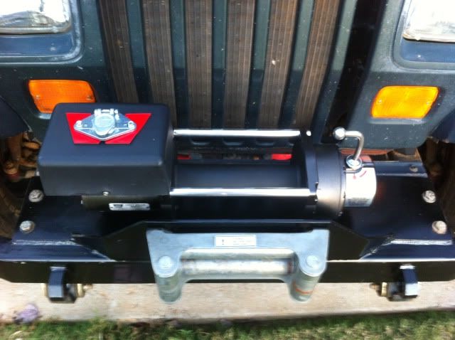

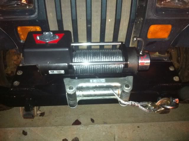

Got my winch cable on. Now it's complete.
I was going to get my Smittybilt bumper on but found out the tapped holes on the backing plates are for M10 x 1.50. I didn't want to use the crappy bolts they gave with the kit so I went to Lowes to find some metric grade 8's but to no avail. The only place that can get them is Fastenal. Since I have the correct length grade 8 bolts in 7/16-20 I'm going to drill and tap the bumper for that size. Especially since my buddy just bought that drill and tap kit for his D44.
