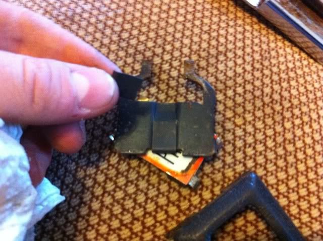

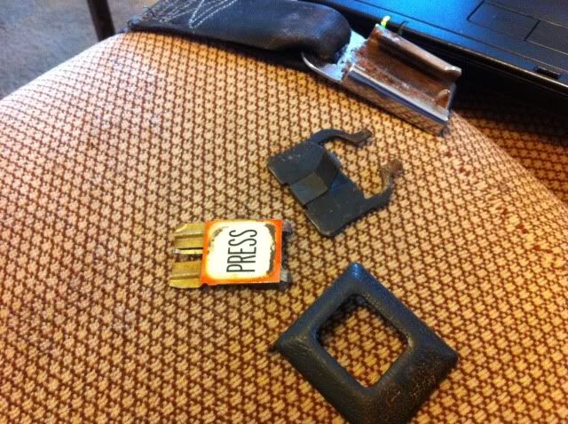

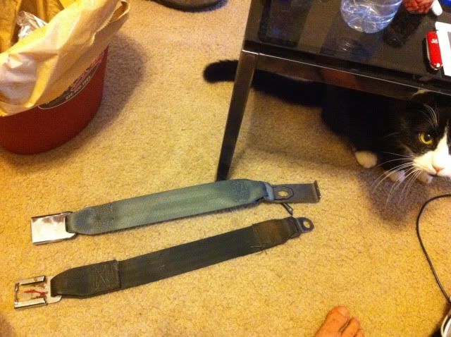

Well my driver's side female seat belt broke. It wouldn't stay latched so I unbolted it and pried it apart and found that the little tang on the spring plate was broke and it wasn't pushing the "Press" button to the top. So today I went to the junkyard and found a female seat belt out of a Ford Econoline van. I took a rear sear buckle to make sure it would work and it did. Most all the older Ford's worked but the Econoline van had the longest strap.

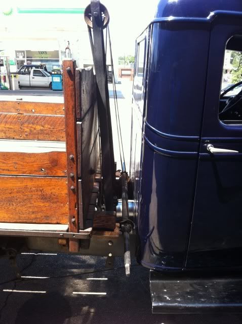

I thought this was really cool. I was leaving my favorite place for lunch going back to work and saw this right around the corner. It's a 1935 Chevy dumptruck. A family heirloom based on the laminated article inside.

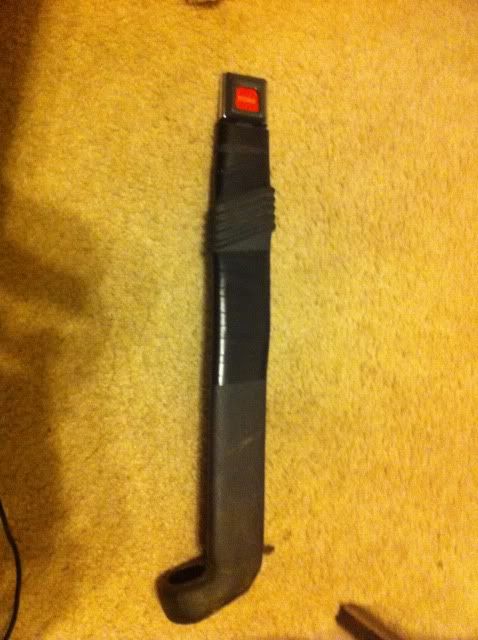

Not much of an update but I figure I'd post it. I flattened the Ford Econoline van seat belt at the end and trimmed it, drilled it, and then re-bent it to make it long enough as the stock one. I also had to split the sheath about halfway down to get it back in then I wrapped it in electrical tape to keep it together.
So for $3.48 and a little time I have a replacement buckle. It beats the $45.99 for a replacement.

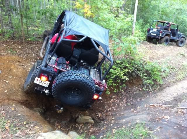

Well I went to Morris Mountain ORV in Delta, AL this weekend. It was a lot of fun but my buddy kept breaking his CJ.
Here's a few pics. Most are of my buddy. He took a couple of me and there is one video of me but I don't have it yet.
Us at the campsite.

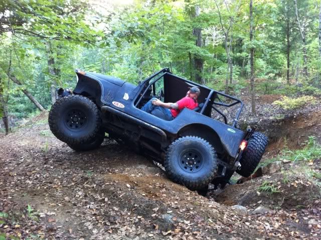

The not long after we got on the trail the first day my buddy slid down into this hole when he was trying to go around. His clutch linkage came loose so it made it interesting getting back to camp. It was also the second time that day his clutch linkage broke.

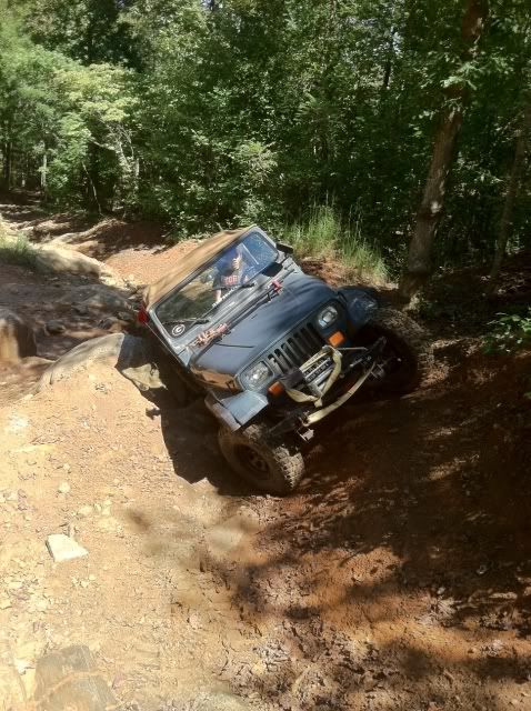

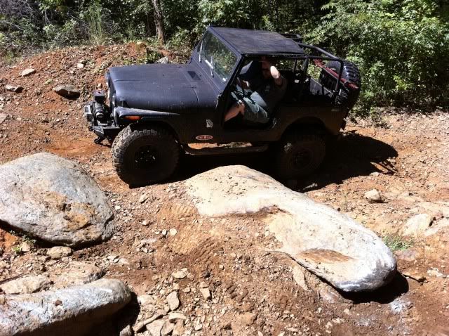

Here is me on a trail called the Gauntlet. I wasn't stuck but definitely in between a rock and a hard place...pun intended.
Then I came up to a couple of rocks. I went around after slamming into them.

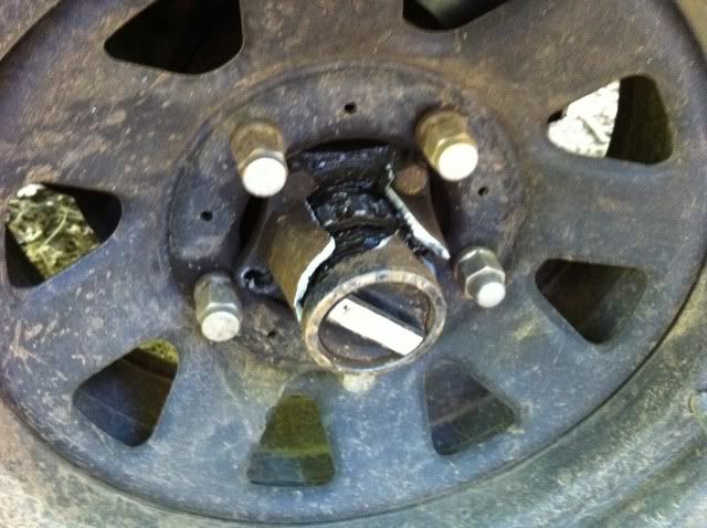

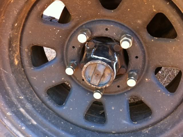

My buddy had snapped one hub the next day. Here he is about to snap the other and it blew up.
First hub.
The other hub. This was done after my buddy blew the other hub. I unlocked it and we kept riding until this happened.

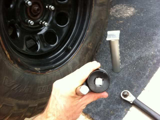

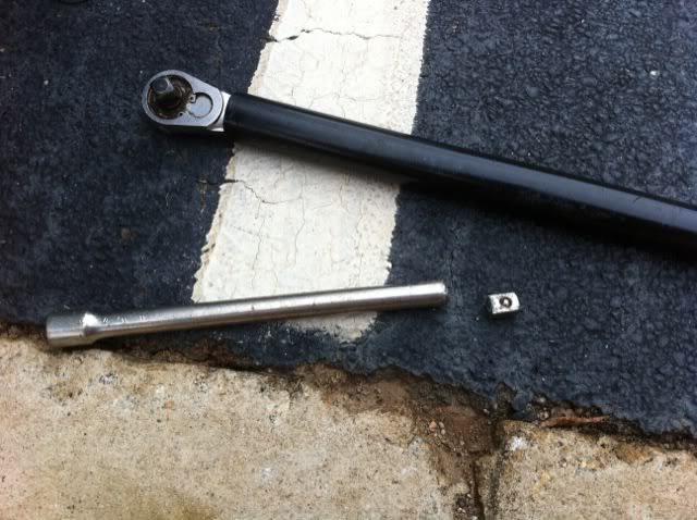

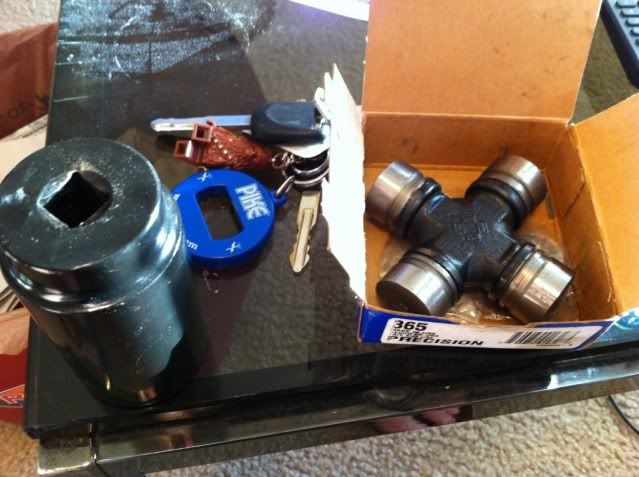

Well I got a new Precision Super Strength u-joint from O'Reillys as well as a 36MM 1/2" drive socket. After using my high-lift jack handle as a cheater bar I ran into an issue. I'll be borrowing my buddies extension and breaker bar next week. That should also allow the PB to soak in.

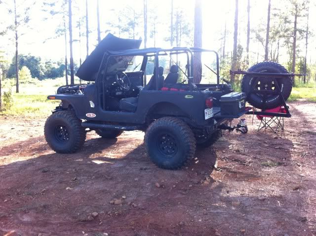

I guess I'll show what I finished up.
Here is my jeep in the apartment complex parking lot. They are lenient with me since I can get my jeep running in a couple days. This time it sat up for several days because I got sick after taking it a part.
Taken a part. Also notice where my axle is in relation to my bumpstop. My axle is pushed forward, I guess because it's sagged and flattened out. This has caused my drag link TRE at the pitman arm to hit my tie rod upon full stuff on the drivers side. I'm wondering if it would help if I reverse my springs or swap them out with the rear ones. I don't think so but I'm going to look at a Black Diamond install manual.
Here's the u-joint when I got it loose. There was one cap that was dried up but for the most part it was in OK shape.
Oh and apparently since I have ABS I have the larger u-joint like the '94 &'95 models. The first u-joint I bought was way too small. When I took it back I mentioned I have ABS and it was like lightning struck them when I said that. So I got my new larger u-joint and packed it with hi-temp wheel bearing grease.
Here's the u-joint installed. Can you tell it was worked on?

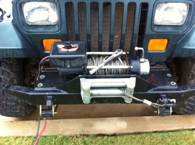

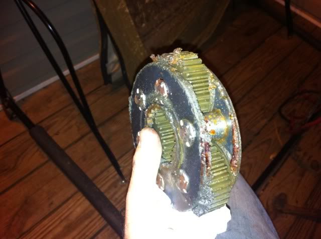

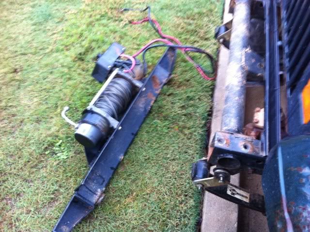

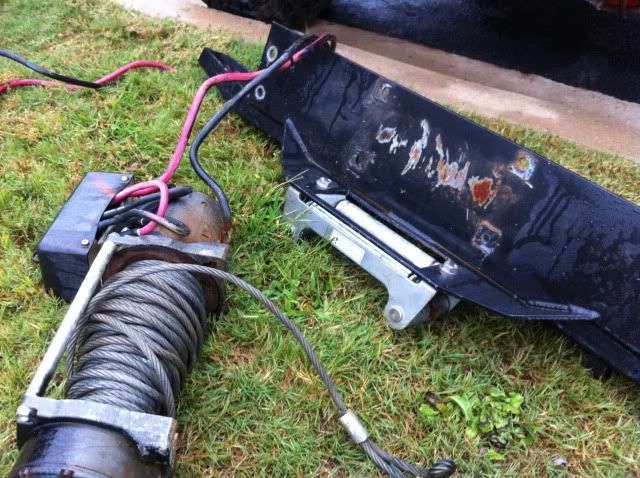

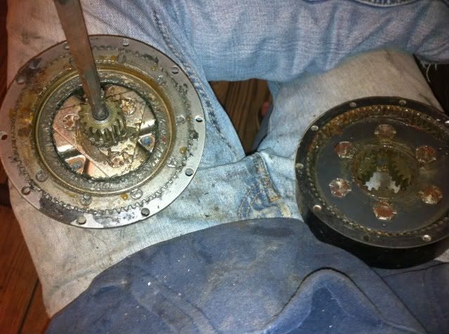

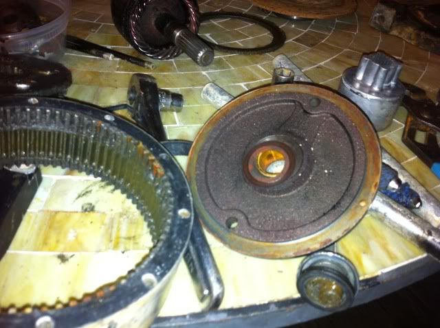

Well I need to rebuild my Warn M8000 winch. This past weekend I'm pretty sure I burned it up. It started to smoke and stopped pulling. After it cooled it worked again but I have no idea how it will go under load.

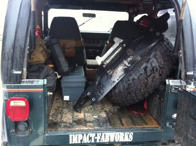

When I cracked it open it looked pretty bad. I've already ordered some replacement parts like gaskets, drum bushings, thrust washer, aluminum tie rods and a decal. I had to take the bumper off first to get to it though.
My works space:
