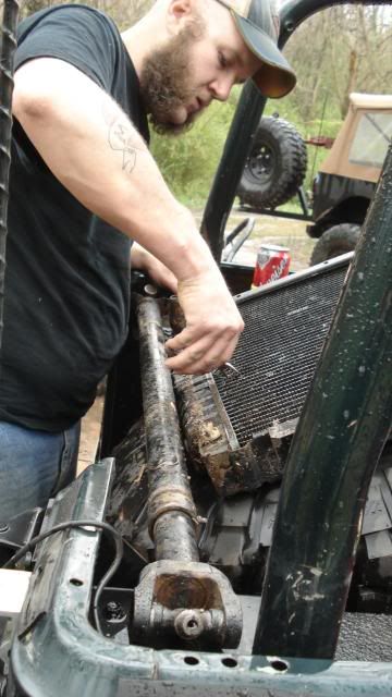

My CJ buddy just couldn't catch a break (pun intended). He was coming off these huge culverts and slammed down on the front end hard. Really hard. So hard his engine shifted forward enough for the fan to nip 7 rods in the radiator, then steam city.
So we had to get creative. Luckily another buddy had some waterproof JB weld. We ripped out the copper fins in between the clipped rods then we squeezed the rods shut and rolled them up. The lower open ones we put JB weld on. Miraculously we made it home with zero leaks.
