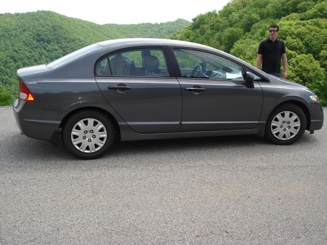

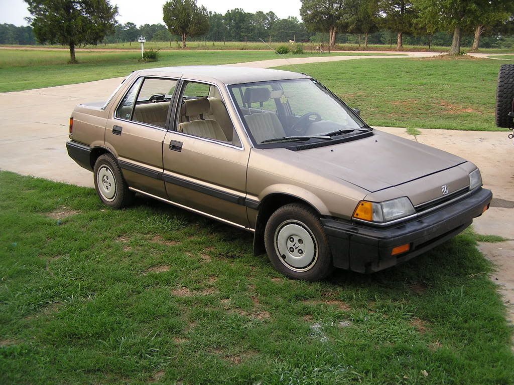

Thanks man. It was my daily driver for about 6 or 7 years. i drove it through high school and most of college. While I was in college it was starting to modify it and gas was hovering around $4/gal so I contacted one of my co-workers at a mechanic shop I worked at after high school. I got this '86 Civic from him for $200. I put about $100 into it and got it running.
It was a fun little car especially when you know it's a beater. I drove it for about two years when I finished out college and started a real job. Four months into my real job I decided to get a brand spanking new 2009 Civic because I was putting a lot of miles going to see my now fiance about 2 hours away every weekend. It started to give me more trouble than I wanted and I figured a professional job warranted a professional ride.
I like not having to worry about how I'm going to get to work now.
