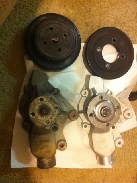

Well the weather was amazing yesterday so I went ahead and took my water pump off and put the XJ one on. I picked up the new brand new pump (not reman'ed) and stopped for the day. It got dark and I went to sell my back seat and make a few bucks for future upgrades.
Now I'm trying to figure out what the bolt size is for the XJ water pump pulley. I found a metric bolt that screws in so I just need to identify it.
Here's a pic with the old water pump.
Here's the two pumps side by side with the pulleys.

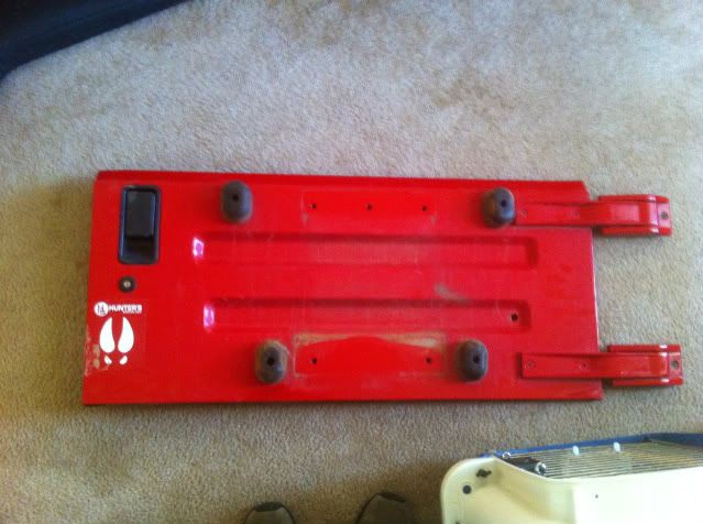

I swung by and picked up a tailgate after work today. Not bad for $50. I initially spoke with the guy and he said he had a green one that actually matched my jeep very well, exact pretty much. The only thing was it had half the tail gate hinge, the arm to be exact. Well when I was there I saw a red one also that had hinges, the late YJ and TJ style that were beefy. I asked if I could see it and it matched up perfect to the YJ tailgate so I got it.
I went to Lowe's and picked up some semi flat black paint and found M8x1.25x12MM bolts for the XJ water pump. Any recommendations on how to prep this tailgate? I was thinking a scotch brite pad or just plain sand paper. What do y'all think?

post #161 of 1666 Old 03-06-2012, 07:05 AM
jeepin82
Location: Washington CH, Ohio
Posts: 254
Scotchbrite should be fine. I would grab a can of primer to spray first then top coat with the semi flat. It should keep that paint sticking longer.

I got the XJ waterpump on and everything is working great. I took pics and was about to upload them when I accidentally deleted them. I'll have to post some pics tomorrow for the motor. I did get the hinges off the tailgate. I had to trade in my T40 Duralast torx bit at Autozone (lifetime) and I bought a bolt extractor bit to get the stripped bolts out. It took a little bit but I got them loose. Now I just need to find replacement bolts that aren't torx.
