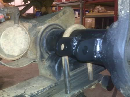

I'm sure a lot of you have had this problem with the rear shock mounts on your Dana 35. I backed into a rock and after a year of on road driving it finally gave out. I replaced them this past April with some generic ones I got from a 4WD shop I rode past. I'll post the new ones up later.
Also, this was the first break. I got my neighbor to weld the piece back on one time and it broke again another year later.
