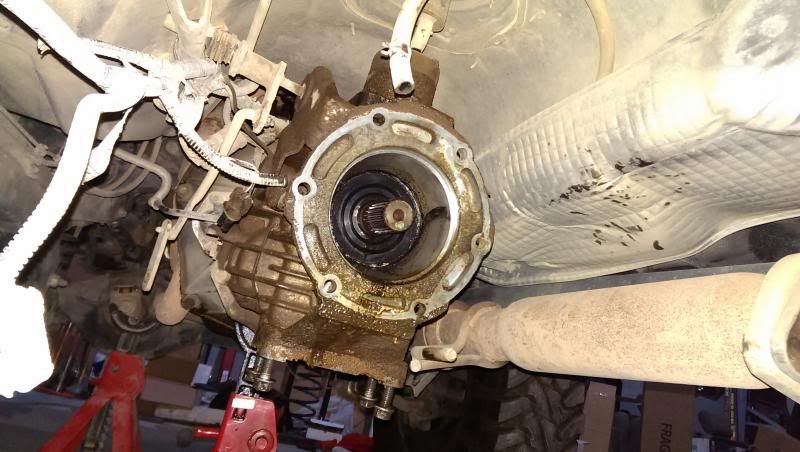

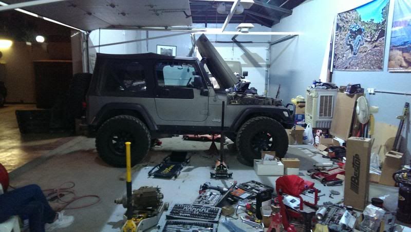

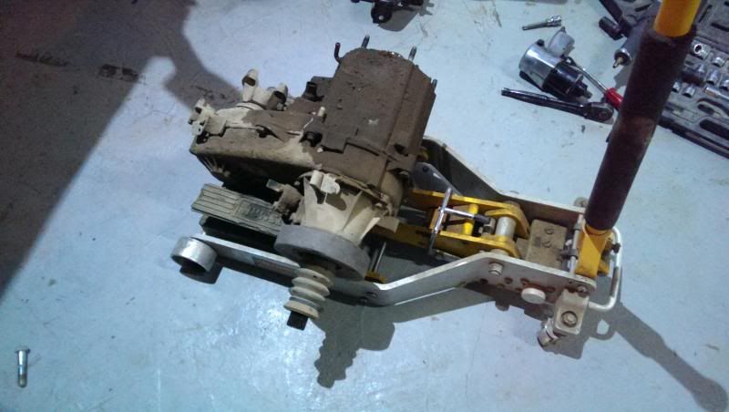

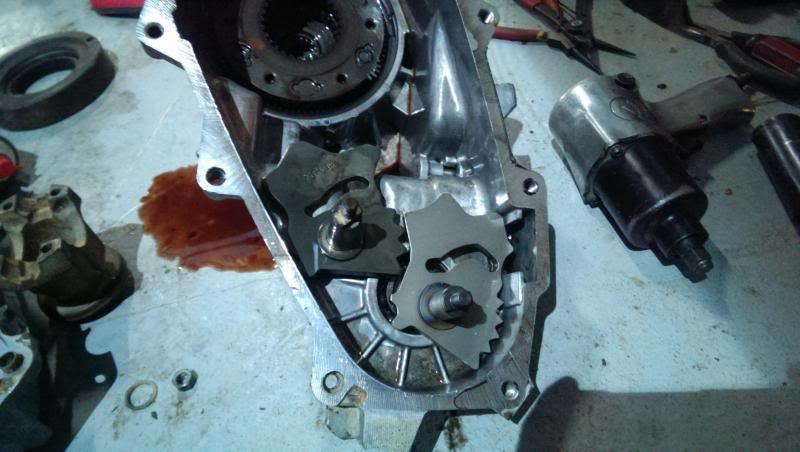

Chinook is officially under construction.
I pulled the T-case out last night.
doing SYE and Tera 2LOW.
Also pulling the Transmission out (hopefully today) for a much needed rebuild. I hope the dealership stocks parts for the TJ. they are not very popular in Saudi. at least not yet
the trans will get rebuilt at the shop.
ARBs and 4:10s will follow the T-case surgery.
The transmission rubber mount is shot and needs to be replaced.
Engine/trans/t-case all leak. New seals are in order.
Check it.

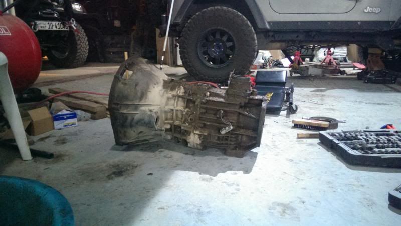

Tranni is out. the parts for NV3550 are very expensive. anyone know where I could find new tranni parts for a good deal?
finished installing the body lift/Motor lift this weekend. SYE is installed with the Tera 2LO.
The rear main seal is leaking, so it's probably a good time to replace it along with a new oil pan.
Clutch is also getting replaced
