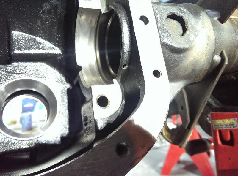

Cool. I won't be able to open the axle up until after Christmas. Wanna shoot me a PM in a few days? I don't want to ruin your build thread.

No worries, I think someone could benefit from this info, as I came back with no search results.
I kinda guessed where it needs to be and what would make sense. I gambled and here is where I drilled the holes.
passenger side
Driver side

Sorry I haven't gotten you the picture of a drain hole in a Dana 30 yet. Crush sleeve isn't needed, that's more for race cars. You can shim the pinion and torque to spec.

No worries,
check out the pics I posted. is that what you were referring to?
also, I can't shim the pinion. it doesn't have a seat for the shims. I think the factory Jeep Sleeve would probably be easier to crush. I'm hitting the dealer tomorrow to see if I can get one. I tried to crush the Yukon one, and reached 400ft/lb I stripped the nut and probably will need to fix the teeth on the pinion. So much for straight forward installation

Your picture looks like what I was talking about. What brand of gears are you putting in? Can you post a picture of the pinion? What about master install kit, brand?

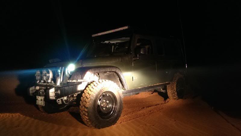

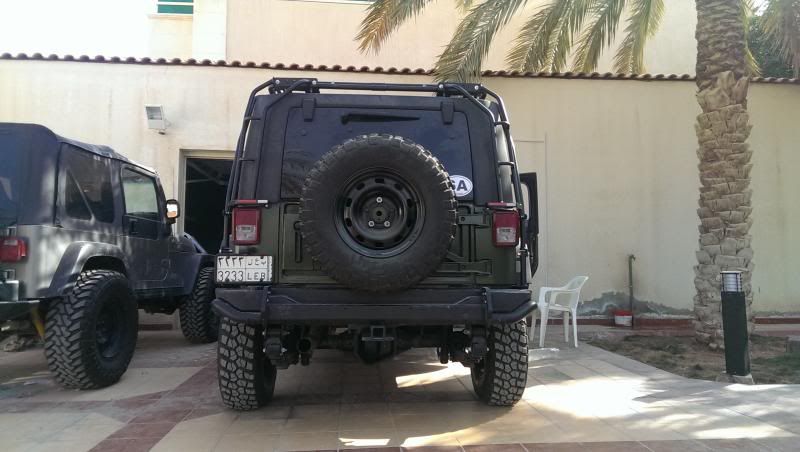

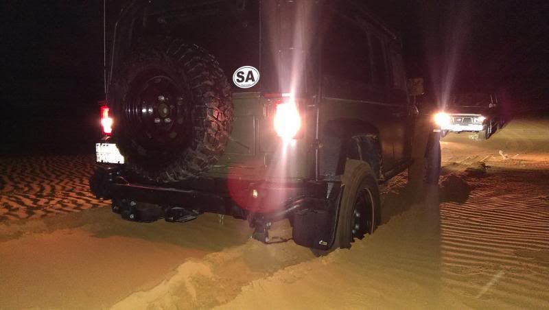

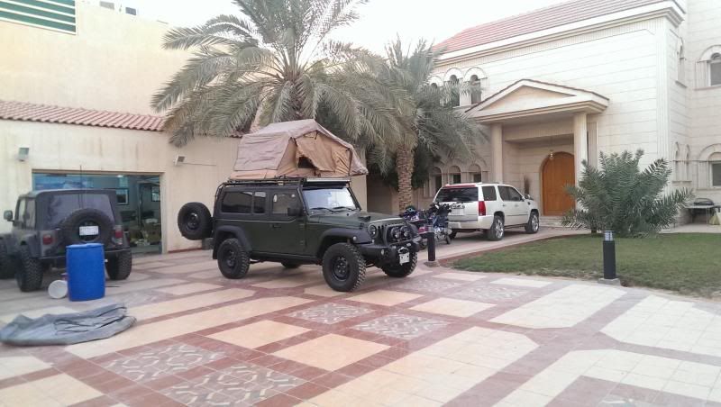

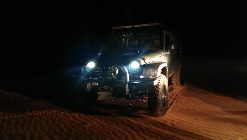

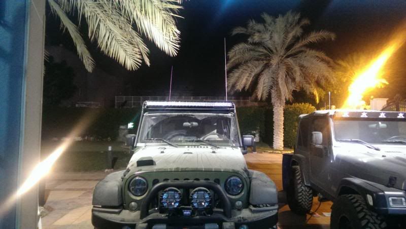

J8
The J8 has been seeing some attention.
I'm taking care of some small issues. and upgraded to the following:
Gobi stealth rack double ladder system
Rigid 50" E-combo
ARB Tent (moved from Spider LJ)
ARB awning (not installed yet)
Race radio
CB radio

Were you stuck in the sand or pushing through? I'm getting ready to buy a Gobi Rack, can't decide if I want a stealth rack or the other one.
