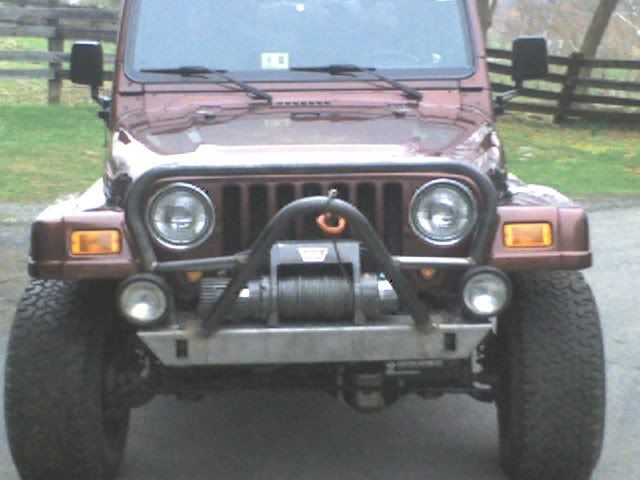

so i am ordering BTF front and rear bumpers on monday. I plan on adding my own swing tire carrier and a front hoop/stinger like i had on my old TJ
I need to sell my rear Seat and my stock bumpers, and a hitch hopefully to fund my next purchase.
This is Hoop/Stinger
